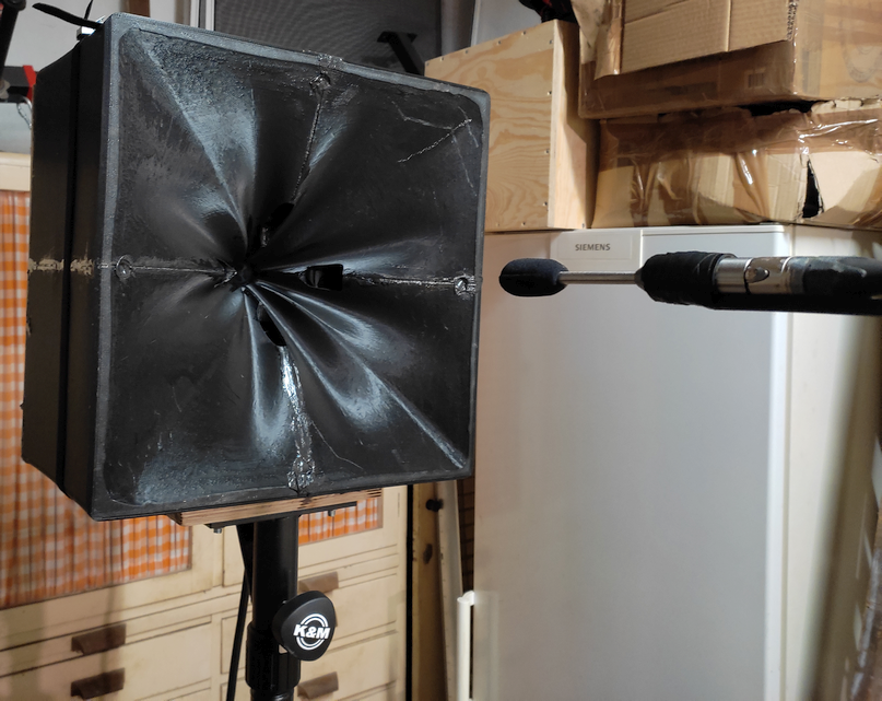

DUT is a Solana Topmod, microphone an Isemcon EMX-7150. Measurement setup is Indoor, 4pi; measurement distance 0,25m ("semi-nearfield", for decent direct to diffuse sound ratio). Lower SPL level was 110 dB @ 0,25m, higher SPL level 125 dB. To maintain an electronics noisefloor as constant as possible, I adjusted the microphone pre-amp level for the 15 dB difference between the two levels.

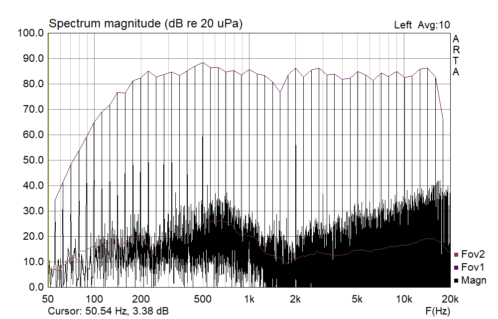

First, I performed Multitone measurements in ARTA (why ARTA - simply because that's the software I'm used to). Multitone measurements record harmonic distortion, intermodular distortion, and all other noise, just as FSAF does. Left is the lower, right the higher SPL. We can observe a problem area in the ~500-1000 Hz area, as well as the typical rising distortion of the compression driver towards higher frequencies; as expected, both are more pronounced in the higher level measurement:
View attachment 1478089 View attachment 1478090

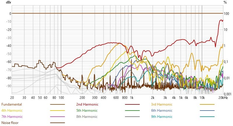

Now harmonic distortion via a sine sweep in REW; shown as relative values, and, as stated earlier, at the harmonic frequency; again left lower level, right higher level; very similar problem areas are visible, as well as a similar distortion increase in the higher SPL measurement:

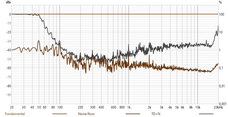

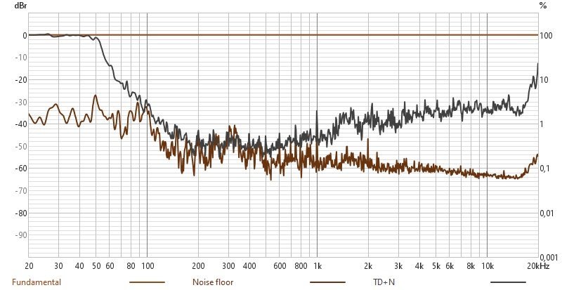

FSAF measurements:
Sweep (REW's standard sweep, recorded and imported as file); IR length standard value (500ms), timing marker used; again left lower, right higher SPL:
View attachment 1478100 View attachment 1478101

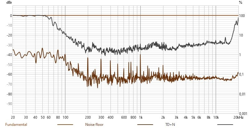

PN White; IR length standard value (500ms), timing marker used:
View attachment 1478102 View attachment 1478103
PN White; IR length standard value (500ms), timing marker not used:
View attachment 1478104 View attachment 1478105

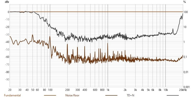

PN White; IR length minimum value (100ms), timing marker not used:
View attachment 1478106 View attachment 1478107

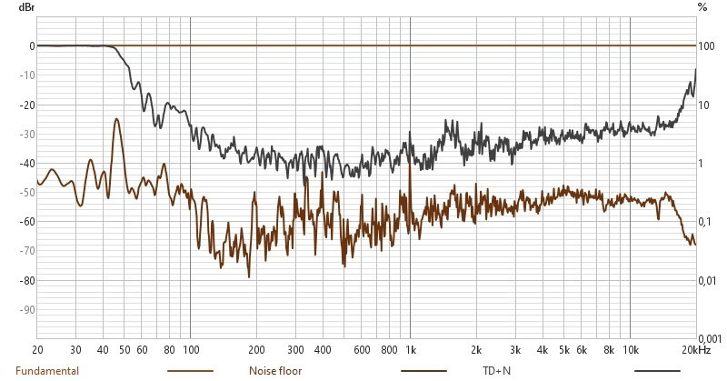

Music (20 seconds of the main part of MGMT - Little Dark Age); IR length standard value (500ms), timing marker used:
View attachment 1478110 View attachment 1478111

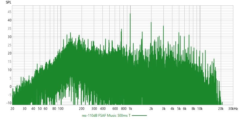

.. and the spectrum of the residuals:
View attachment 1478124 View attachment 1478125

Good news: all FSAF measurements with all settings and signals record increased distortion from the low to the high SPL measurement. Also, FSAF with a sweep reproduces the distortion characteristic (distribution over frequency) of the control measurements pretty well, especially in the higher SPL measurement.
Maybe not so good news: between the types of signals, and settings, correletation tends to be poor. Especially the PN measurements with short IR show almost nonsensical results - barely any difference in distortion over frequency. And interestingly, while the PN measurements at the lower SPL show somewhat meaningful distortion distribution, the higher SPL PN measurements again show a nonsensical almost flat line.
Now, partially that's due to different frequency spectrum distribution, maybe also crest factor, of the signal - but to a large extent, as I said, the results are nonsensical.
I emphasize again that the pre-amp gain was adjusted for the difference between the low and high SPL measurement, so there wasn't any clipping or similar that could explain that behavior; frequency response results also matched on the high and low SPL measurement for every run. I'll also add that this behavior was 100% reproducible, as, when anything is even slightly suspect, I re-run the measurement to make sure everything is in order.
As for the residuals of the measurement with music, I'm also including them as .wav in the attachments. Some of what is measured & heard is naturally the remaining room reflections. Other than that, I don't quite know what to make of what I hear - multitone as well as harmonic distortion should sound diffuse and bright, but what I hear in the residual is what seems like the original music track, with a little clipping and echo put on it. So, again, a result that doesn't inspire me with high confidence.
There's some fluctuations in there as well that seem like timing issues, though I'm using a single interface, which I previously checked for time shift, which it doesn't seem to suffer from.. which is again weird.
So, all in all, for me, FSAF is still looking like a potentially valuable tool - but one that might need yet a bit more work & standardization put into it until we can confidently put it to use.
I'm not exactly sure of the comparison that's being attempted here. I'd argue that your results show rather good correlation when comparison is actually equal, such as sine sweep to sine sweep. PN is a very different stimulus, its nonsensical to try and compare it's result to a sine seep. You also show that too short of a window is problematic, which should be fairly obvious. What is great about FSAF is that it captures time domain issues that are more often than not completely missed in frequency domain tests such as basic HD or even a multitione test, and you can hear it for yourself as well as analyze it in the time domain. Hear that "snap, crackle, pop" during playback? It's not a constant signal mode that's captured easily in a constant tone test, and it's broad spectrum so it affects the overall spectral content of the residual significantly. The reality is that when FSAF shows you some thing more than what you see in single tone or multitone tests, that more is going on in the measured audio that is not being captured in the other tests, whether it's background noise, room reverb, resonance, or some time domain specific occurrence like barkenhousen noise. Downside of FSAF is that it's very susceptible to background noise of any sort, so you have to treat the measurement conditions for this test like a studio recording environment.
From the residual audio you've provided, I would suggest that room reverb is likely the dominating factor. For detailed troubleshooting of the recording, measure with "save residual, mic input, and excitation" selected, so all 3 files can be compared, original audio, what the mic recorded, and residual audio.
Viewing the un-smoothed residual spectrum is nonsensical, you can just view the fundamental on the distortion tab, with SPL or dBFS units selected to show it properly. But, since it appears you've found the "Load FSAF residual" button, next step is to make your way to the spectrogram tab for detailed analysis. IMO the overall FSAF residual chart that REW shows in the distortion tab is a bit over-simplistic view of what's going on. A lot happens in 10-15s of audio that is not easily summed up in a single spectrum chart.
FWIW REW is also very powerful for multitone tests. Use the generator and RTA for this. Set up the multitone stimulus in the generator, and record with the RTA with "show distortion" selected. When you save the measurement, view in the distortion tab to see the residual with the fundamental tones removed.
Obviously.
What's been learned is that FSAF in REW recorded increased distortion across the board, with all types of signal and settings, in the higher SPL measurements - which is what was expected, and verifies at least the most basic functionality.
However, FSAF with PN accurately reproducing part of the DUT's pre-established distortion characteristic (high frequency region - observe closely) in the lower SPL run, while showing basically a flat line in the higher SPL run, is still extremely suspect. Room influence doesn't change with SPL, and there are no other environmental factors, or of the speaker, which would explain such a behavior.
Burden of proof is still on the party making a claim, so I never have to prove something doesn't work, when it hasn't been demonstrated to work in the first place. Not that I'd want to though, actually - as I've said, I'd love for FSAF to work reliably and easily.
As for IR length, I cite the REW documentation: "Choosing a length that is much longer than the time it takes the IR to decay into the noise floor may result in a processing error due to numerical ill-conditioning." At the minimum value of IR length, 100ms, that's already right around where that happens. So I do not at all agree that that's "obviously" too short a window.
I'll agree that the remainder of the room influence, as low as it'll be in a semi-NF measurement, might still be negatively influencing the results. I decided to, whenever I do free field measurements again, throw in another FSAF comparison - @tktran303 can confirm, I sent him a PM to that regard even before my first post ITT.

I've performed multitone measurements in REW before, out of curiosity, to compare the results to ARTA. Works fine - correlation is high. REW also offers even greater functionality / features. I am well aware of it, and I still chose ARTA for the comparison measurement, because, like I said, routine.

the two residual files you posted labelled 110dB and 125dB are identical
I added 25 dB gain for both SPLs / files (just before clipping for the louder one), and cut off the silence in the beginning, to make the samples easier to listen to. Something must have gone wrong in Audacity. The two files in the .rar in post #196 are indeed identical. Attached is an updated .rar with the correct(ed) files:

FSAF music stimulus residual:
I don't know...it looks fairly "well correlated" to me. The lack of change in distortion amplitude in the top end with music signal is likely because simply of lacking acoustic energy, compared to what appears to be a white spectrum stimulus used for IMD. You really need to avoid viewing FSAF residual as relative to fundamental dBr scale, view absolute amplitude and perhaps it will be clearer. Or don't listen to me, whatever you choose, I've got nothing to gain or to prove from this, just trying to get DIYers excited about this type of evaluation and what can be learned from it. Maybe it's nothing, we learned all we needed to know a decade ago.
For noise comparison to music spectrum, I'd recommend using M-Noise instead of pink noise.
