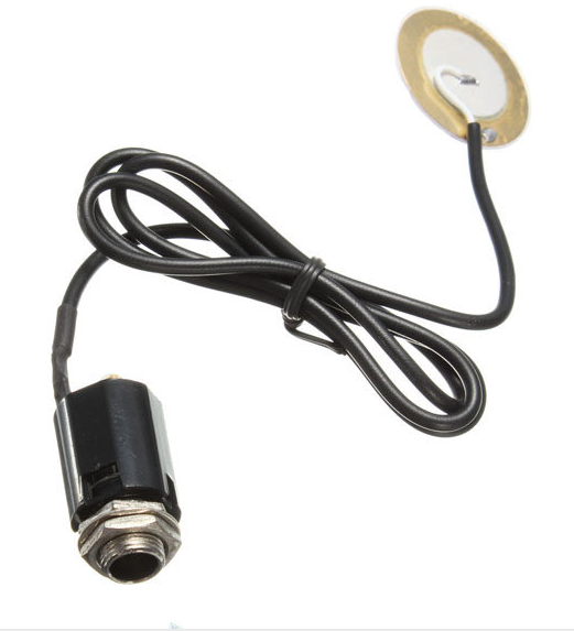

I use a cheap (around 10-15 Euro) violin bridge piezo pickup. It is quite insensitive to airborn vibrations compared to the contact induced vibrations, so speaker radiation is not really an issue.
I connect the pickup to one channel of an oscilloscope for observing the panel vibrations at different panel wall positions, while on the other channel I connect a link to the loudspeaker excitation signal.
If I want to make a recording, I use the pickup channel and the Y-Out of the oscilloscope to feed one channel of a soundcard . The other channel of the soundcard is connected to the excitation signal
For fast comparative observations a stethoscope is a great tool
If only we had a small transducer, sensitive in the audio range, which would contribute minimal mass to the DUT... like a phono cartridge! I think Siegfried Linkwitz did that to measure panel resonance in box speakers, there is an article out there somewhere.
Measuring the vibrations of panels is easy enough, but that doesn't tell us what is actually radiated. A small vibration of the right form could radiate more than a large vibration of a non-radiating form. It's just not a 1:1 situation, making the vibration measurements hard to interpret.
Construction of a loudspeaker enclosure is never that critical as an unexperienced DIYer might believe it to be. A straight forward solution is the one from Harwood paper on panel resonances along with Dr.Geddes' recipe for cld method and bracing.
Right nezbleu. Violin bridges are very light structures. The bridge pickups are small and light devices.
One can also use a thin naked piezo disk.
In every case the sensor cable has to be thin , light, very flexible.
