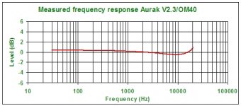

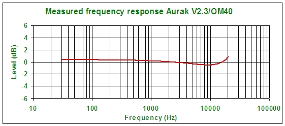

Let me dig out the measurement of an OM40 with transimpedance loading (150Ohms). Not much resonance there. We have some threads discussing this in particular so as to not throw this one too far off track.

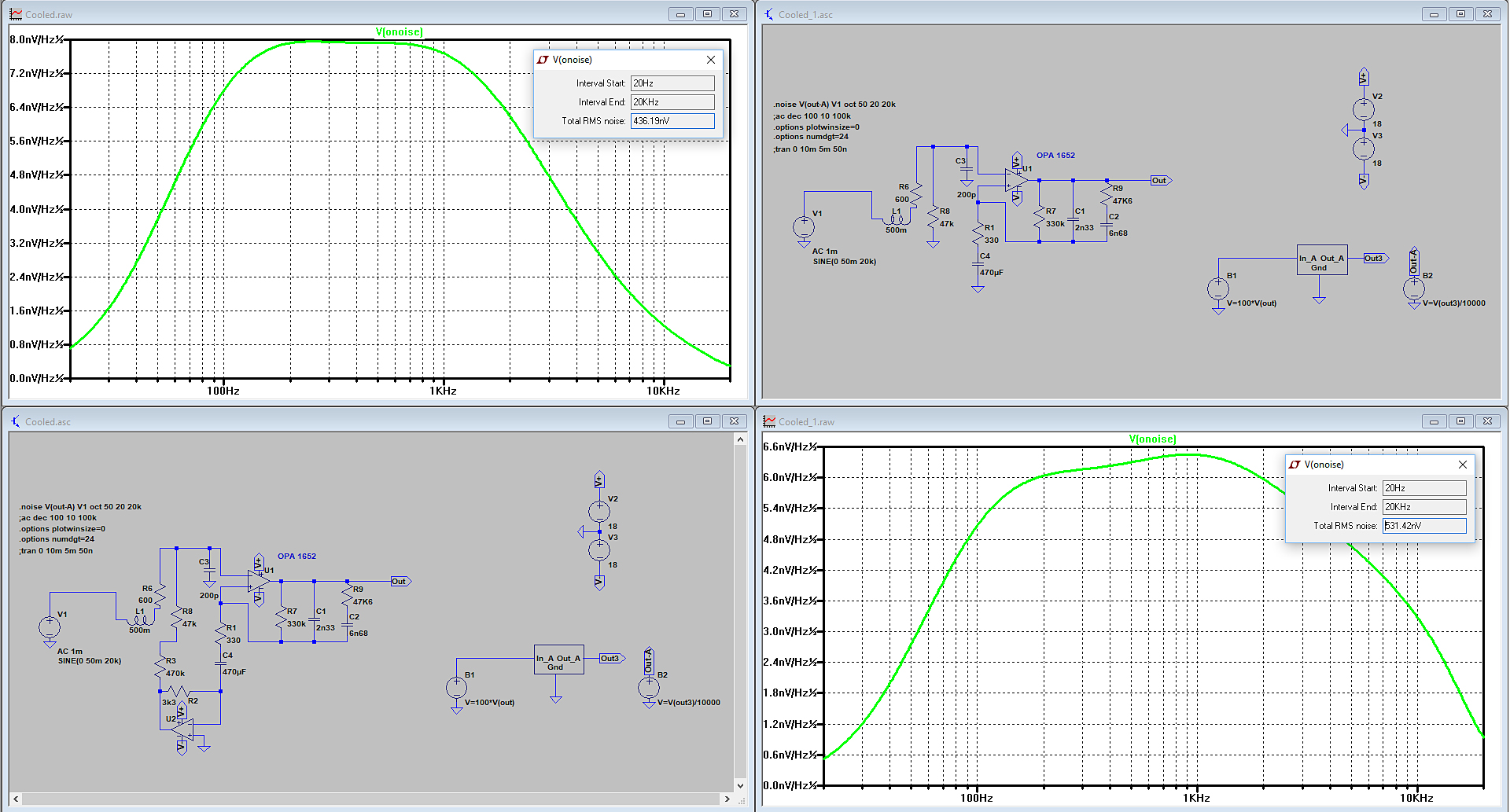

Here is an example of two versions build with the OPA1652, a state of the art Fet OPA in combo with a 500 mH / 600 Ohm cart,
One is with "Cooled Resistor", the other one isn't.
Difference in S/N between the two: 20*log(436/531) = 1.7 dBA.
(The same done with the OPA1642 gives 20*log(472/549) = 1.3 dBA).
S/N with OPA1655 referred to 5mV@1Khz is 79,4dBA and with"cooling" 81,2dBA, including the Cart !
Technically most interesting, but practically beyond what is needed IMHO.
Hans
For the 47 kohm case, you could improve it a bit further by either using an ultra low noise op-amp for the inverting amplifier, or completely separating the cold resistor circuit from the RIAA amplifier using three FET op-amps. That saves you the 4.5 nV/sqrt(Hz) voltage noise penalty that the bottom op-amp gives you.
On the other hand, the implicit assumption that the ESR of a moving-magnet cartridge is constant is incorrect, it increases substantially across the audio band (or at least it did on the cartridge that a friend of mine measured in the 1990's). That increases the cartridge's thermal noise and reduces the possible improvement. I once calculated a best-case improvement of about 3 dB(A) for an otherwise noiseless RIAA amplifier connected to the cartridge that that friend of mine measured, all assuming only thermal noise and no record surface noise.
In any case, an improvement of 1.7 dB(A) or 3 dB(A) or whatever it may be may well be audible when you don't play a record and turn the volume up high, so its practical significance is much greater than that of reducing the distortion of an audio power amplifier from 0.01 % to 0.0001 %.
If you would take an ultra low noise version for the inverting amp, you could just as well take a main amp that has lower noise than the OPA1652 having 3.8nV/rtHz.
So I still don't see the advantage of using this "cool"circuit and I also fail to see a reason for having a Riaa amp with a S/N of 80dBA or more.
There is just another more simple reason against using it.
The dBA figures are giving the impression that the noise is lowered.
As a sum over the whole spectrum this is true, but the spectra have different shapes with more noise in the mid sector when displayed on a 1/3 octave base and less above 10KHz for the cooled version.
When using ITUR weighting, more reflecting to what you hear, the differences become much smaller.
