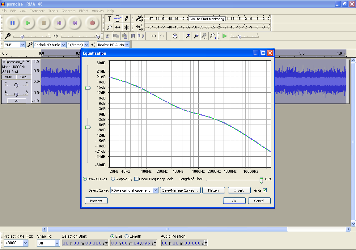

Hi George,
How did you produce your smooth Riaa corrected curve from Scott's IRiaa curve.
Hi Hans
OK we both cheated a bit (no hardware use, only software) but it’s only for demonstration.
You LTSpice, me Audacity
But I have a problem in understanding RMAA, because when taking a 32K FFT from Scott's file,
It’s not an issue with RMAA.
As Scott has explained in his LA Vol. 10 article, these 3 sec long files are optimised for 64k & 96k FFT and no window function.
If you run them with some window function other than the rectangular, the FFT envelope looks equally noisy regardless of FFT length used.
George
>Edit I see Scott answered this

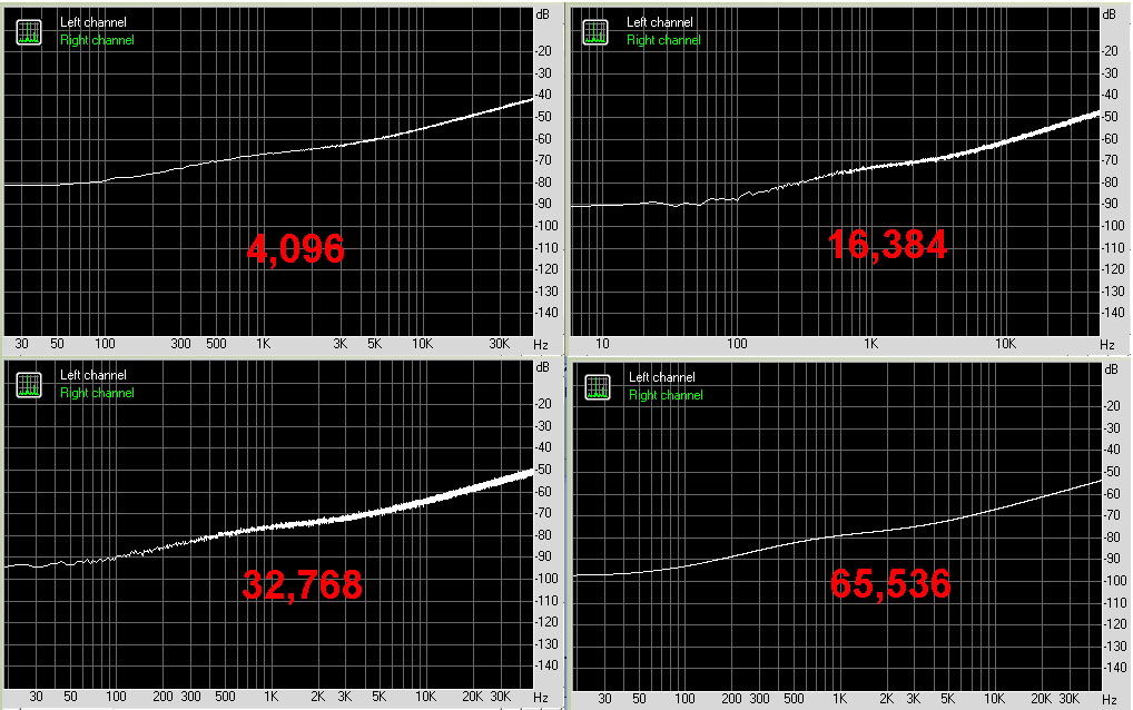

Hi Scott,
IMHO this is not how RMAA is supposed to work.
The program takes a time window of X samples all at the original sampling rate of the file offered, where X can be anything between 2^7 and 2^18 and produces a X bin FFT.
So there is no decimation causing aliasing involved.
After the first FFT has been calculated, the time window shifts 50, 25, 12.5 or 6.25% of X and takes the next X samples to calculate a new X bin FFT and so on and so on until all time samples have been used.
Then follows averaging off all calculated FFT's, resulting again in a smoothened X bin FFT.
So when offering a 96Khz file, no matter what X is, at the end the FFT always shows a bandwidth of 48Khz, proving that no decimation and aliasing has taken place.
With X = 65,536, resolution is 1,5 Hz and with X=4096 resolution is 23 Hz. That's the difference it makes when choosing X, but the FFT bandwidth stays always 48 Khz in case of a 96 Khz file.
So when going from 65K to 32K, there is no logic why suddenly the spectrum is less smooth where the filter bandwidth has doubled from 1,5 Hz to 3 Hz.
In the Image below I have processed your IRiaa 96Khz file with different values for X, all FFT's calculated without a shaping window and with an overlap of 50%.
As you can see all FFT's are showing a bandwidth of 48 Khz, so no decimation has taken place.
from X is 32K to 4K you see the noise in the image diminishing as expected, because the filter bin becomes wider, but for X is 65K that should show the highest noise, spectrum is suddenly noiseless.
So I can only repeat that I think that in this case the 65K FFT is not reliable and has most likely to do with a bug in RMAA, unless you have a better explanation.
Hans

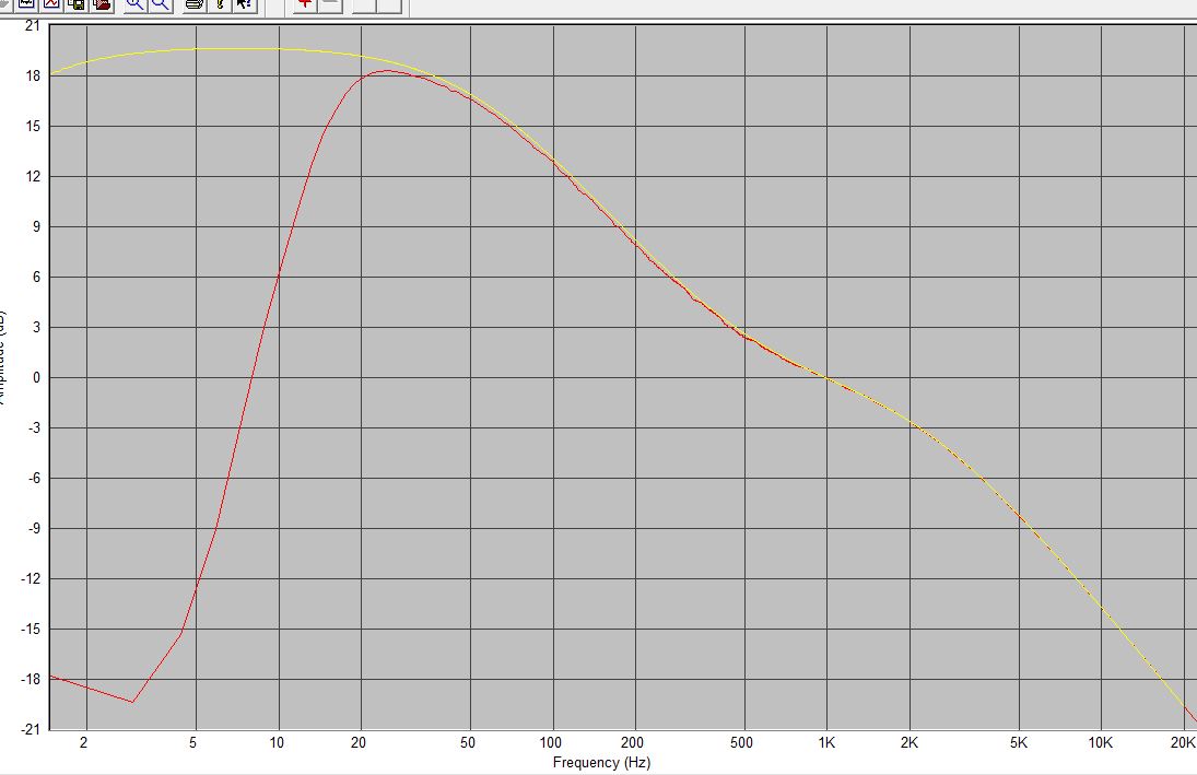

providing you can get suitable software for Linux, setup/calibrate it, then its relatively easy to measure the response of an electrical circuit.
attached is the response of an riaa cct after I added warp filtering, taken with speakerworkshop. (yellow trace is the reference)

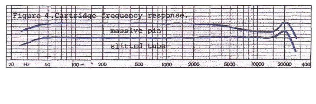

In terms of the magnitudes we could be talking about take a look at the attached which is from the ortofon marketing bumph for the 500 series which were the first split pin generators. X-referencing with other marketing stuff suggests 1dB per division so the solid pin, with optimal loading gives a 3dB dip in the HF region, which they put down to eddy currents. Very few attempts have been made to find an electrical model that matches that response to then look into deeper issues such as level variance. Combined with the fact that test records don't generally have calibrated variable level sweeps these days and you can see why this slipped until the radar. Also doesn't help that journalists don't seem to believe that MM can give the same performance as MC.
For me it's interesting things to investigate even if the end result is a list of the most technically excellent MMs out there and how to interface with them without actually solving all the issues. All good harmless fun.

@Jaddie. I note from your post history that you requested an 02 board 7 years ago then came back recently with a fairly agressive attitude. Chill out, we are all friends here.
Sorry. Unsubstantiated myth is my hot button.
There is not enough information about that graph to conclude anything. Assumption about vertical scale...well, it's probably ok but who knows? Test conditions are undefined, and it seems to indicate a significant change in the cart for each of the traces. Not enough info.
I'm not on board with the "harmless" part if mythology is perpetuated. If it's fact, I'll be 100% behind it.
