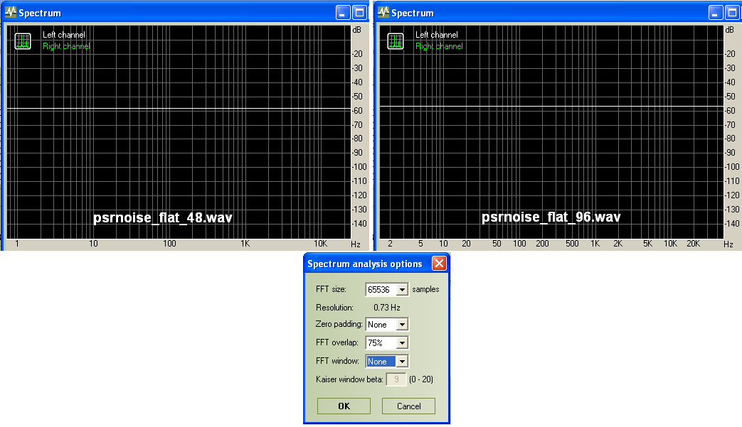

Scott’s files are to be analysed using no window (i.e. rectangular window) function.
In Audacity, for some unknown reason, the spectrum shows flat only in Linear frequency . With log frequency there is heavy unevenness at low frequency.
You may use any free version of RMAA to do decent FFT plots

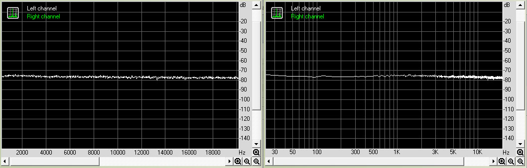

It is incorrect that white noise has most energy concentrated in the upper half of the spectrum.
That may seem to be when displaying the spectrum on a log scale.
However when switching to a linear scale, you can see that noise is evenly distributed all over the spectrum.
See images below lin and log from 20Hz to 20 Khz made with a Scott anti Riaa .wav file played through a Riaa filter.
It fully confirms without confusion that the noise used was white and that the anti riaa correction was well done.
Hans
