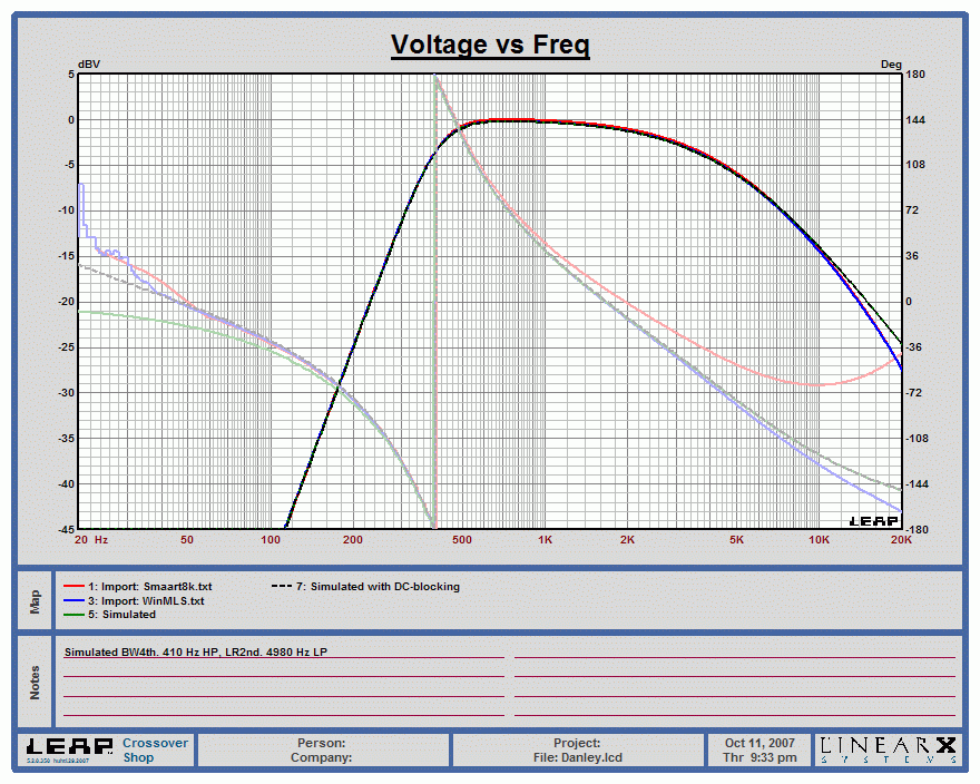

CLG, thanks for taking the time to make some comparative measurements. Looks like something funny is going on with the Smaat Live measurement.

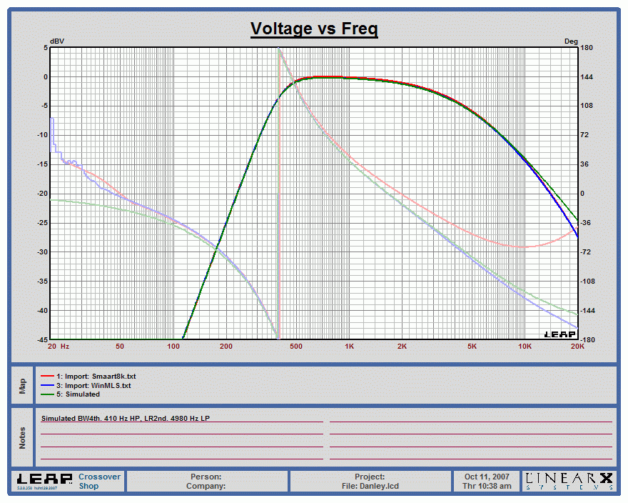

Iain,
Yes Smaart did something weird in HF.
Well, I mainly use WinMLS2004 anyways, so it deosn´t bother me too much.
Smaart is (for me) for comparative stuff like, say, power compression...

Tom Danley said:Hi CGL, Iain
Note both win-mls and Smart had nearly an identical phase error at the low end but had differing errors above. I have seen systems, which had amplitude errors as well.
That is EXACTLY why I pointed out the DC blocking. Both Smaart and WinMLS measures the phase correctly, my simulation doesn´t include the hipass as I dont really know where it is at.
I´m trying to attach a sim with a 1 st. order "DC-Blocking" at 15 Hz. I could measure it for real tomorrow.
Oh, by the way, the WinMLS sweep is a single ~1s. long sweep with the level after the DSP at about -90 dBV at 30 Hz. The level it self could cause some deviation...

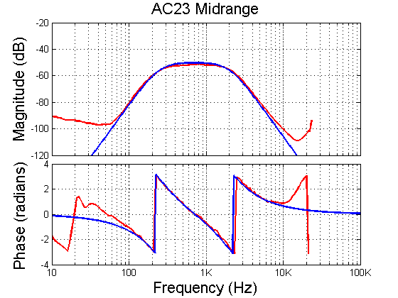

Dear Tom,
I have progressed with my project:
http://people.qualcomm.com/kalousek/index.htm
to a point of cross-over attempts, initially with Behringer. (I still have some issues with the mid-frequency drivers response not measuring the same as the one of the "real" Unity, but I have done some simulation, and believe that I know how to correct it.)
Could you amplify about the "funny stuff", namely, how it manifests itself in measurements?

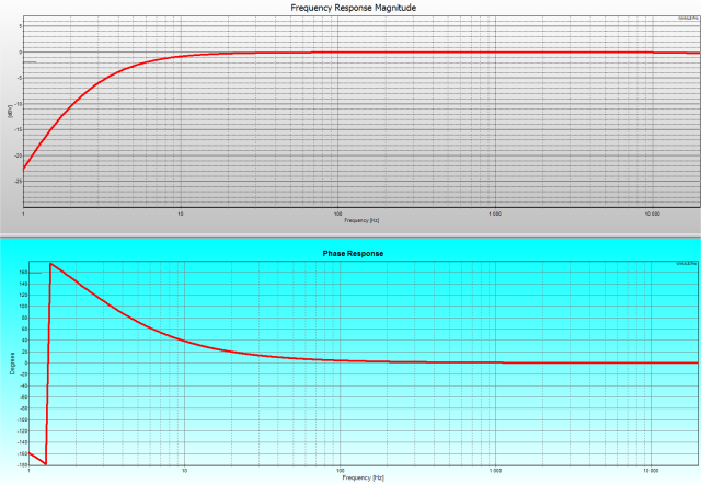

I promised some measurements.
It´s the DSP (latency removed).
The measurement system itself isn´t really interesting, two flat lines...
Notes:
1). The resolution is only 0.4 Hz as the sweep time was 2.5 s.
2). I was wrong, the hipass is an 2nd. order function at ~3.8 Hz with
a Q of ~0.62. Apologies for that.
3). There seems to be some 20 deg of phase shift at 20 Hz....

If you are so concerned about low frequency phase shifts, you will be interested in seeing some differences between air core inductors and iron cored inductors.-CGL- said:I promised some measurements.
Notes:
I´m not concerned about the phase shift, I measured it for Tom as he said there was errors in the previous graphs....
