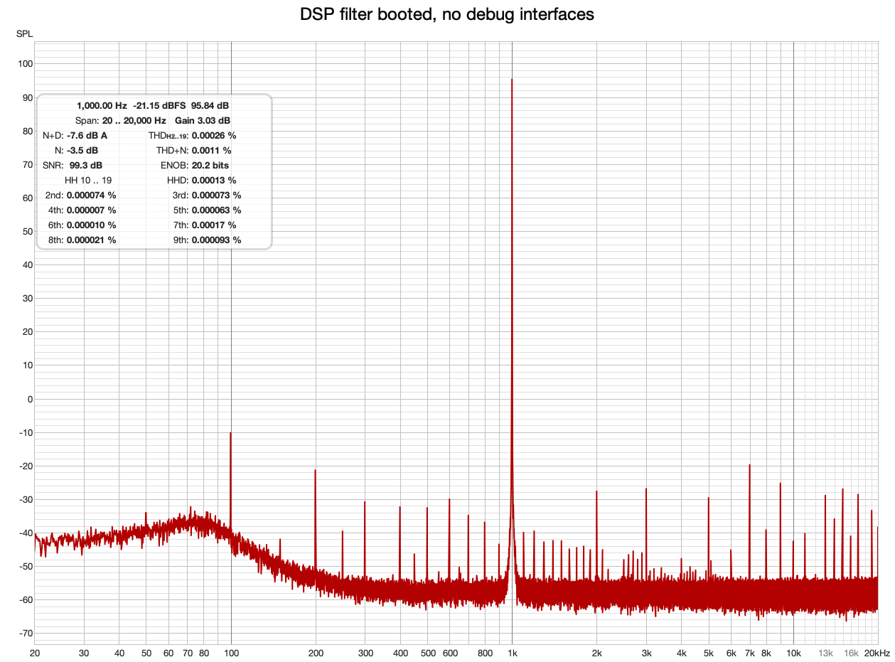

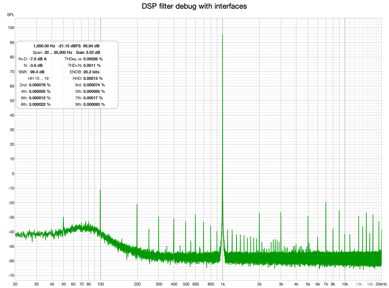

Some results here captured with REW RTA and Cosmos ADC.
I can se very little or no difference between the standalone booted DSP without interfaces connected, and the development setup.
As I am a measurement and analysis newbie, I have to ask if this result is good/satisfactory/poor?
The level was -6dB input to be safe from clipping, 400mVRMS out, Cosmos ADC input range 4.5V.
The DSP filter driver EQ was active, with a PK/notch -6dB at 1kHz to compensate for a combined baffle diffraction and cone resonance peak.
Hence the low output level.
The noise floor is probably due to the filter design, I am not so worried about it.
I entered the Cosmos ADC full scale, 4.5V and 400mVRMS is -21dB in this context.
Do you mean dBFS in the context of the DAC maximum output (2VRMS) level would be better?

I am looking for any kind of difference between the two working modes, DSP booted or DSP debug mode, which was the reason I opened this thread.
Since I can see none, I instead want to ask the experts if my system is performing good or bad in the general sense.
There may be a difference between a good measurement and a well performing DUT.
I will continue to compare the operating modes using an older DSP software framework, where we could hear a difference.
With the present version I am not so sure.
Since the present situation seems to be adequate, the original question is more of an academic one, why did we hear a difference-
We are just curious.
The normal convention is that you set 0 dB at clip / max and then you can see your distortion as "dB down" more directly without having to do any calculation 😉
The two measurements look very similar but not identical... but can we really hear that low level differences... well...
