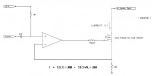

A decent dynamic supply impedance monitor could be made pretty simply. Attached is schematic. Monitor supply with scope to see how much it dips under transients created by signal generator.
