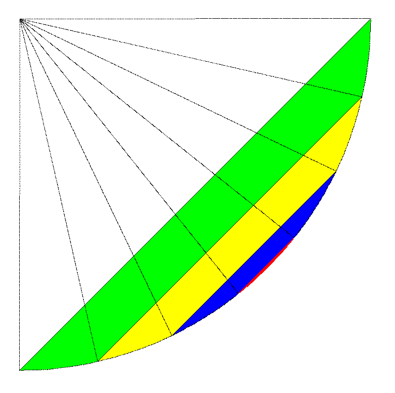

Measuring Omnidirectional Loudspeakers
A set of horizontals is not a complete set of measurements unless the speaker is axissymetrical, where you weight like this.
a speaker driver is axis symmetrical, whether pointed forward or at the ceiling. .
Besides, a 360 degree radial ought to be weighted evenly around vertical axis (horizontal measurements), and multiple such horizontal measurements are pointless unless they are a part of a complete power set.
Measurement axis is relative to the driver axis, not listening axis. Is the driver round or rectangular? Then 2 axis is enough. Speaker is rotated vertically in the crossover design section post-measurement. As for weighting, I disagree. Weighting of CTA-2034 is appropriate for speakers in a room, regardless of radiation pattern.
In any case, if you disagree with CTA-2034, within the calculator tool in VituixCAD you can take any number of measurements and average them with the weighting of your choosing.

I’m building a very simple omnidirectional speaker with a bass/mid firing upwards and tweeter firing forwards. Its now time to take some measurements in order to model a crossover, but I can’t decide how best to achieve this. I can measure in the garden, either well away from surfaces or up against a wall to introduce 2 reflective surfaces, or in a room to include all surfaces. But, because of the omnidirectional nature of the sound waves, I can’t decide how best to capture them. How do people normally approach measuring omnidirectional loudspeakers?

For off-axis measurements, the best way is to set the speaker on a stand that sits on a turntable made of two plates bolted together. Plates must be so big that the driver (radiating plane) is at centerpoint. Cut the upper plate hemispheric and make markings of degrees. Then the mic just stands still, and reflections from floor and room are standard. No need to make it automatic. But be careful to not to make a lip just below the speaker (it makes awful diffractions)
Ground planemeasurement for bass reflex tuning, high stand and gated measurement for mid-tweeter xo. RTA or MMM for final voicing (that's what Carlson was doing at home, but he lacked modern understanding of radiation patterns)

In any case, keeping constant mic distance for measuring speaker for design is crucial. Most people will keep the mic stationary and rotate the speaker, depending on the speaker I understand that could present challenges of its own. Moving mic within the room will be difficult to impossible to address the room reflections as a moving target. I'd suggest reading through measurement guides for VituixCAD, found in the help here, there's a lot of good information in there:
Have you tried this? What if you want to work into something other than free space. Something where the standard Vituixcad measurement method doesn't work?
This method is geared toward ranking conventional existing speakers. When designing speakers we can talk about the limitations.
The standard is for providing the performance of a speaker in a room in a common format. "conventional" or not does not matter.
I used it for different reasons than this topic. Use the calculator tool, load whatever set of response data you like. Select "average of A responses". To apply weighting, use the scale dB for each response. The complexity in this process is that the sum of scale dB values should be equal to the number of loaded responses in order to get the correct SPL scaling of the result.
For example, for 4 responses with scaling dB values of +6, 0, -6, -6, weighting is 2,1,0.5,0.5 = 4.
