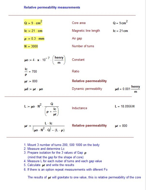

I have a small M42 transformer with mumetal lamination. The core area is 1.8 x 10-4 m2, magnetic path length is 0.1 m. I measured the inductance with 400 turns, it is 10.13 H. From these data I calculated the ur relative permeability = 28500. Or Al = L/n2 = 64375 [nH]. But this is a special iron, it can not handle high flux. I will use it for low signal level, no power.
Yes. Permeability is the slope, and varies everywhere on the curve. Note that this is a "static" curve, made as if hysteresis were zero, and could be imagined as being drawn with varying DC conditions with a very small AC component whose slope is measured.I meant how to derive permeability from any point on B-H cure, ie. should I use tangent on the curve at operating point,

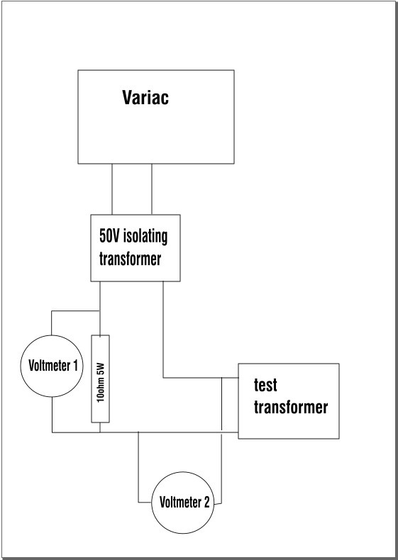

Have you to tried to plot a saturation curve for your 'unknown' laminations and compare it with a saturation curve for 'known' laminations ? it won't give you permeability figures but will give you a comparison against a core made from iron that is known to be ordinary power transformer iron - if your unknown core has the same saturation curve as the ordinary iron then it is a fair bet that the unknown core is also ordinary iron.
Assemble your 'known' core and wind around 100-150 turns - scrap wire that has been pulled from a junked transformer is ok for this, make it at least 0.5mm thick - setup the circuit in the pic - start at 0V and increase the voltage across the test transformer in 1V steps - at each step note the voltage across the test transformer and the corresponding voltage across the 10 ohm resistor - by measuring the voltage across the resistor, you are measuring the current through it - the voltage across the 10 ohm resistor will remain reasonably low and constant until you start to reach core saturation where it will start to rise - at this point you may want to reduce the step voltage increase to 0.5V or less - once the core is fully saturated the voltage across the 10 ohm resistor will increase in proportion to the voltage across the test transformer - the 10 ohm resistor can get quite hot - only leave power connected long enough to note the voltage readings - DO NOT omit the isolating transformer.
Use the recorded voltages to plot a saturation curve. Do the same again using your 'unknown' core - compare the two plotted curves - while it helps greatly for comparison purposes if the x-section of each core is the same they don't have to be as the it is the magnetic material that determines the shape of the curve - a smaller core will require less volts to reach saturation and you may need to adjust the size of the step voltage and or the resistor and number of turns. A core as used in a domestic radio would be considered ordinary iron and the 'knee' point where it starts to saturate will be more pronounced - sharper than a grain oriented silicon which usually has a more gentle curve.
Yes, slope is indeed dB/dH, but in actual practice, it is easier to do (B2-B1) / (H2-H1). Also, the permeability around the origin is always linear. One could then compare that starting value with that around Bmax of his/her choice. Bsat is easy to obtain by visual inspection.I meant how to derive permeability from any point on B-H cure, ie. should I use tangent on the curve at operating point, or to use line crsooing from zero to operating point and then calculate dB/dH at that point?
For transformers, Bmax is usually 70% of Bsat, as we need to account for line variations etc.
Now I get it! So I should use a different DC current and plot the 'Normal Magnetizing Curve' to calculate permeability at any point.Yes. Permeability is the slope, and varies everywhere on the curve. Note that this is a "static" curve, made as if hysteresis were zero, and could be imagined as being drawn with varying DC conditions with a very small AC component whose slope is measured.

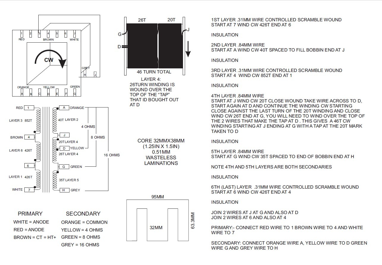

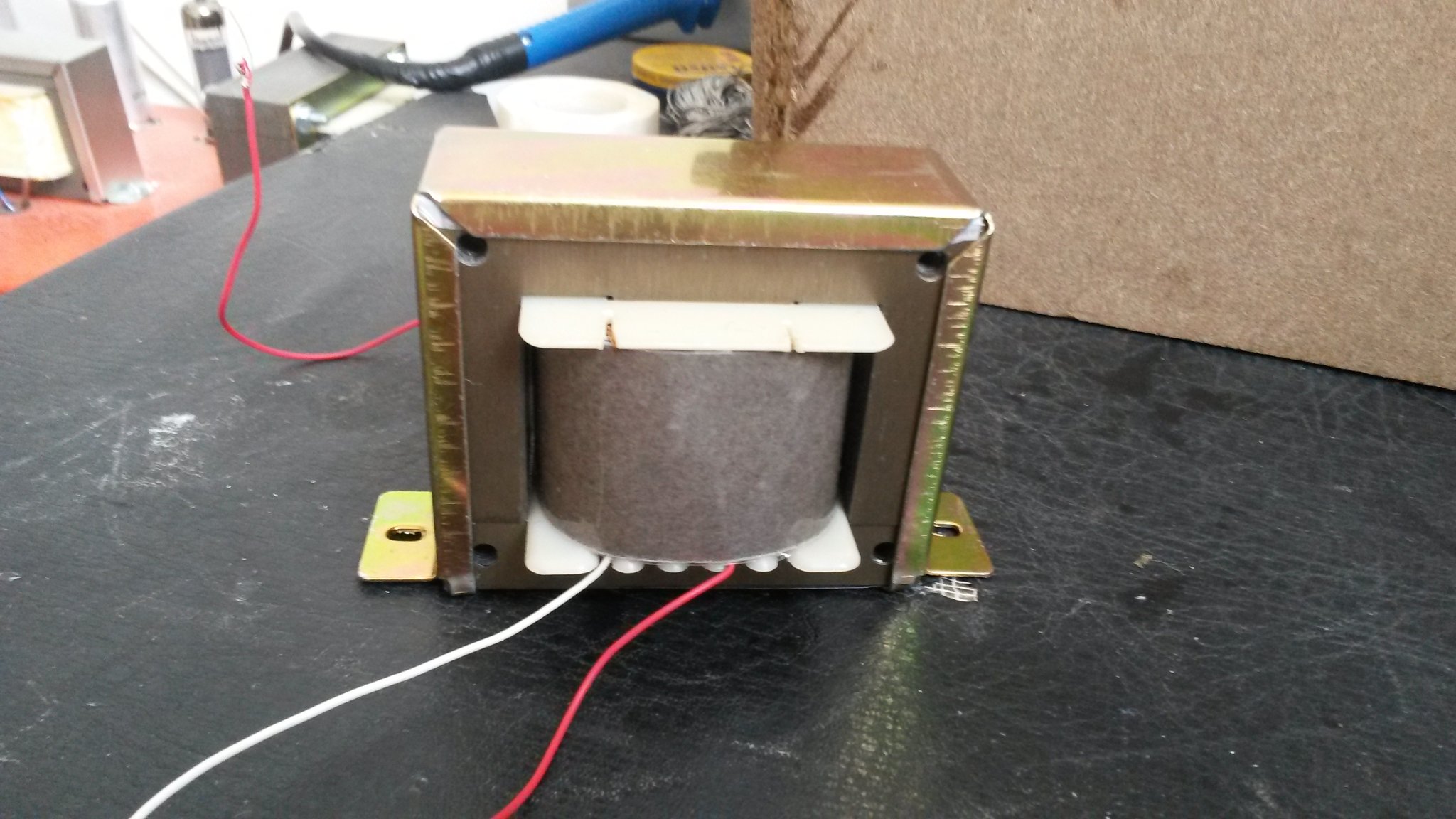

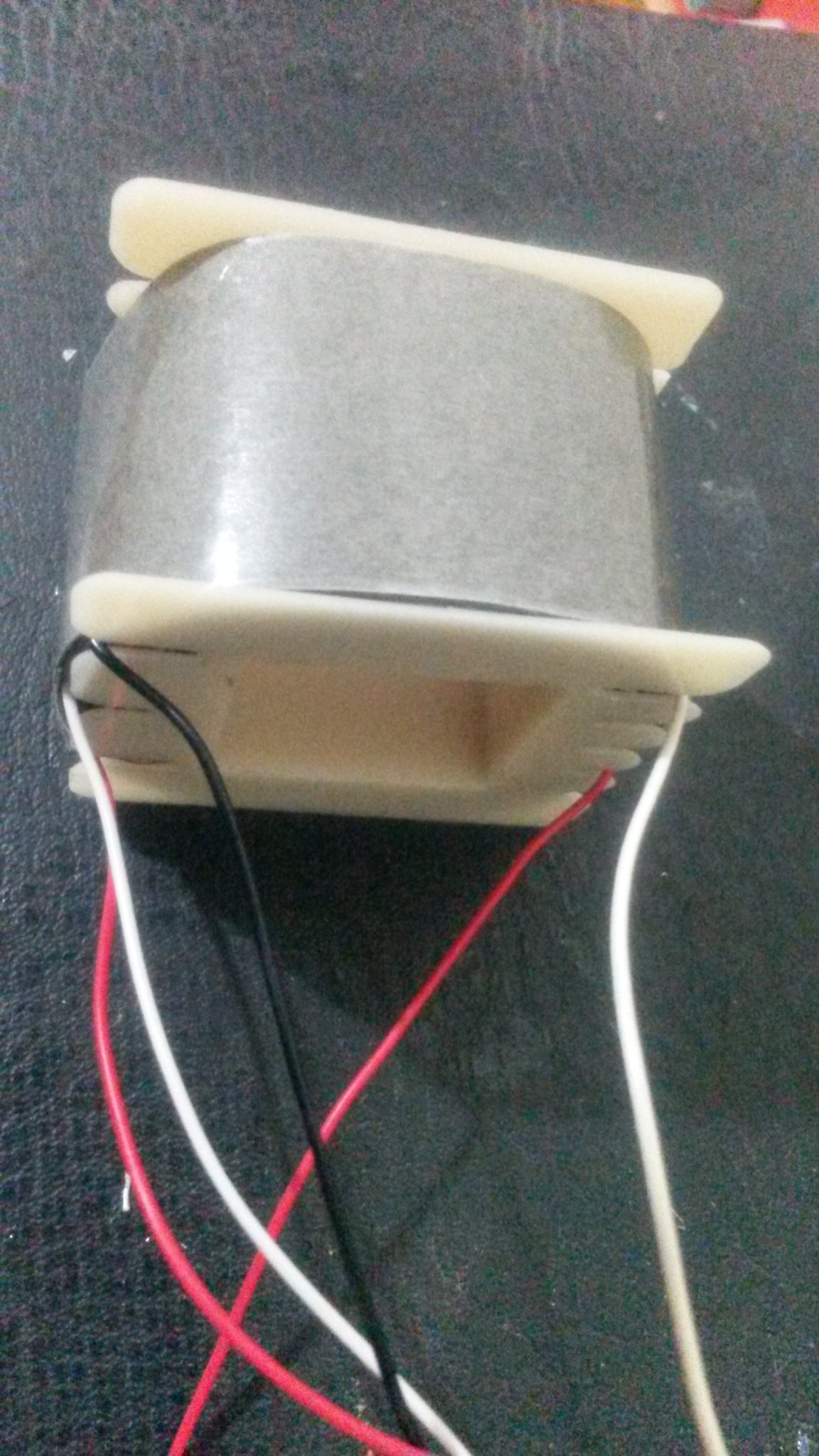

Dear friend, you wrote a lot of output transformers... you made them for guitar amplifiers... is it possible to publish a picture of these creations? Did you make the guitar amplifier yourself?Hi everyone, first time poster long time reader!
For a long time I've wound many output transformers for guitar amps and due to Low-Fi nature of guitar amps OPTs turnrd out to be good enough, but this time I'm in process of winding my first Hi-Fi tube amp output transformer, and after gathering information from several sources like RDH4, Wolpert's books and mostly important Patrick Turner's website, I realized that I need to find a good GOSS material for this purpose;

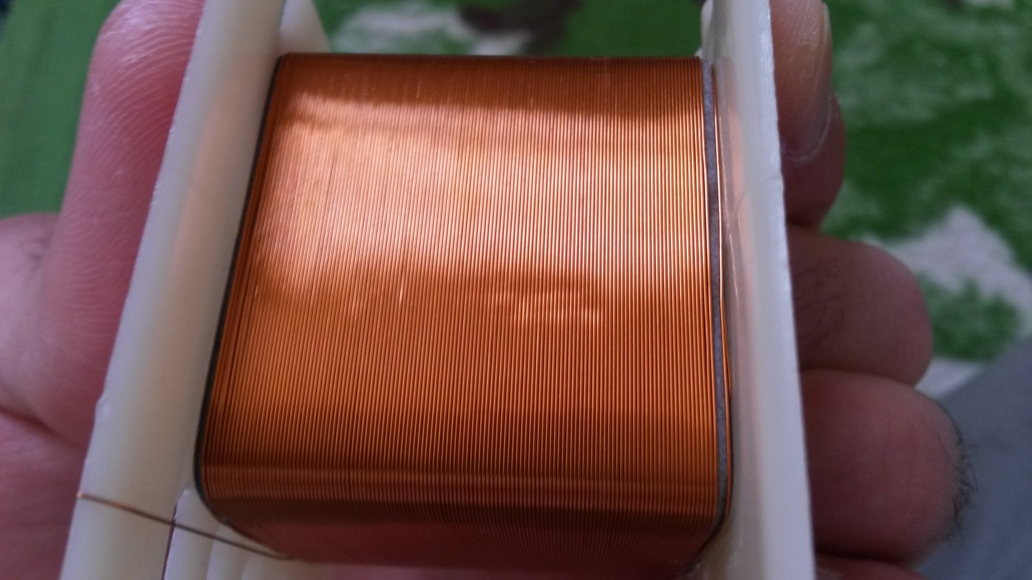

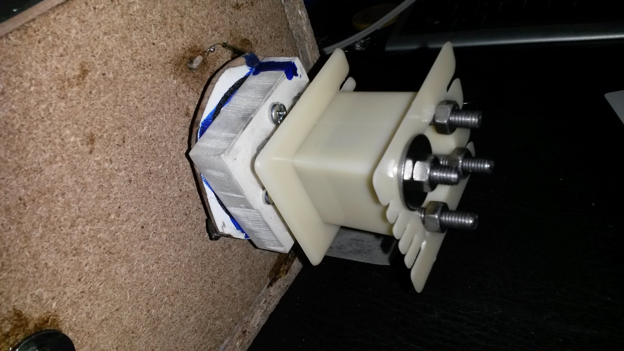

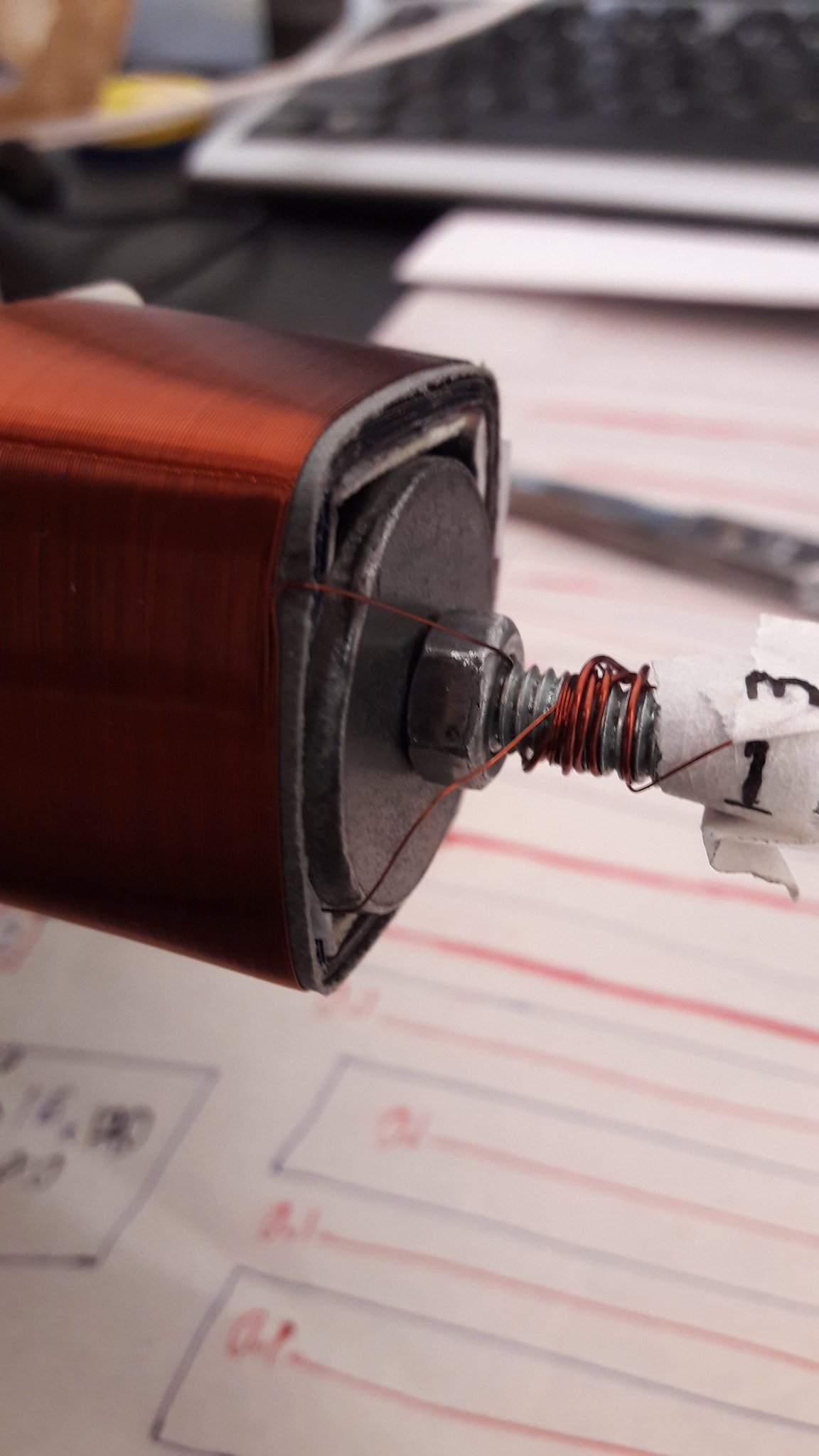

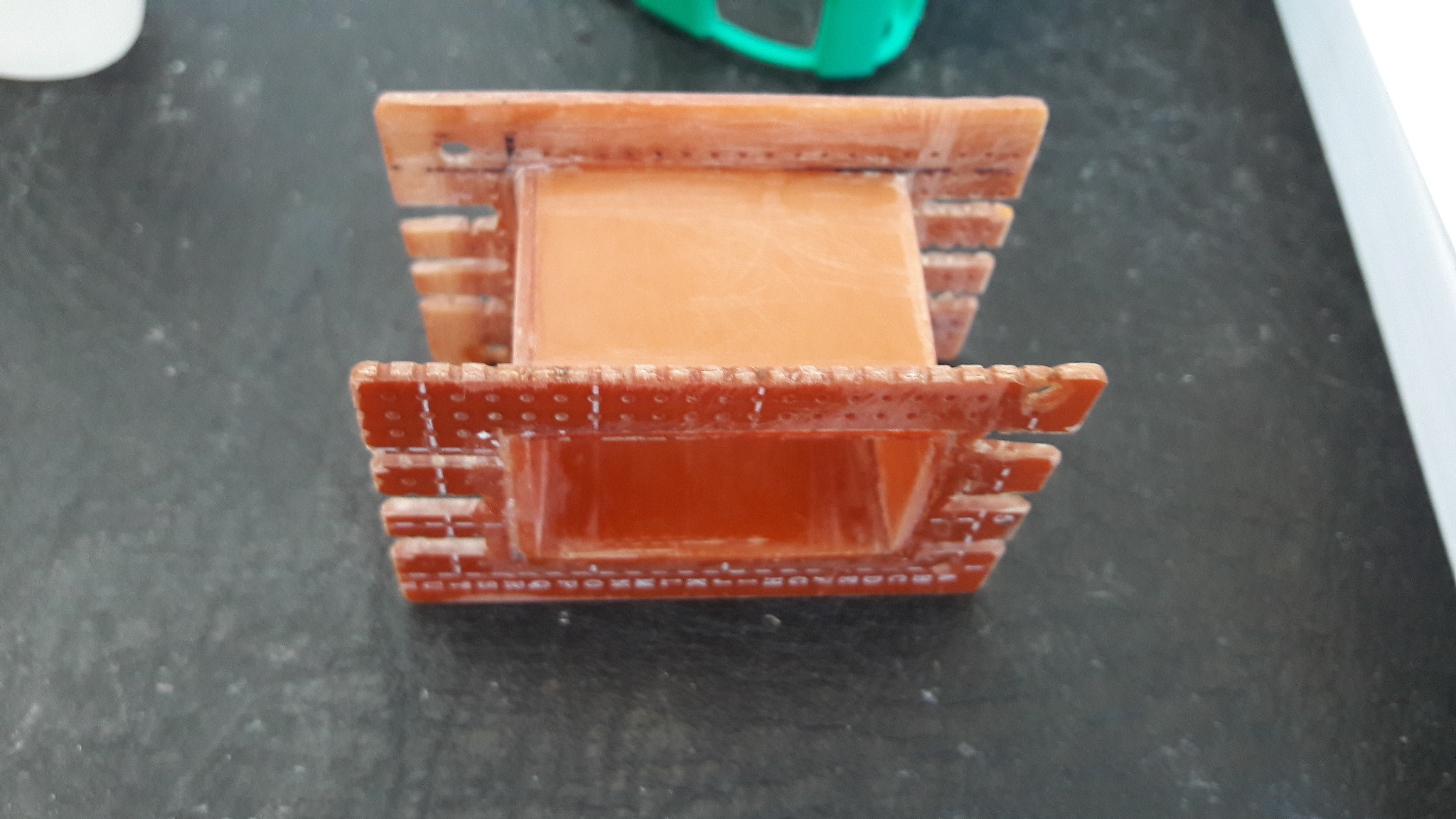

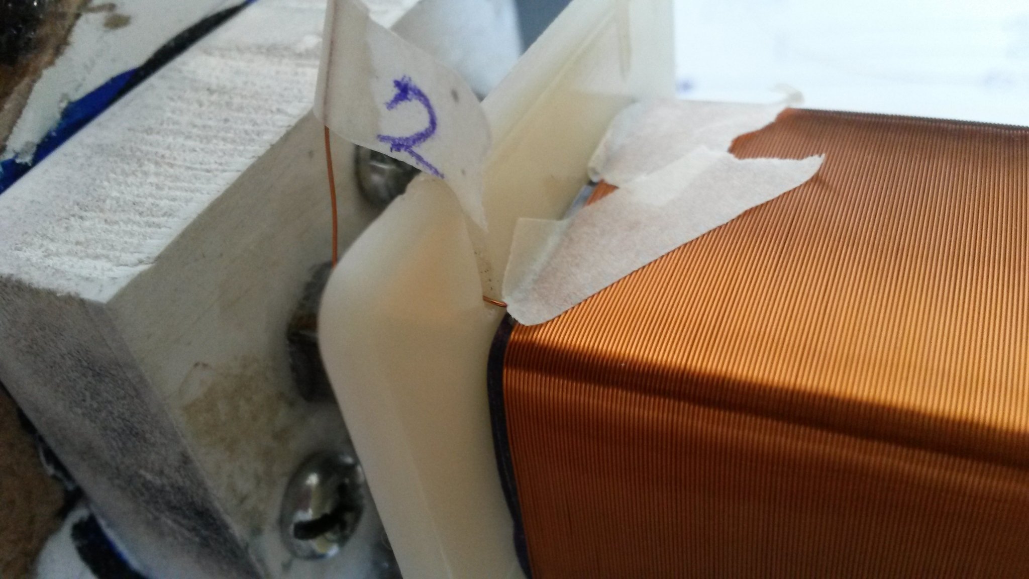

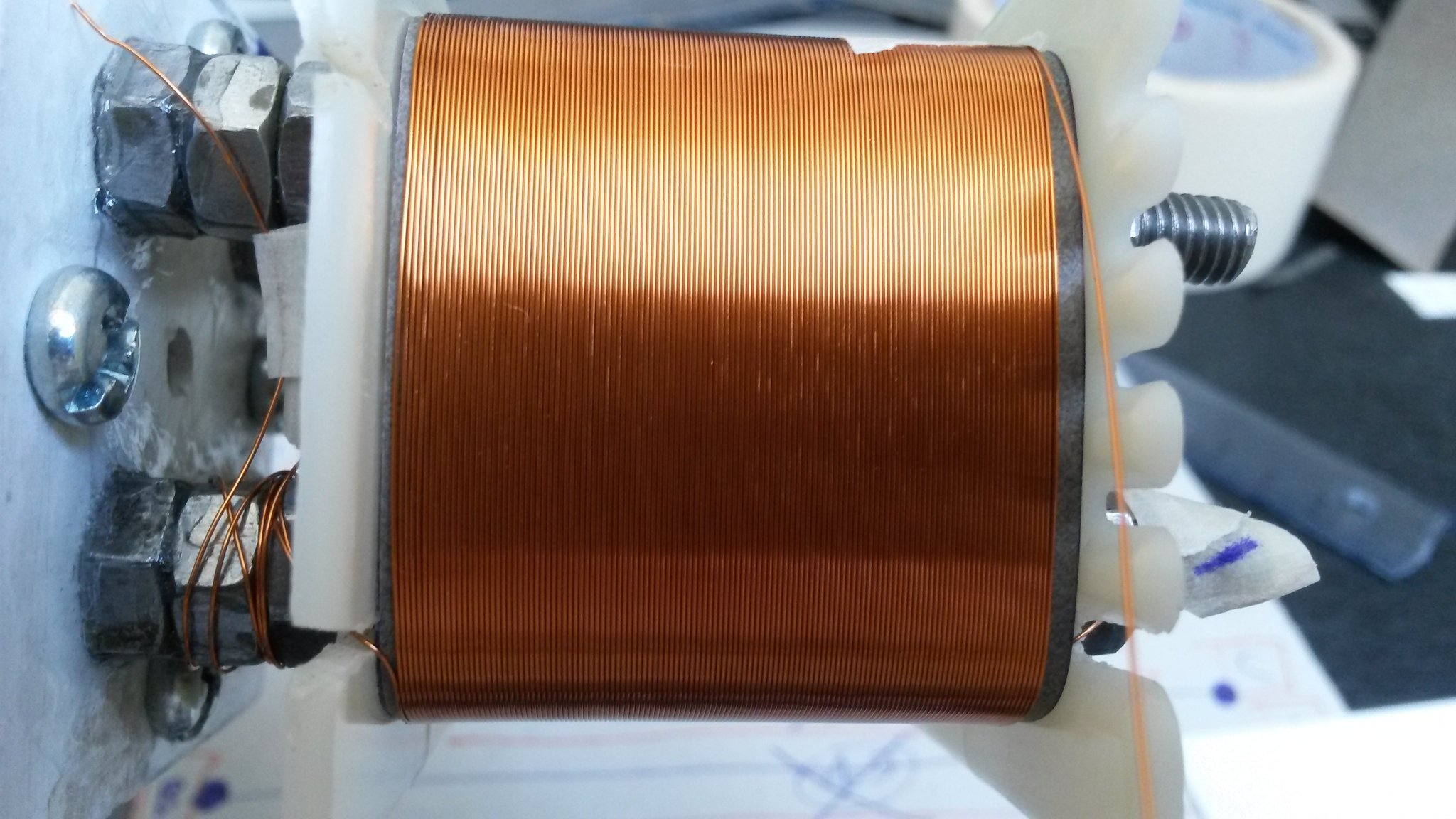

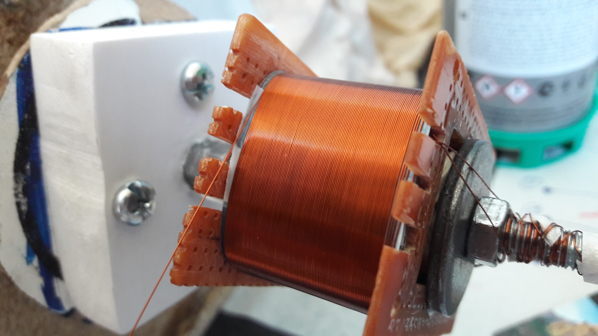

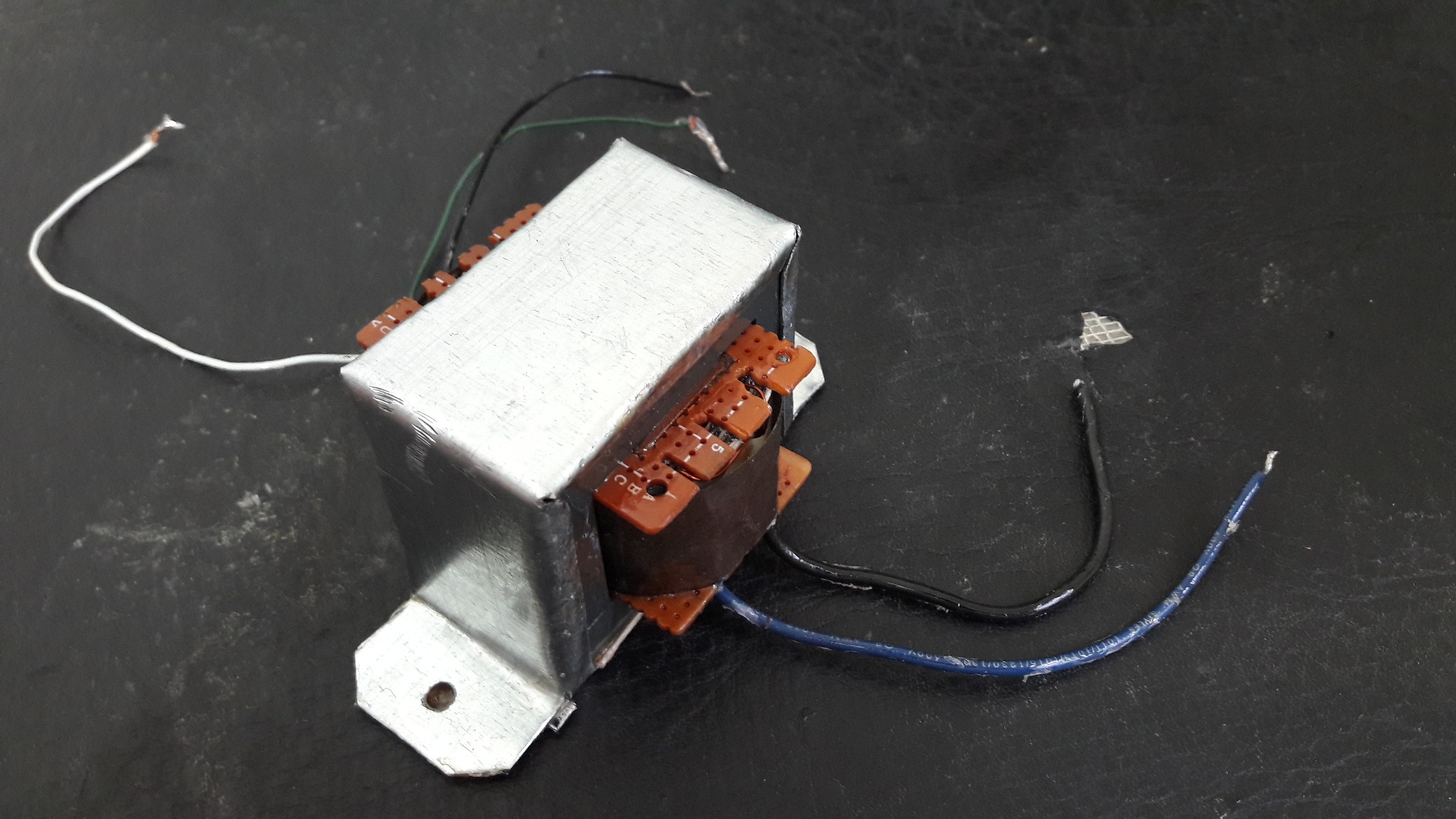

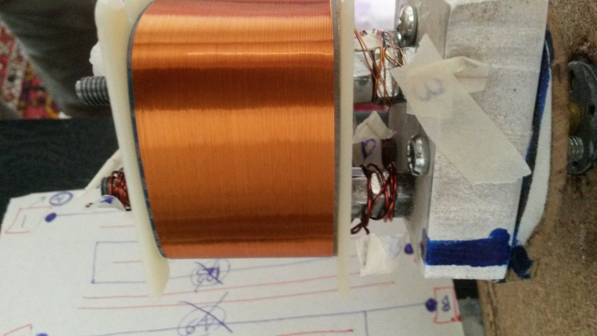

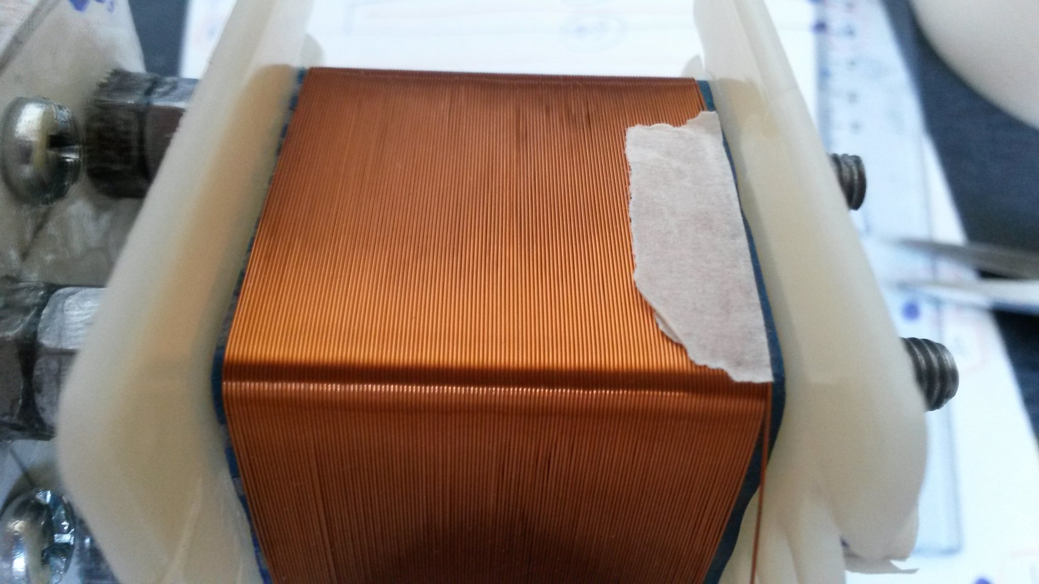

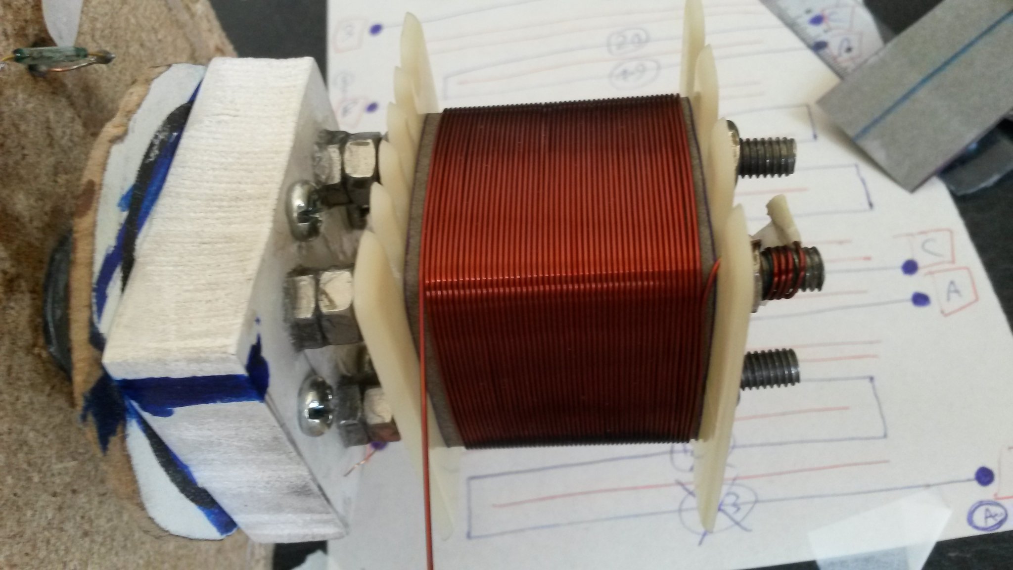

Of course my friend, Fortunately I still have a few pictures from my old work which I will attach them here;
These transformers are from my early work which I used my old handmade manual lathe to wind. Lately I've built a CNC automated winding machine which made my work much much easier.
BTW in the field of audio art is as important as the knowledge; I assume you already know that! right?
