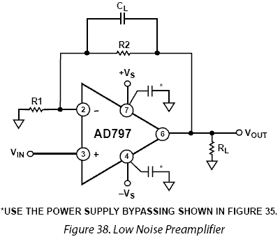

With Rs<60ohm, I meant R1 (and also consequently Rs). Ideally R1 should equal Rs (output impedance of circuit connected to Vin), to have some noise cancellation. And both should be as low as possible.
Please correct me, if I am wrong.
Don't worry too much about matching impedance, BUT keep R1 LOW! 10 ohms is best here, but 30 ohms or so isn't too bad.
Remember, you don't necessarily want to measure 1/f noise below 100 Hz, so you might still use a cap in series with R1 to remove ultra low frequency noise, that will just make your meter flutter. Second, you should put an input resistor on the positive input that connects to ground. This is just good practice. 50K-100K should be OK. It will NOT add any extra noise as it is in PARALLEL, and not in series with the input as long as the source being measured is of low value in output impedance. Third you should keep the 1500pf or so across the main feedback cap, to reduce the bandwidth, or else you will just measure the ultrasonic stuff.

Hi!
I have something like this in my mind (PSU bypassing omitted).
First opamp (AD797, LT1028) is gain of 330 w/ low pass filter. I've added second stage so that I could easily make an high pass filter.
For second stage there is no need for an low noise opamp.
I am going to use rotary switches to switch between different LP/gains.
This simple circuit should work nicely. I hope I haven't miss anything.
Thanks for all the tips 🙂
Matej

MateJS, you are close, but it might be useful to put a series electrolytic cap in series with R1, maybe 1000 uf, but it not be too large, because it can have a very low voltage rating. This will help the potential offset, and remove any extreme 1/f from the test. Extreme gain may not be useful, because you will still have a measurable noise floor, due to still having a relatively wide bandwidth. Scott is also right about the 1meg. Only fet input stages can get away with that easily. 50K should be OK. This is what I use with the AD797(s) in my Sound Tech analyzer.
