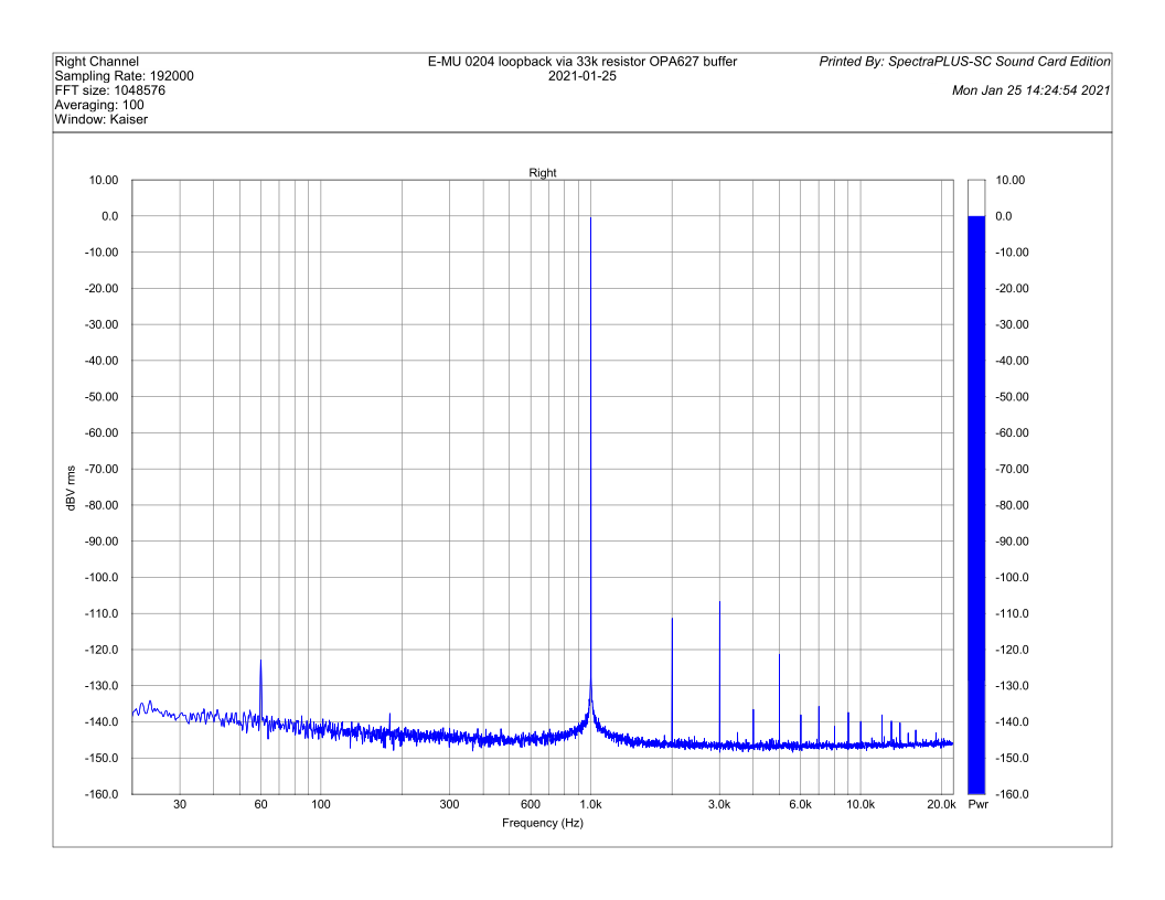

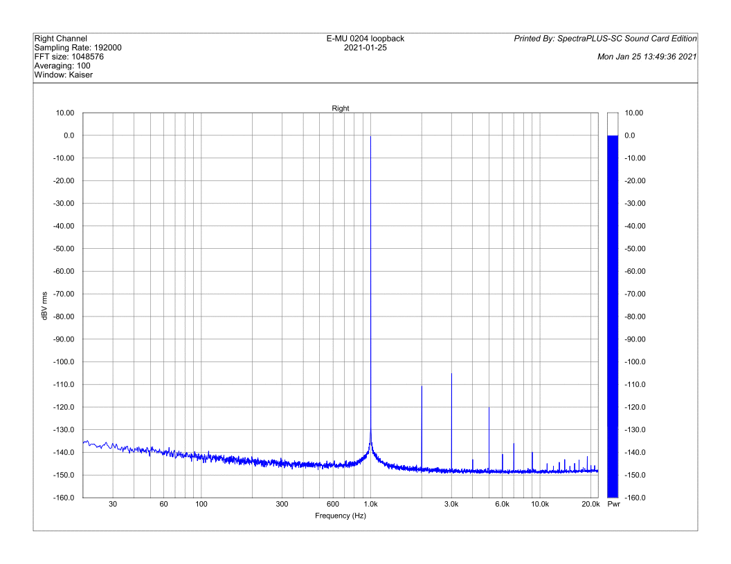

I am using an E-MU 0204, an obsolete but still decent sound card with AK5385 ADC and (I believe) AK4396 DAC.
The card's specs are 113dB SNR and 0.0008% THD. In practice, is shows a bit better THD, around 0.00067% (-103dB), when its output is directly connected to the input and the level is set at -6dBFS (about 1Vrms):
However, when input is connected to the output via a 33k resistor (this is relevant because the output impedance of, say, a passive filter can be quite high), THD grows by more than 20dB to 0.0088%:

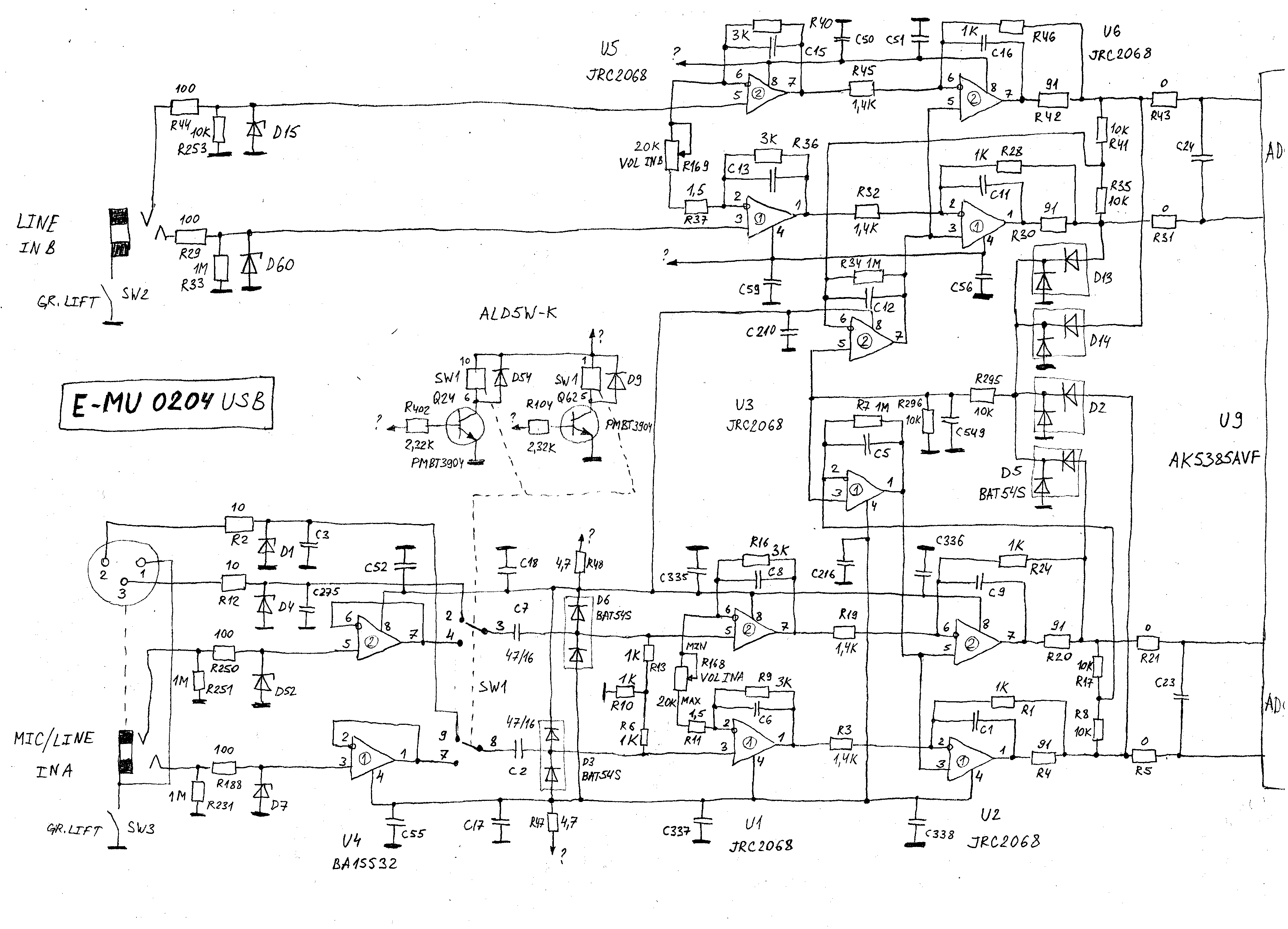

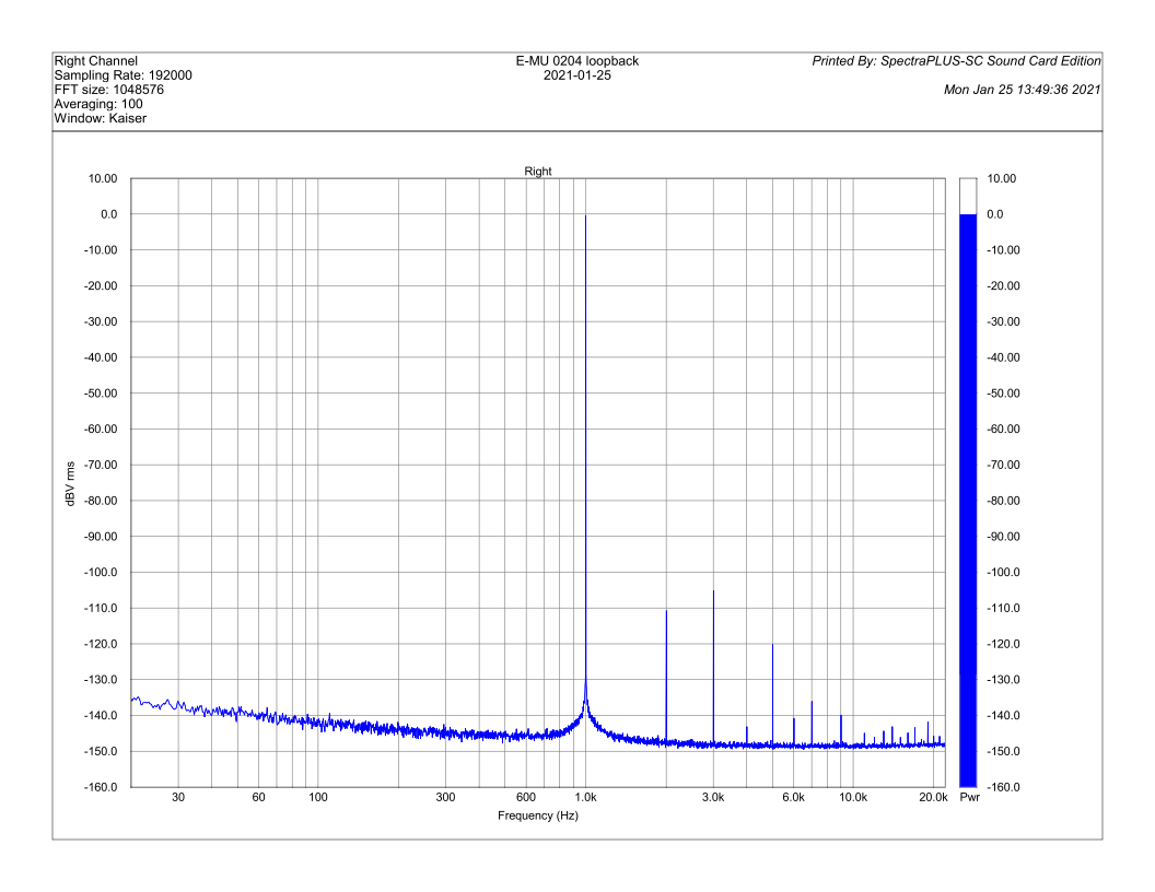

Looks like a textbook case of common mode distortion. A glance at the schematic of the ADC front end (found on the web) confirms the suspicion. Both U4 and U5 should see a low impedance source:
The fix is to buffer the input by something not susceptible to CM distortion. One easy (but expensive) option is an OPA627 connected as a unity gain buffer. The OPA627 features a bootstrapped cascode in the first stage and is comfortable with high impedance sources. With it, the distortion is actually a couple of dB better than with a straight wire:
