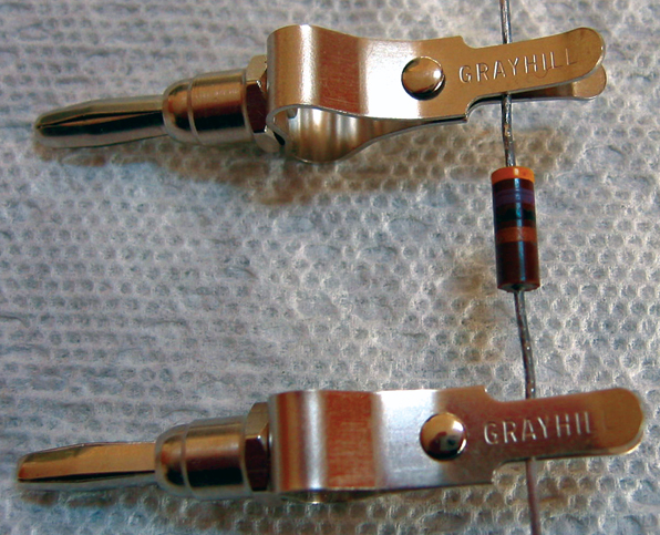

Same room temperature and humidity? Have the parts been moved or being held differently? Or did you use clip wires on the probe ends and then not touch the setup other than turn the meter off and on. SO tomorrow, you can carefully turn the meter back on without budging anything else from the day before
I agree that this can vary from day to day. For matching, that doesn't matter - just measure the various parts in quick succession, within a minute or so. Meter variations at short term are much less.
You can check it by measuring the same part in quick succession. If you read the same value within less than a minute, you're all set!

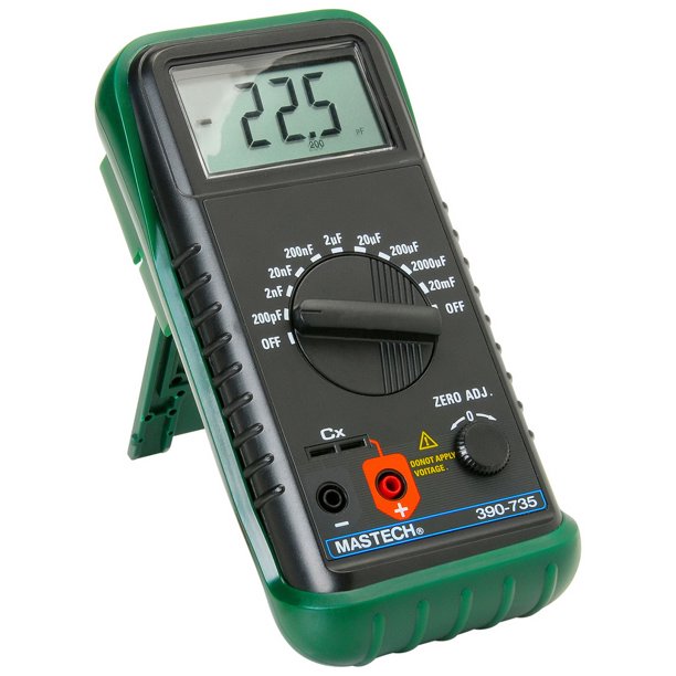

My Fluke 87 (in relative mode) let me down, or so I think it has. Every day I measure the values go up and down a little -- inconsistent. Is it temperature related or what?
I see the same effect with my multymeter (not Fluke), that's why I use it only to compare two caps at the same time. For precision measurement I use professional RLC-meter (Mastech 5308).

The Aneng 8009 may be cheaper, and has been quite accurate for me. Plus it provides so much more 🙂
On my fluke 87 it shows similar on smaller caps. Its lower limit seems to be around 1 nF and the residual is really sensitive to the leads. I know from experiece that the leads add > 100 pF, not the 360-450 pF the meter is indicating. I would not use it for anything beyond testing motor caps for failure.
