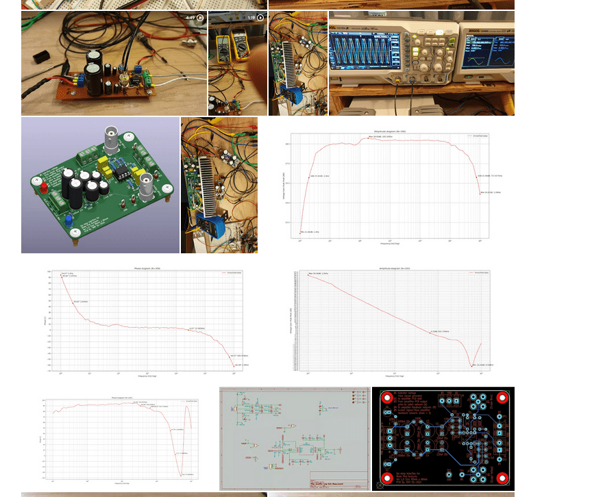

Let me mention again that this is the amp that didn't oscillate at all.
From the last post this amp oscillates simply by raising the feedback resistor to 20K total.
I changed them to two 2.2K and yesterday it didn't oscillate with the cap out, today it does.
Changed to one 2.2K and it doesn't oscillate but along the way here I added a pair of
100uF from the rails to ground. Now, with one 2.2K it bursts into oscillation when I remove
the fuse which removes the 8R load and .1uF to ground. Oscillation is at 520KHz but it I
remove the 100uF bypass caps it becomes stable again.
I didn't use resistors in the supply rails to decouple the front end but this is not good.
The other amp oscillates around 3 MHz.
I wonder if it is local to the output stage, oh probably not since it is sensitive to the feedback resistance.
Going to think about where to probe and a fix to the grounding and PSU decoupling.
Once again, this is the amp that did not oscillate.
Went back to the two 10K feedback resistors but left out the cap to ground.
It oscillates just turning it on.
I had removed the 220pF cap at the input to ground for square wave test and decided to connect it
again, what do you know it stopped the constant oscillation.
I remember Keantoken, talking about the input cap having an impact on stability, is anyone able to
explain the theory behind this? I assume that the feedback is coupled through any of the device
capacitances back to the input?
I improved the grounding - no significant change. Put the 10uF cap back to ground on the feedback path.
I lifted the input ground from the chassis and connected it through a 10R resistor to the output ground
on the circuit board - no difference. Perhaps I should have run a dedicated wire to the star ground.
I have a hunch that it is actually oscillating at the 1 - 5 MHz range when kicked into oscillation but I'm not
seeing it on the scope, rather I see it in the 15 to 150 KHz range.
In the process of running the sim, I tried many common methods for stabilizing the amp, looking
at the loop gain.
Miller cap didn't help much.
I won't go into all the details but a zobel (330pF + 100R) from the VAS collector to ground and a 330pF
across the VAS emitter resistor - SEEMS to make it stable. I got hints to try these from the Tigersaurus,
JE990, and the Bryston.
I tacked these into the amp and now it is reasonably stable, square wave response of the loop gain
has maybe 5% overshoot. When I touch the hot connection of the input it bursts into 30Vpp
oscillation at 15 KHz - strange could this be pickup of some local radiation? I set the scope very

The input RC filter attenuates incoming high frequency noise, so a marginally unstable amp like this one
is less likely to oscillate if there is not enough HF energy to trigger it.
Well, yes of course it is an input filter, but Keen talked about it causing a pole or altering one
from a loop gain perspective. I suppose I should ask him. @keantoken
Also, to add to my previous post, since the main negative feedback path is shunted from an AC
perspective it should have no way to oscillate and perhaps there's a "sneak" path through the
rails or ground. Or have I built an oscillator with the 10uF on the 10K resistors, and the shunt
on the negative input? This didn't show up in the simulation.

I believe that the input filter more or less affects the loop gain phase response. My previous post.
https://www.diyaudio.com/community/...se-margin-of-an-amplifier.137436/post-7164930
Thanks! That's exactly what I was wondering about, the thing is that this amp has 220pF to ground
at the input. I will read that more carefully. I've seen amps (OP amp based) where something like
47pF was included across the differential bases, does this help in anyway? I'd think that it would
only make it worse. I'm going to read that entire thread.

You may want to look at the last two pages of this document.
This was the method I used.
I measured the honey badger with it. Check out my build album for more details.
HB Build Album
I used a python to drive my function generation and scope to get the data for the plot.
Over all it worked well. However I don't think the phase margin was completely accurate possibly do to the bandwidth of the op-amp.
HB Build Album
Yes. I have also seen capacitors inserted between the inverting and non-inverting inputs in many particularly commercial amplifiers.
They are inserted as an EMI countermeasure. I have also experienced 60Hz demodulation buzzing under a strong electric field near a TV broadcast transmitting antenna (NTSC analogue broadcasting at that time), which was greatly reduced by inserting those capacitors. However, the phase characteristics almost always go in the undesirable direction. (However, in the case of R+C, it is often used as a compensation method to stabilise the unity loop gain frequency down without reducing the amount of feedback in the audio band.)
