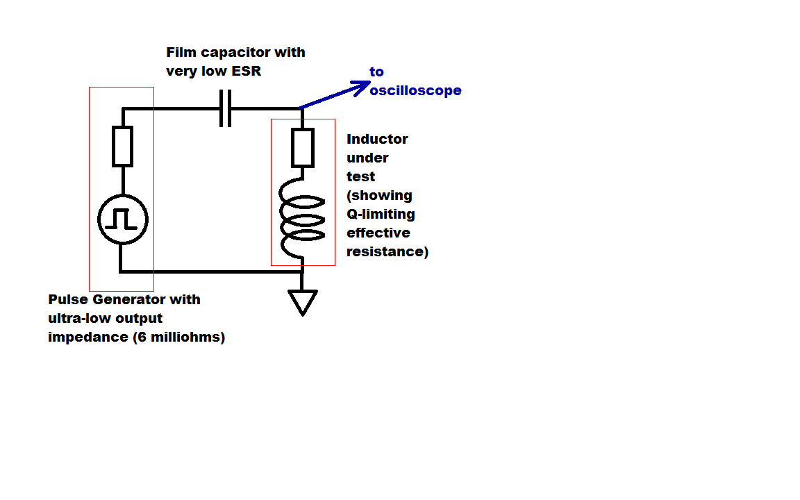

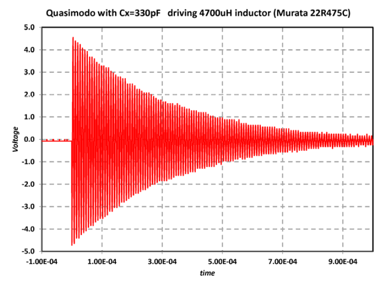

One way to measure inductor Q is to use a resonant-circuit technique. The inductor is connected to a very high quality film capacitor, and this LC circuit is stimulated by a low-Z pulse generator. The circuit resonates, and the ringing slowly dies away due to the damping provided by the (unwanted!) effective series resistance in the inductor. Then we use the logarithmic decrement method to extract the damping coefficient Zeta. Finally, Q = 1/(2xZeta) and we're all done. Of course this measures Q at the resonant frequency of the LC tank; you can measure Q at different frequencies by selecting different capacitors.
The first figure shows a conceptual schematic, and the second figure shows a captured scope trace from an actual L and C and pulse generator.
To apply the logarithmic decrement method, we observe that sinusoidal crest #6 is 4 volts, and crest #19 is 3 volts. Thus N=(19-6)=13, V1=4, V2=3. Applying the formula, delta = 0.2213 and the damping factor Zeta = 3.52E-3. Since Q = (1/2xZeta), Q = 142 for this inductor, at this frequency.

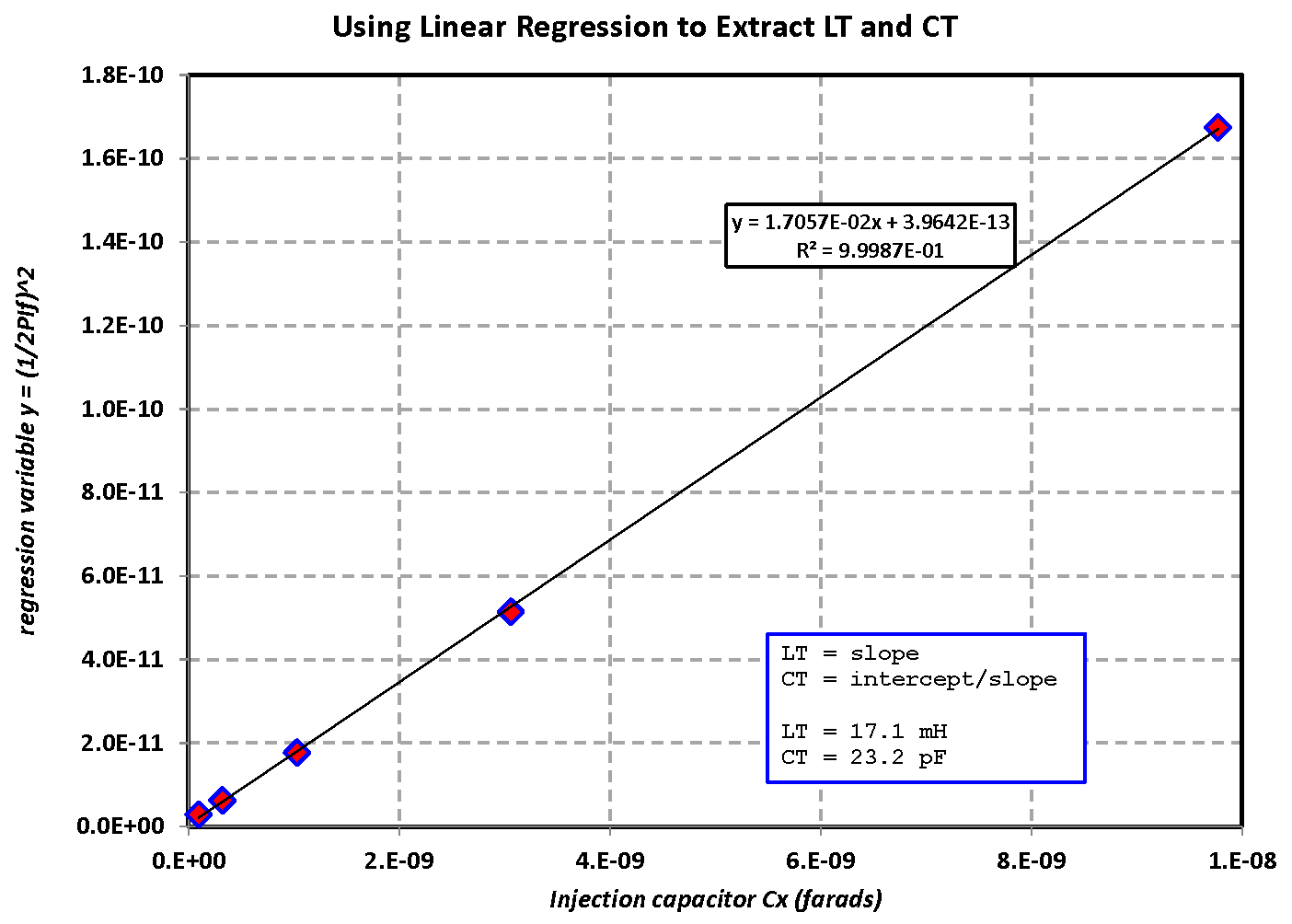

If you resonate the unknown inductor L with an external capacitor Cx, you are free to choose a value for Cx which is two orders of magnitude larger than the inductor's interwinding capacitance. This completely swamps out the effect of interwinding capacitance, rendering it negligible.
But if you really, really need to measure both L and Cinterwinding, Quasimodo Appendix C shows one way to do it. Measure resonant frequency with a variety of external capacitor values. Then perform linear regression. The slope gives you the inductance and the intercept gives you the interwinding capacitance.
