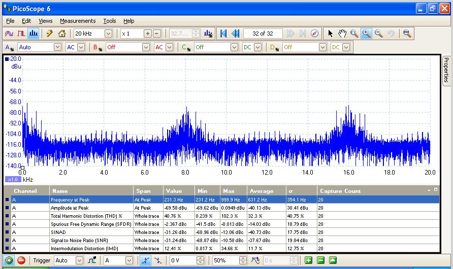

1) The first image is the FFT with no SPDIF connected. Wondering what that bomps are, but this can be not relevant

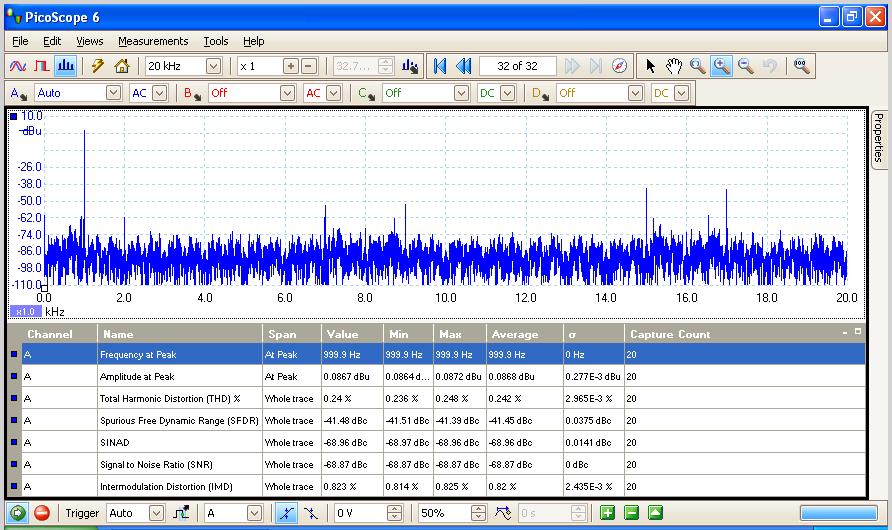

2) Second picture is a 1kHz signal 44.1 kHz. There are so many odd harmonics, but the measured THD is not so bad.

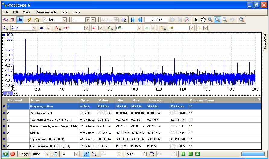

3) Third picture is the same signal with 96 kHz. The FFT looks much better, but the value of the THD is almose one order of magnitude more.

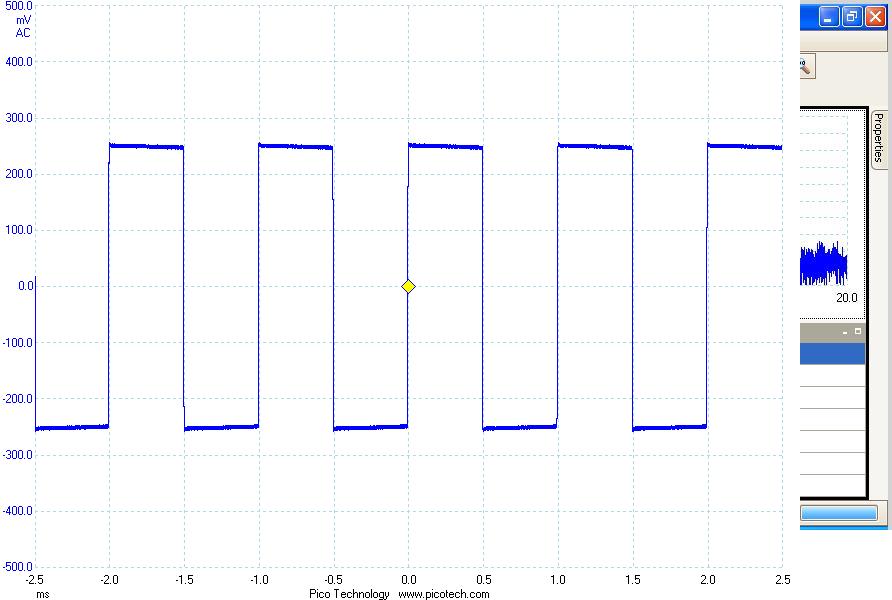

4) The last picture is a 1kHz square wave. This is where the DAC performs very well. If compared to the analog output of the MAC it is perfetc, while the MAC was showing very evident symmetric ringing.
