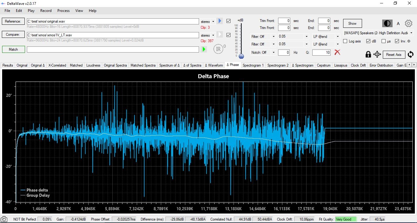

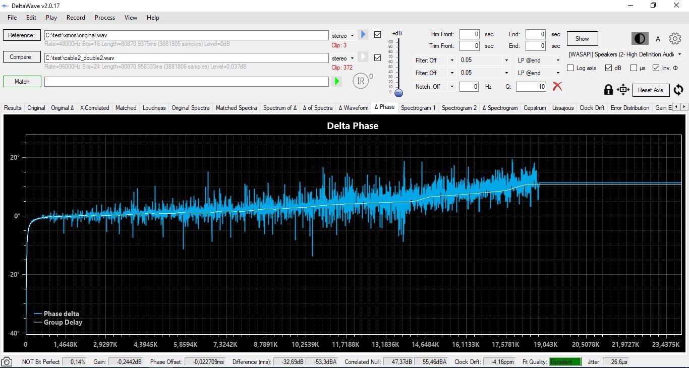

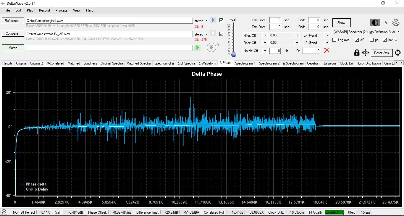

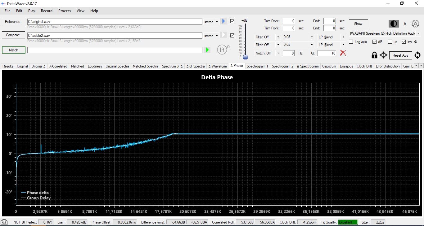

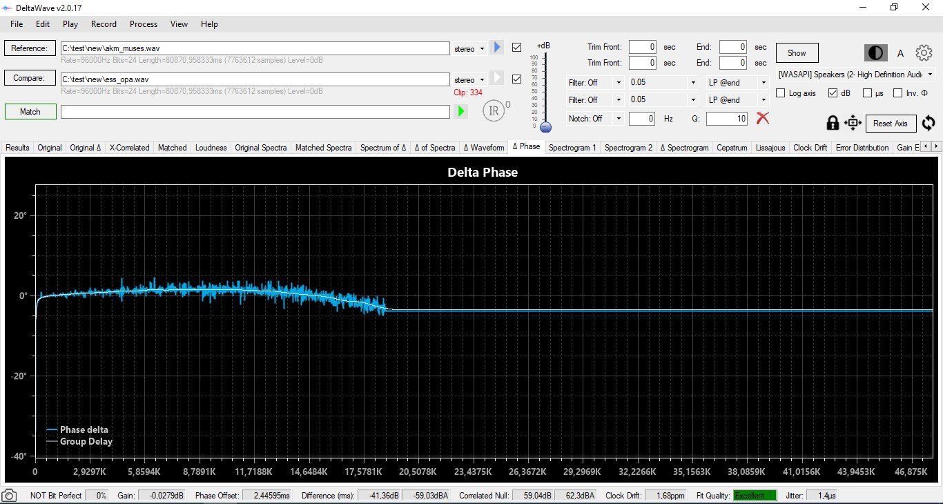

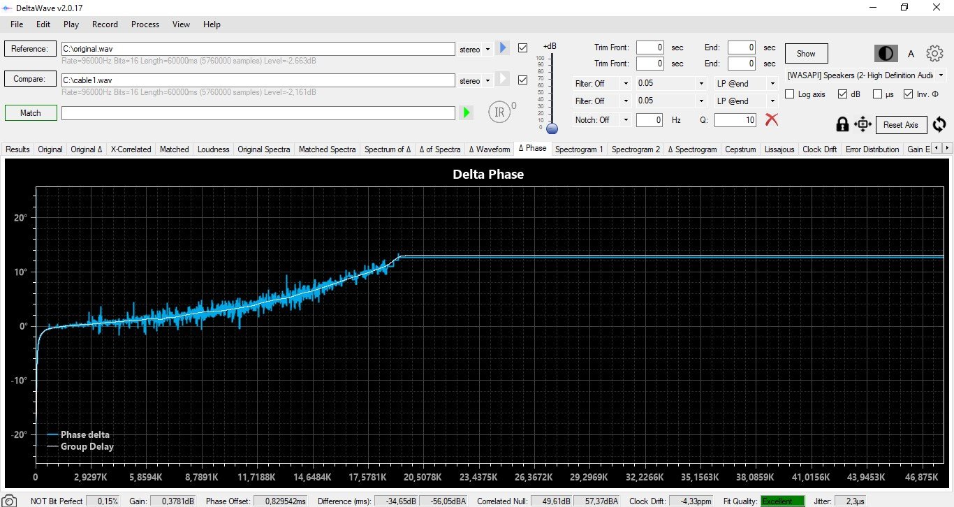

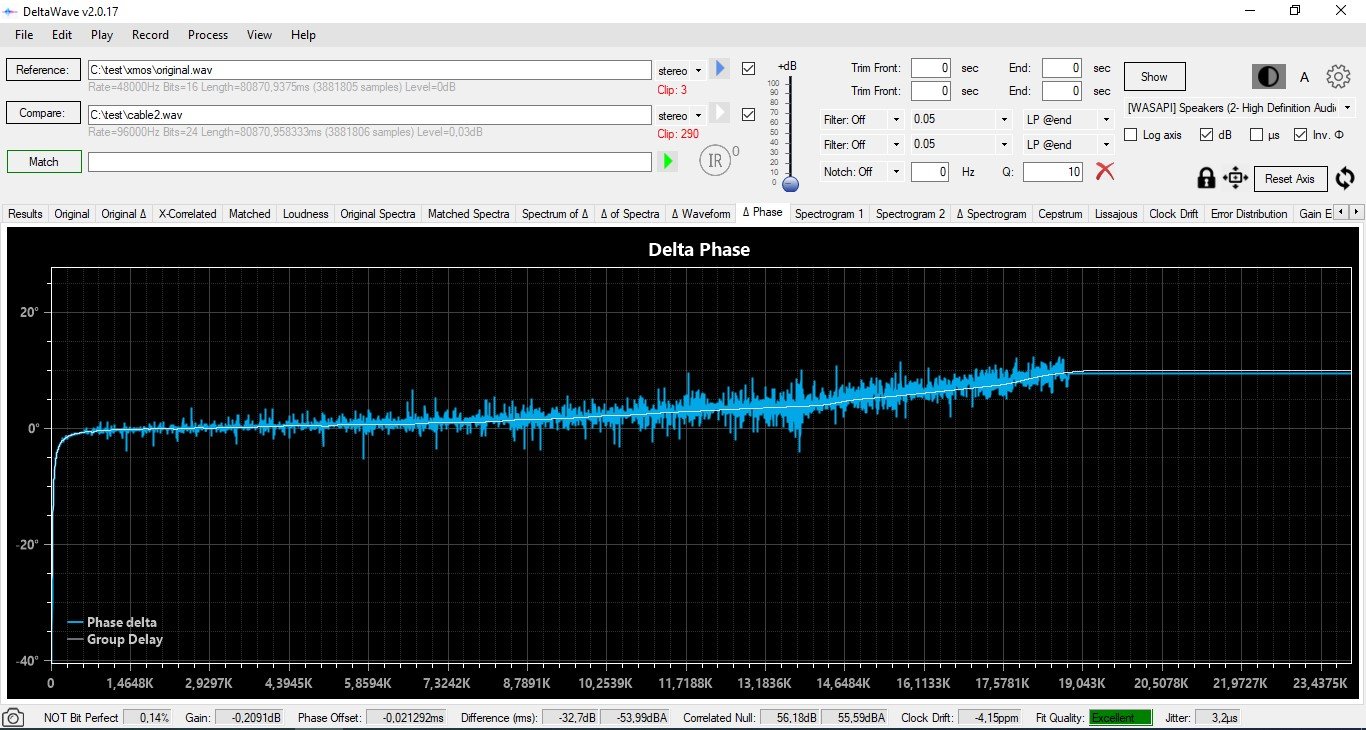

Another example to look is two different interconnect RCA-RCA cables. Don't look at greater rise of cab1_delta_phase, it is zoomed on Y axis. Big difference in waveform between original record and 1 or 2 cable is in loopback WASAPI recording and DAC>ADC recordnig. Interesting to know what is wrong with comparing delta phase between different recordings. Perhaps we see a problem in my crap ADC, but anyway anoter differences are seen clearly. I don't want to name this two cables, if you interested, ask in PM. It is not about expensive audio gear. Just about difference.

Once again this is a misuse of DeltaWave. If you want to "prove a point" you should post both recordings and the original as well so others can perform the analysis themselves and possibly find out what is wrong with your setup.

Please also try to compare 2 recordings with the same interconnect cable.
Use a wav file as original. If you only want to record 60s edit the original. Make the recordings with DeltaWave using WASAPI exclusive mode drivers preferably at 24 or 32 bits. Do not edit the recordings.original:
Why it is so important for you? Excuses for not accepting the obvious? Even if here are present any windows resampling or something else - it will be on both records the same. We need to see only difference between them. You have an ADC and can repeat this simple recording with your rules about bit detph and special drivers, original file location, etc.

What your DeltaWave screenshots show is that there is a serious flaw in your measurement setup and/or procedure. I have already few times described how you should make these recordings. And the suggestion PMA made is very good: make 2 recordings with the same cable and check if you see a difference. It is important to use WASAPI exclusive mode and not to edit the recordings as resampling or editing of 16 bit recordings may involve random changes, e.g. added dither.then why not so see this on delta between them
