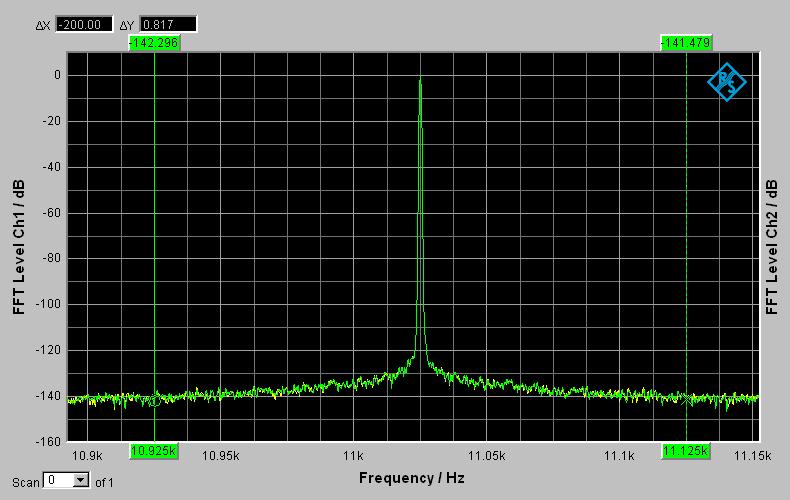

Hi HP,
The R&S HPV analizer I have has some limitations.
I cannot do greater than 256K points and averaging in the FFT window is not implemented.

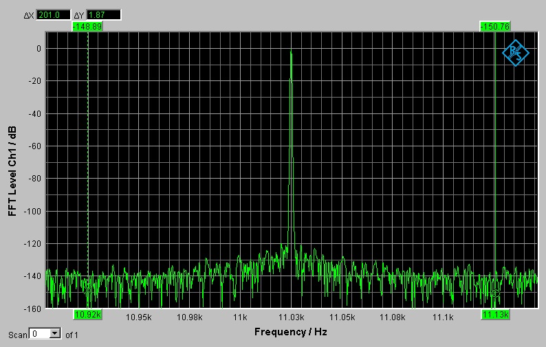

Well, looking at the UPV manual, it states "AVG count" in the FFT section,
give it a try.
BR
Gary
Dave,
there are some symmetric waves: +/- ... 5Hz, 12Hz, 22Hz, 50Hz in the -120.. -130dB region.
We have also to consider the FFT size (256K), while as used in my measurement (2^25) this will lower the bin distance and the noise level / bin, but in the other hand clear modulated (symmetric around the carrier) will be visible.
Hp

Hi Gary,
I'm working on a really old firmware version with the UPV I have. Version 1.4. Updates to the current version 3.2 are possible but I have to step through one or two previous versions to get to the latest. I had been waiting to do so until I sent it in for an upgrade to add the digital interface incase there was an issue upgrading and it went down.

That function setting (average, expo0nential, flat...) works for the calculation measured parameter calculation (THD for example) in the firmware on the UPV I have, but does not affect the FFT monitor screen available. The post FFT function is not implemented in this firmware release, which I assume is where it would be...Well, looking at the UPV manual, it states "AVG count" in the FFT section,
give it a try.
I can see how the higher FFT point size and/or averaging is desirable. Each FFT screen update when zoomed at this level changes. There are no repeatable peaks as are obvious in the other captures I took. I will make the attempt to update the firmware to see if the added enhancements also include FFT features that will help with this measure.there are some symmetric waves: +/- ... 5Hz, 12Hz, 22Hz, 50Hz in the -120.. -130dB region.

Hi Hp, Gary,
Firmware update successful - Updated picture of the 44.1/16 Jtest signal with 256K points, averaging 10 measurements per and zoomed in to +/- 100Hz. The 9023 looks to have good data correlated jitter rejection in our implementation ... Still limited FFT point size with the tool I have either way.
Dave

Looks like very, very low jitter levels that nobody needs to worry about.
Your THD and IMD measurements may be limited by the analyzer, at least assuming the DAC sticks to its -94 dB THD spec and the output stage doesn't mess that up. 2nd and 3rd at -90 dB each would be entry-level soundcard level (e.g. Xonar DG) at best.
It may be interesting to run the usual intersample-over tests, though I doubt the designers of a modern-day DAC digital filter would mess up there.

Hmm, looks like as from a different DUT. 😕
Hp

Hi Hp,
Here are the two measurements side by side again. Any peaks and troughs in the one on the left (no averaging) are random and move around with every sweep.
I did not get the grid set up the same as all of the presets went away with the upgrade. Apologies there.
Dave
Nope, same one. I have two of these buit up identically and they both perform similarly. I am reasonably sure this is the same one used for the original testing as it has not left that bench and the other is in the system to listen to...Hmm, looks like as from a different DUT. 😕
