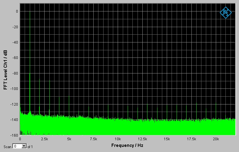

Several members commented on the quality of audio achievable with an inexpensive DAC chip like the ES9022 or ES9023. I'm impressed with the subjective quality and objective measurements as well.
I started out at 44.1/16 for the measurements and quickly realized that the board is much better than this is capable of demonstrating so 24 bits was the way to go. I also could only find a 24 bit JTEST wav file at 48KHz sample rate so that is what I used. Measurements at 44.1 are for all practical purposes identical…
The analyzer is a UPV from R&S running 256K point FFT with no averaging. The one I have does not include the digital interface option so I use a PC running DR Jordan Designs’ function generator as the source and a Highface USB to SPDIF converter in 48KHZ 24bit using ASIOforall v2. Measurements that used two tones (IMD and DNR) required ASIO to be disabled so they are at 192KHz to make up some of the noise floor lost running without ASIO and driving with two function generator instances.
The first picture is THD at 1KHz and 2V RMS. At a little less than 0.006% it is not earth shattering but very respectable.

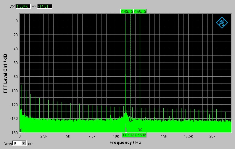

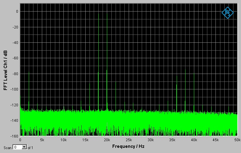

The second picture is IMD 18K+20K.

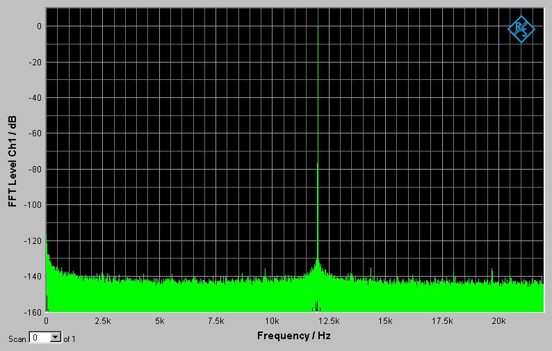

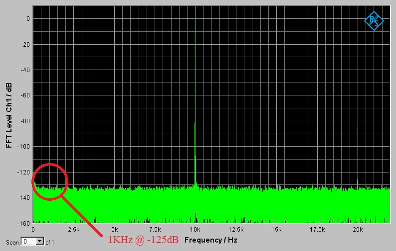

The third picture is DNR at 1KHz with a 10KHz 2V RMS tone. With a noise floor of a microvolt or so RMS the -125 db 1KHz peak is readily visible peeking above the noise. That is ~21 bits of useful resolution. This DAC is dead quiet with a completely black background to the music!

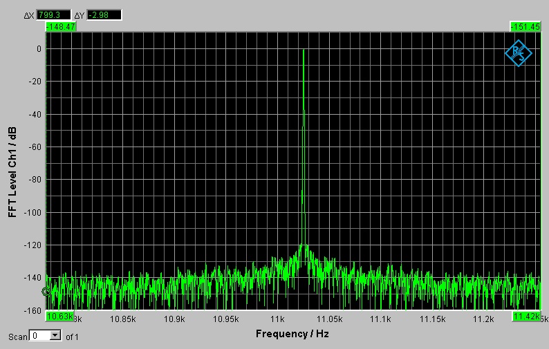

The fourth picture is of the 48/24 JTEST. The -133db peaks are inherent (they are essentially the same with either a single 12KHz tone or with the JTEST signal) and represent jitter of around 3pS. There is almost no measureable increase of data correlated jitter for this board with the Highface.

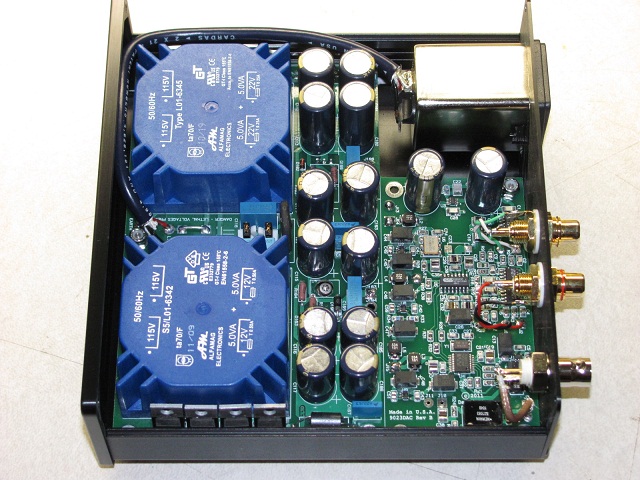

The last picture is of the DAC board itself. I have a final revision I want to make to the PCB to remove some passives and filters I added for testing purposes, as well as to accept different capacitors in the output filter. Other than that it is pretty well finished for now.

Very interesting plots, thanks for sharing. 🙂
How do you know you're hearing jitter on these decays? IME I hear artifacts on some DACs, but its not jitter. Are you saying its jitter because you can't think of what else it might be? If you are hearing jitter when the jitter products are below -100dB that's no mean feat.
Looks interesting - may I ask why two transformers, and toroids too? Also is that a mains inlet filter?

Good question. I am confident in the conclusion of jitter being the culprit for several of the improvements I made along the way.How do you know you're hearing jitter on these decays? IME I hear artifacts on some DACs, but its not jitter. Are you saying its jitter because you can't think of what else it might be?
It is obviously a subjective measure as I described it, but I was able to back it up with circuit improvements during development that reasonably correlated to measurement improvements. One still baffles me though and I didn't find a correlation in measurements.
I built two boards at each step and always did A/B testing, both subjectively and objectively.
Agreed. My conclusions are based largely on the engineering process and on time spent with a formal education in music. Knowing how these instruments really sound in many different settings is kind of a blessing and a curse…If you are hearing jitter when the jitter products are below -100dB that's no mean feat.
My hearing is pretty good, but I figure I am hearing the differences caused by time inaccuracy and intermoduation effects in the complex music sounds, not by the direct spurious spikes we can see in the simple repetitive sinewave measurements.
The beauty of listening to instruments like the cymbals in my experience is the absolute predictability of the decay if they are allowed to ring naturally. Top hat is great because of its mix of mid and high frequency components. I love that sound in good recordings. Similarly the upright bass fundamental frequencies in the mid range of the instrument are such a long wavelength (yet still directional) compared to the transient of plucking or the rattle of the string when played loudly that it makes any disparity in the timing or placement of these audible cues easier to pick out.
Absolutely. My intention was to fit it into a small enclosure to match a headphone/pre amplifier I started some time back. I also was trying to get the lowest possible noise from an AC line supply. The toroids reduce the magnetic induced noise and were easily mounted to the PCB.Looks interesting - may I ask why two transformers, and toroids too?
The requirement for the second toroid is that I included a JFET follower buffer configured as a second order output filter instead of the RC (the R is internal to the 9023) described in the dataheet. I wanted to be able to drive a pot or other volume control directly... The power supply topology was specifically tailored to get the best performance out of the JFETs I chose and required a seperate supply.
Yes. It is an off the shelf unit available from Digikey. I wanted a filtered inlet, as well as one that was shielded - the proximity to the follower power supply is fairly close.Also is that a mains inlet filter?

Completely agree on intermoduation distortion. At one point I included a capacitor on the output as an RFI shunt but there was something about the sound that bugged me. Like a slight fuzz in female vocals at moderate listening levels. Almost like a Laryngeal leak or buzz. When I took the time to simulate it in circuit the intermoduation distortion products in the few kilohertz range were increased and easy to find on the real hardware. Removing the capacitor proved a positive, audible and measureable improvement.Whilst I'm not yet sure about time inaccuracy, I am convinced that intermodulation effects are crucial and don't show up on repetitive sinewave testing as you seem to say.
Caps as RF shunts recently came up on John Curl's thread. I mentioned my own experience of them sounding bad (on current out DACs though). Nobody seemed to share that - Charles Hansen said his experience differed but was unwilling to share details. Since the ESS9023 is voltage out its too different a case to make comparisons.
What leads me down the path with time accuracy are two personal observations about high frequency information outside of our audible range but that make noticeable difference in the perceived sound quality of music reproduction for me. I noticed at some point that I strongly prefer audio amplifiers and preamps with wider bandwidths over systems limited to the audible range. By comparison it sounds as if the music is truer to being in a room with the instruments.
My hypothesis for this would be the wider bandwidth amp has lower susceptibility to out of band interfering signals so generates fewer in-band intermod products. IME correct grounding helps improve soundstaging for the same reasons.

Hi Dave,
about your DJitter measurement...
the base signal is usual 16 bit (no dither) -6db with a LSB toggle (square wave)... and then please zoom in to get the narrow modulated symmetric waves (if any). May look at my web about my measurement using a RME BabyFace..
Hp
Hp
Hi Hp,

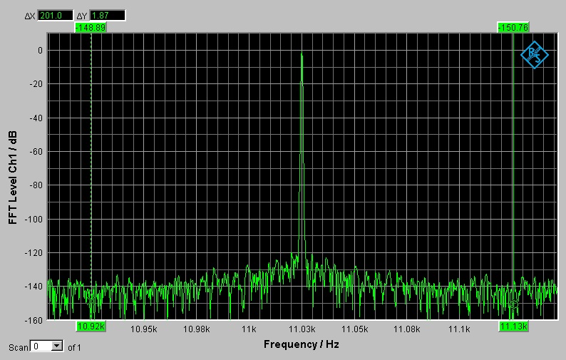

I used a 48KHz 24 bit version of the JTEST signal for the graph in the original post. This ensures the harmonics from JTEST are under the noise floor. It looks like the fundamental is -3dB.

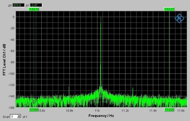

Here are three additional graphs - first is a 48/24 JTEST capture zoomed in. Second is the 44.1/16 JTEST. Last is a zoom of a 44.1/16 JTEST capture.

What I still missing is a complete zoom in into the +/- 10...100Hz region.. while your bin freq. is about 0.2Hz. And use also some averaging (may 8 times). Compare also with my measurement (currently presented on my web) where I used a 2^25 FFT size. Be also careful not to overdraft with the level. The basic measurement is by J. Dunn - 6.02 dBFS.
Second on your IM measurement: the level is here also very high near dBFS and this caused some IM products 2KHz -78 dBFS and 16K / 22K -92 dBFS.
You where also writing about some output filter caps to get ride of RF. the better design would be to not have/feed any RF on the analog part. This requires a complete redesign. I did this with my DAC project where the DAC & analog part where in complete different & closed copper boxes O😉
Additional if the DAc or the analog part is sensitive to IM product, may consider to bench it using an IM cluster 16..18Khz.
Hp
Hi HP,
Dave
Pictures of captures at +/-400Hz and +/- 100Hz are attached below. What are you looking for?What I still missing is a complete zoom in into the +/- 10...100Hz region.. while your bin freq. is about 0.2Hz.
The R&S HPV analizer I have has some limitations. I cannot do greater than 256K points and averaging in the FFT window is not implemented. It is what I have so I use it... At some point I will probably upgrade.And use also some averaging (may 8 times). Compare also with my measurement (currently presented on my web) where I used a 2^25 FFT size.
The JTEST files I have were not generated by me. Can you provide JTEST wave files with the appropriate level? 16 and 24 bit files at 44.1 and 48KHz would be appreciated. 60 seconds in length is fine.Be also careful not to overdraft with the level. The basic measurement is by J. Dunn - 6.02 dBFS.
Each tone is set at -6dBFS for that graph. What are you advocating for levels of each tone?Second on your IM measurement: the level is here also very high near dBFS and this caused some IM products 2KHz -78 dBFS and 16K / 22K -92 dBFS.
>> I am unaware of this testing method. Can you describe it further?
IM Cluster : 15kHz ...16kHz range using 6 frequencies some with 100Hz and some with 200Hz separated
