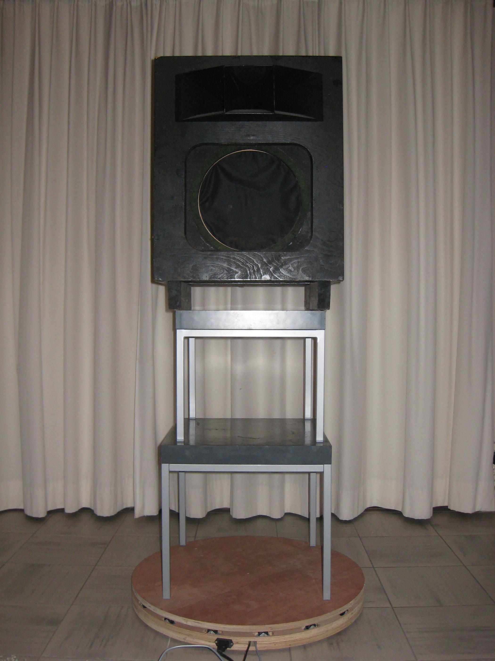

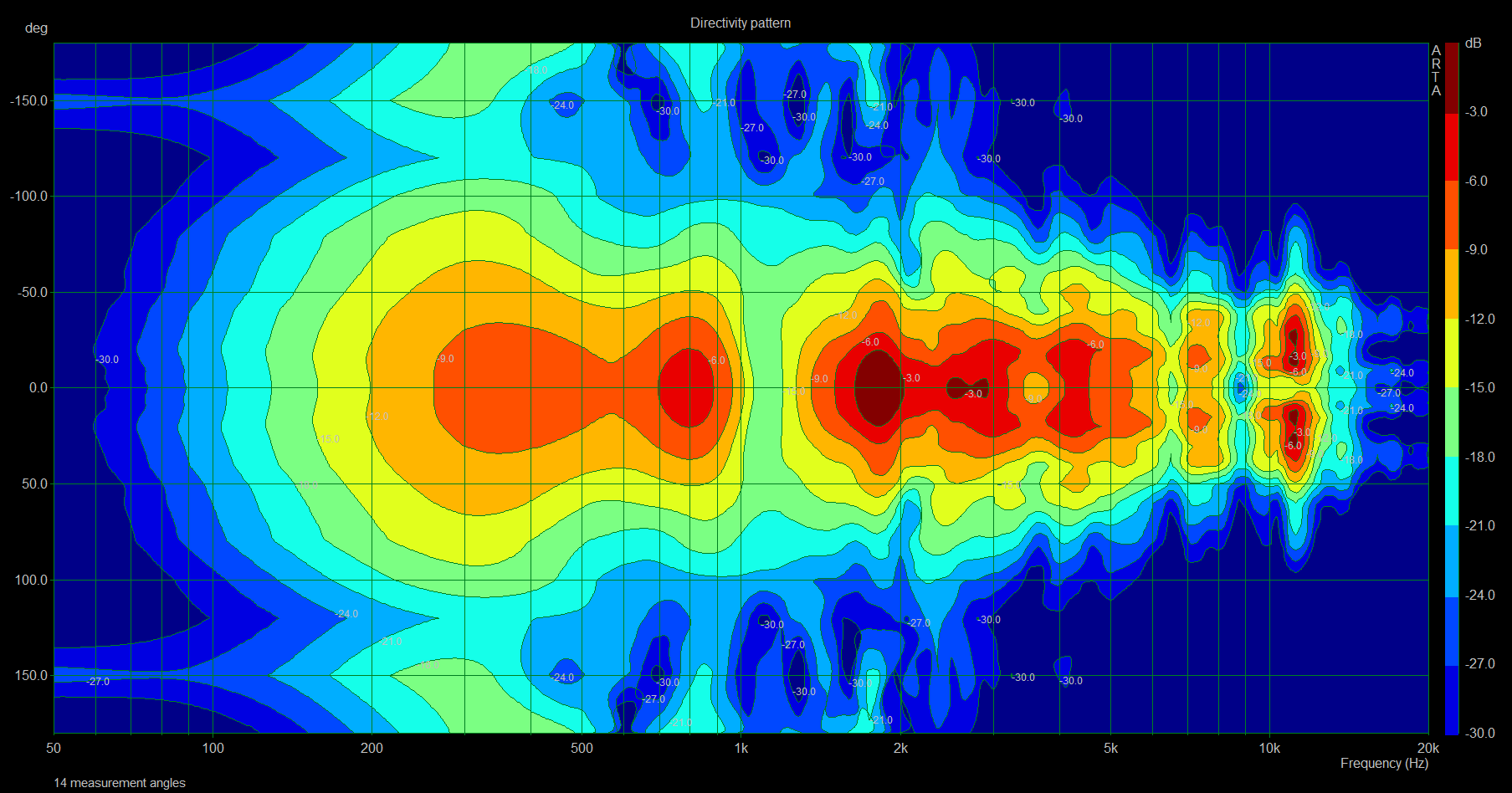

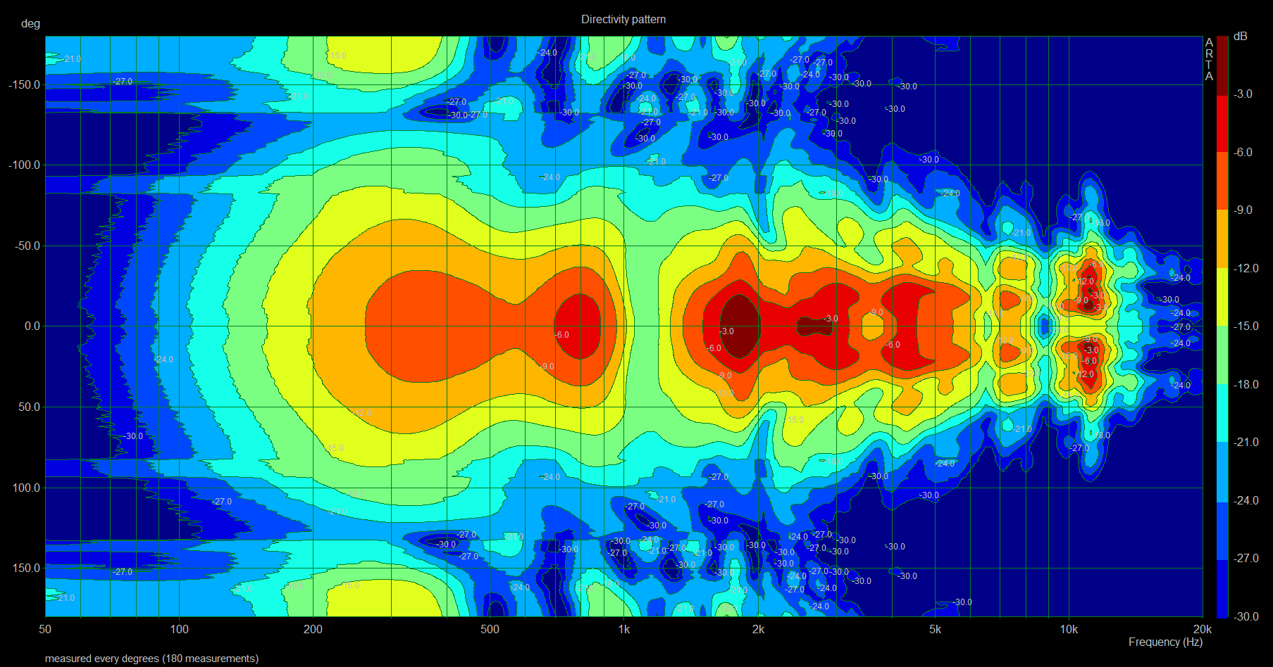

Here is an example of a "bad" speaker (at least when you look at the polar plot). It is a classic Vitavox Bitone 3200 speaker with multicell horn and original crossover.
I again measured this speaker with 14 measurement angles (ala Geddes), and once every degrees (180 measurements). The 14 measurement angles I did both in ARTA and in Holmimpulse (export of holm is attached).
Because this speaker directivity is so irregular, there are now clear differences between the 14 angle plot, and the 180 one.
Looking forward to see how wel Dr. Geddes method performs…
What is also clear, it that even a high quality classic speaker (which I think vitavox is), is nowhere near a good modern product.

_wim_ thanks for the new data.

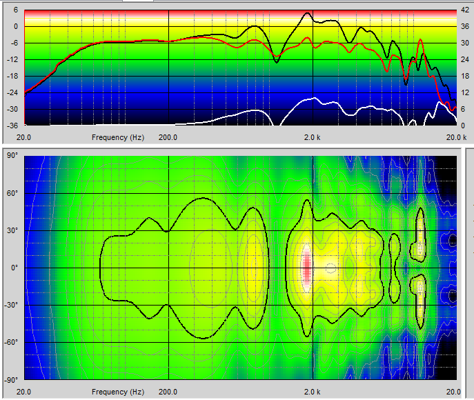

The data gives better results, but there is still what I will call a "ghost" in the off-axis response. When I look back on a lot of my own data I see it there as well. It is not there in the older real analysis. So let me take some time and do two things; 1) resurrect the older real analysis; and 2) see if I can find any bugs in the complex code that I might have missed. I never really looked at the results that hard before so I didn't notice these ghosts. The stuff near the main axis all seems fine, its just at the lower level off axis stuff.

As it stands right now I am not confident enough in the complex data to post it that way. It is curious that the plots that I did for you on the simulated data did not show any of the "ghost" lobes that I find in other data. So it is probably not a problem with the calculations, but more one of the setup and rotation axis.

This is precisely why the real data approach is more likely to be useful, because it is much more robust. The complex approach works well for me, but then I have many years experience with the techniques. The complex approach has some better resolution as the data approaches 10 kHz and above, but is much more sensitive to setup problems. Better a little less resolution and stable data. It is always possible to just add more points to enhance resolution, but I think that what is there now is a good tradeoff between time and resolution.

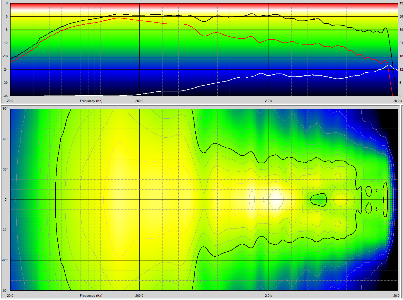

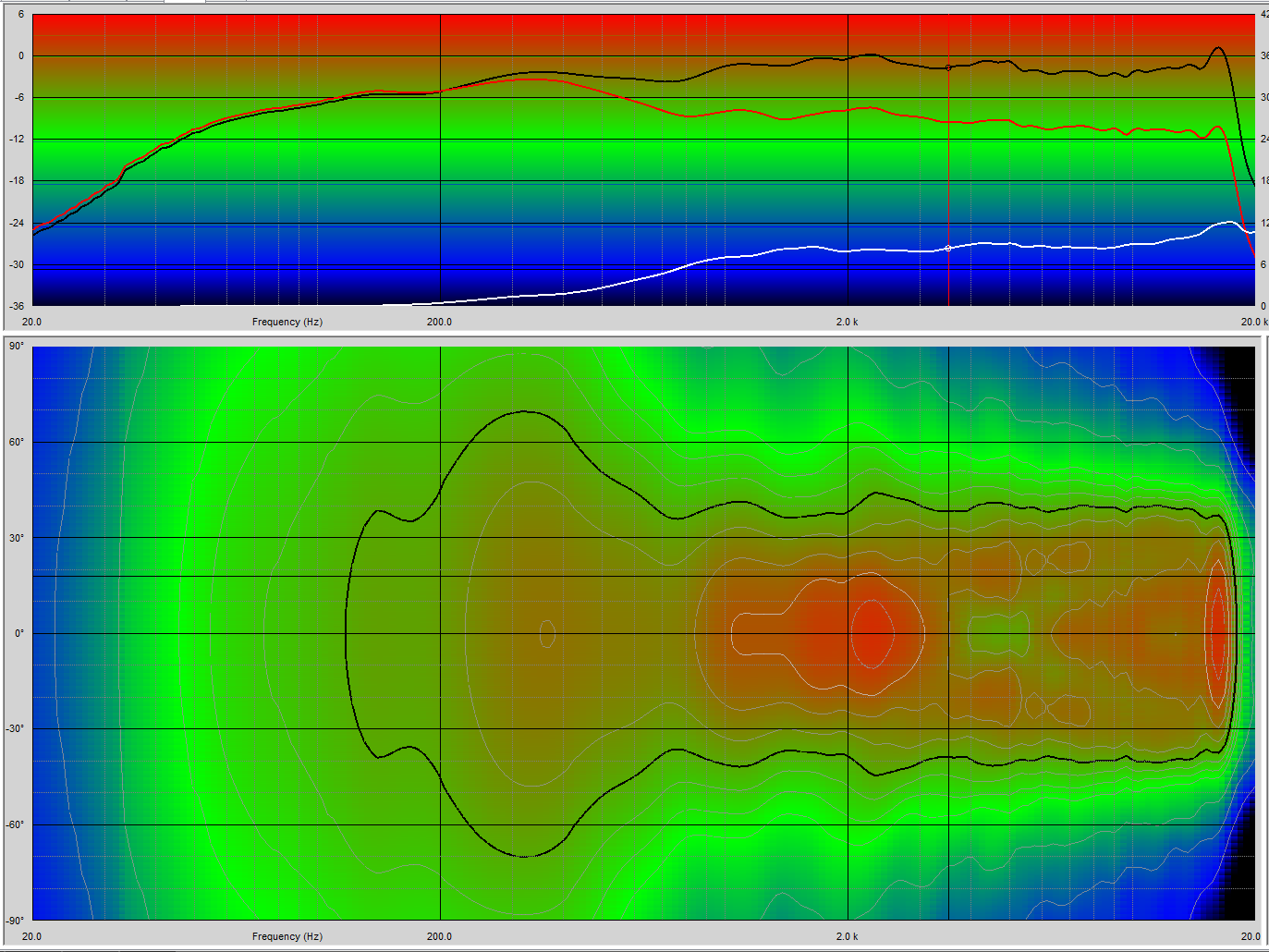

It dawned on my that all I had to do was make the complex data real just before the calculations and the fact that the calculations were done complex should make no difference if the data is real. In other words there was no reason to use the older real based subroutines, just make the data real. So I did this with a simple switch.
Below are the results - complex on the left. Just as expected with older data that was not carefully time synched, ghosts show up off axis. The real data does not do this. The differences can be seen, but for the most part the real data resolution is just fine.
The complex analysis does improve the use of two drivers in a crossover simulation, but that is not what we are talking about using here.
So real it is from here on in for any publicly displayed data.

Looks ok for me. Still need to adjust myself a little to the color-code used, but that will come when I frequently look at the hopefully very big database…
...Just as expected with older data that was not carefully time synched, ghosts show up off axis. The real data does not do this. The differences can be seen, but for the most part the real data resolution is just fine.
This is good news. 🙂

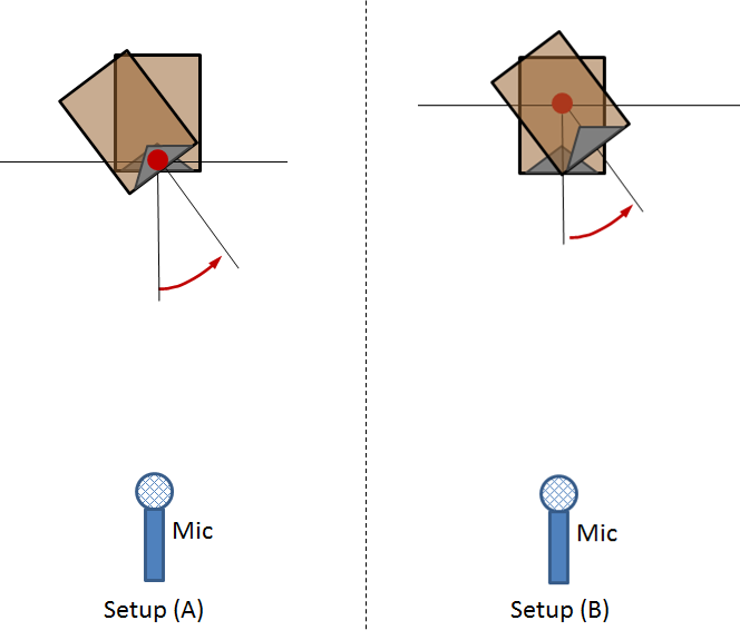

Would you expect measurements taken at 1.5m with Setup (A) & (B) to give essentially identical results?
I'm wondering if the reason the data from _Wim_ has been problematic is because of the short measurement distance in comparison to the size of the enclosure.

"Essentially the same" would be what I would expect in those two examples. His enclosure is identical to what I have been using for years so it is not the enclosure size.
I am pretty certain that the complex would be sensitive to the correct distance from the axis of rotation to the measurement and I may not be calculating this right. I am going to check on that. with real data it doesn't really matter much.
