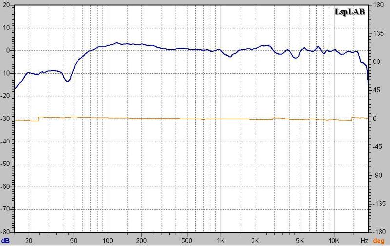

I make a Near field measurement for the woofer and the tweeter with my first order crossover.
I use with a Calculator for merge a curves.
But I have some problem with the measurement...

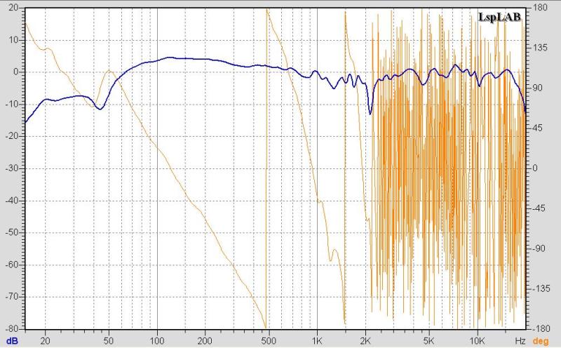

If I use with "Average Curves" calculator and select Complex operation, I have some problem in 2140Hz. maybe is where the crossover is cut between the woofer and the tweeter... But if I remove the "V" from the "Complex operation" box, The graph look much better!
Anybody can tell me what is a truth graph?
Thanks for help.
Graph 1: with "Complex operation"

I am not familiar with the software either, but indeed it seems like the "complex" option uses the phase of the signals when making the combined curve, just as in real life.
Both the name on the tick box and what happens indicates that this is the case.
If this is right, I cannot imagine a reason for not having it checked. In fact, I think the checkbox should not be there. The only function it has is to show that the program can do proper (complex) addition of the curves, and to demonstrate how bad (=nonrealistic) it is not to have it.
But maybe I fail to see a good reason right now. Anyone?
Hi
Just to get this right.
All this about check, don't uncheck etc. is a little confusing - phase information is mandatory in speaker design, therefore Graph 1 must be correct.
