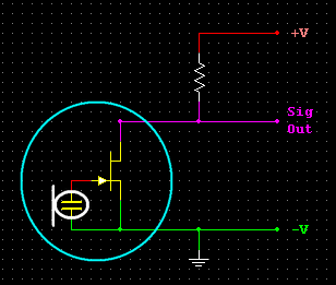

I'm in the process of designing & building a MicPre for testing various sound equipment etc. The mic capsule is a very good & flat response electret type, that i managed to obtain.
It occured to me that, the way they are usually internally connected, as shown, is a two wire one. In which case, i'm not 100% sure if the output is therefore Inverted. Is this correct ? If so i'll make the Preamp inverted to compensate. If it is so, then a Lot of electret measurement microphones sold, are in need of taking this into account !

I actually wonder if they ALL do ? Also Diy'ers might not be aware of it, & will have built an inverted one in error.
Which means there "could" be a lot of mic's & electronics/software out there, showing the wrong polarity !

Dayton UMM-6 is inverted.
MiniDSP UMIK-1 is not.
It all shows up easily the moment you do a sweep in REW and look at sign of impulse function. In which case, click the "invert mic" radio button.

Measurement mics usually invert polarity.
Yes, that's what i thought, & the reason for my thread, so people can now be aware, if they weren't before.
CLIO mic certainly do.
Good to know for people. I download all the PDF's i could find on their www, but couldn't see any mention of this. Can you provide a link please ?

From the CLIO v4 printed manual, page 26:
"...the output of the power amplifier is connected to the loudspeaker with an inversion in cables polarity, this compensates the fact that Audiomatica microphones are phase inverting..."

Without confirming the polarity of the test system, the test system can't be used to determine polarity of the unit under test. It is a simple thing to use a battery and observe the direction of a cone driver, but in the case of a sealed high frequency driver, one can't observe the movement. Each amplifier stage introduces a potential polarity swap, and every pole of a crossover induces a 90 degree phase shift.
In the case of a "Tapped Horn", polarity is a bit counter intuitive- in a "normal" driver positive voltage to the positive terminal will push the cone away from the magnet structure, "forward". In the TH the driver is generally mounted with the magnet outward "forward" , my initial thought was to reverse polarity on the driver, wrong choice- most of the output exits through the "Horn".
In my initial TH testing, the polarity vs phase issue was further compounded by a plate amplifier which had a swapped polarity between the exterior panel Speakon connector and the rear snap connector to pigtail, an ambiguously labeled polarity switch, and a test microphone that was wired counter to the usual leading portion of the wave front at the front of the microphone resulting in a positive voltage on pin 2 and negative voltage on pin 3.
The serial combinations resulted in hours of fun determining the problems- I now have a pin 2/3 swap polarity reverse cord attached to the RTA 420 microphone, as the circuit board XLR connection would make an internal "correction" near impossible.
The suggestion of comparing the test mic to a dynamic mic is made a bit more difficult in that although the usual leading portion of the wave front at the front of the microphone should result in a positive voltage on pin 2 and negative voltage on pin 3, there are many exceptions, and a dynamic mic output lags in phase response compared to a condenser or back electret mic.
