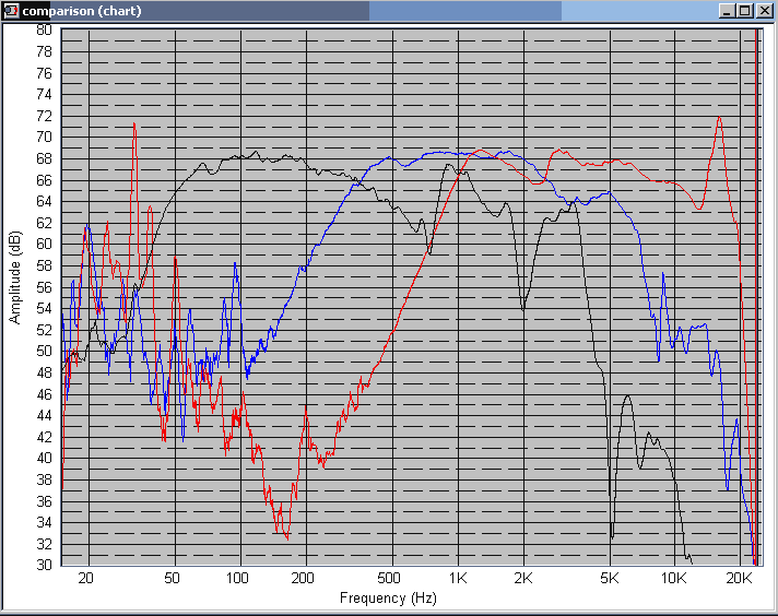

Below is a screen grab from in speaker workshop. I tested each speaker in the box individually with no crossover (nearfield), applied 1/16 Oct smoothing, scaled the results so that they were all around the same sensitivity then added each data set to a graph. As you can see the drivers aren't really suitable to be used together. when I measure the whole system, there are big dips at 500Hz (first xover freq) and again at 2Khz (upper xover freq is 3Khz)...... edit: all with the mic connected to the audigy's mic input.
The thing I find most strange is that they still sound quite good regardless..... I may change that opinon once I build my next set 🙂.
Tony.

Once I tried using PC mic with Speaker Workshop, but I failed.
Since you did it before, would you mind explaining how to do it, step by step?
FYI, I connected the mic to the sound card mic input and then started the near field measurement, the result showed something like noise with +1dB gain only.
Is it too bad using PC mic just to know how is the speaker response in real life?
thankyou.
Chris.
Hi Chris,
The pc mic wasn't as good, as the one I have now but it certainly was better than useless. See the first post in this thread: http://www.diyaudio.com/forums/showthread.php?s=&threadid=23465&highlight=
I didn't do anything to special, apart from play around with the settings under options settings acoustic. I'm using the left channel with none for the reference (the none for the reference is the important bit). If I didn't do that I got a completely flat freq response (I think because the mic is wired to both channels, so the measured response, and the reference are identical). This might be your problem, not sure from your description. Actually I just re-read what you said, and it sounds like what you get if you have no mic connected at all, if this happens again, try the same measurement without the mic attached, if it's the same, then your mic isn't working (could be a number of things, from incorrect channel, to not having it correctly selected in the mixer control).
The other thing I would suggest is just using some sort of sound recording program (usually something comes with the sound card) and make sure you are getting something out of the mic by simply recording your voice or something, so you know the mic is working properly before trying to measure the speakers.
Also as a word of caution, it is possible to get carried away and start worrying that the results mean something awfull.... see what I said here: http://www.diyaudio.com/forums/showthread.php?s=&threadid=23855&highlight=wintermute
I was basically using completely the wrong methodology as I was going in too quick without thinking about it properly (or researching first).
The measurements that I showed in this thread (ie the nearfield ones) are much more enlightening as to what is going on with my speakers. Note that there are still some nasty drops (especially the one at 1.2Khz) if I do 1M farfield measurements, but I think these are probably due to baffle diffraction effects, or room effects.
Tony.
edit: Oh and one other thing, when doing nearfield (especially with tweeters I found) don't have the volume to loud or it will overload the mic, resulting in a very "hairy" response curve.

I set the reference to none and I got Nearfield response around 80dB, but the graph still like hair comb from 20-20KHz! Then I smoothed it with 1/2 octave and now I got roller coaster graph!:scratch:
Any other thing on SW should I check?
Chris.
Hi Chris,
I'd say that your output level is too high, and you're overloading the mic. Try turning the volume down a bit and the comb effect should go away. (I had the levels very low, so low that if you were more than a few meters away you wouldn't here it).
Another thing I read yesterday (was for Just MLS software) was that when doing nearfield measurements on woofers you should drop the sampling rate to 8Khz. I guess this makes sense as you don't really need to sample higher than 4K for a woofer. would mean it's not trying to reproduce high freq's either, which would be more like the situation with a crossover, and also means more resolution in the freq range you are interested in.
If you get rid of the comb (by turning down the volume) then try using the smallest smoothing you can get away with (I used 1/16th octave), will give you a more acurate idea of where the dips and peaks are.
my woofer and Midranges freq curves, earlier in the post look reasonably smooth, but are not what I would call flat... Look at the tweeter resonse curve, now that's a rollercoaster!
The mid and woofer are both reasonably high quality units, the tweeter is cheap (the woofer is a vifa M26WR-09-08 10" (about $230Aus each, 6 years ago, although I got them at 1/2 price) and the mid is a Phillips AD02110/Sq8 Dome mid which cost about $80Aus each, around 10 or 12 years ago.
Note that the curves I posted here were with the new mic, and I think that they are quite a bit better than ones I previously did with the computer mic, part of your rollercoaster could be the mic, especially in the higher freq ranges.
Finally, are you disconnecting the other driver(s) while testing the particular driver you have the mic positioned in fron't of? The graphs I showed above were with all drivers disconnected, and no crossover, ie driver being tested connected direct to amp, still in the box though (another reason to use low levels, esp with the tweeter!)
Tony.
Another point about doing near-field- make sure that the mike is really, really close to the woofer. By "close," I mean like a few millimeters. And don't trust the measurement past a few hundred hertz. Good midrange and treble data can only be gotten with quasi-anechoic (e.g., measuring at 1 or 2 meters and truncating the impulse response just before the first reflection) or with ground-plane (ditto).
Hi SY,
I wondered about that, My mid's response even when I pull back to .5M is nowhere near as flat (even using gating like you suggest) as the nearfield test. I thought it was baffle diffraction, but then I measured it in free air and still had a nasty dip at 1.2Khz and then at each harmonic after that. I started thinking it was the face plate of the mid itself (It's square) which was causing diffraction effects.
Is this why you say nearfield is only good for woofers?
Tony.
Hi Tony,
the near field top useful frequency range is given by the formula: 10950/d , where d=driver diameter in cm. So if you take a midrange that has a diameter of 11 cm., the Fmax=10950/11=995 Hz. Sometimes it is a useful, sometimes not, depends on the system.
To calculate the driver plate resonance, just do: 345/2d , where d is the plate dimension in meters.
Hope it helps.
Claudio
