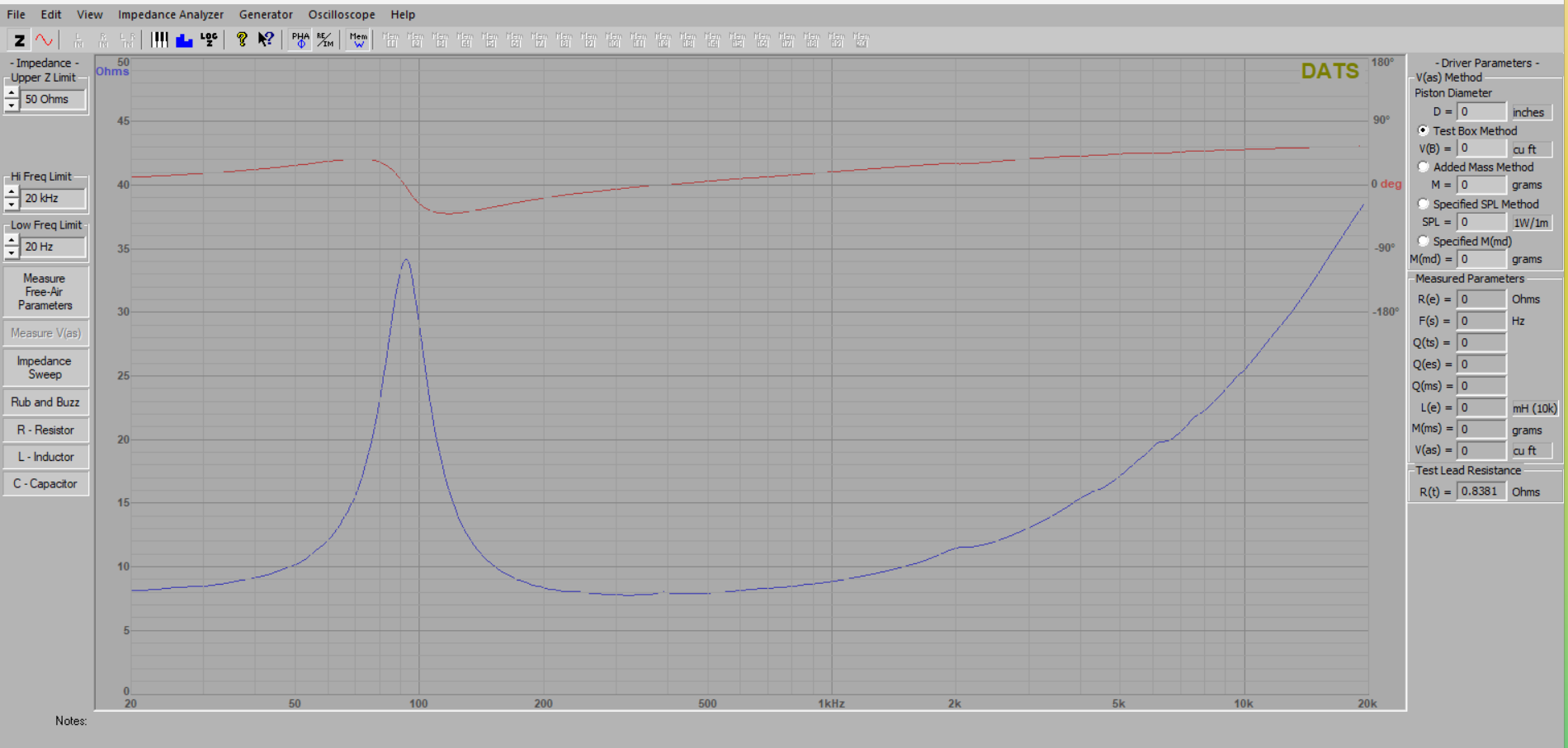

However, after your subsequent posts, I'm much more interested in finding out what is causing the strange impedance curve. I have left two out of six mounting screws off a midrange before and saw the leaky box show up in the impedance but it was nothing as severe as you show.

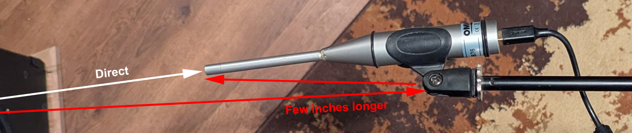

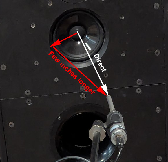

We see a clear reflection at about 3,4ms. However, there’s also one at 0,5ms. Which most likely is the mike clip reflection…
For the reflecting surface at 3.4ms, there is something about 1.7 feet from both the speaker & the mike.
For the reflection at 0.5ms, it will be something that is between 6" to 3" from the speaker or 6" to 3" from the mike.

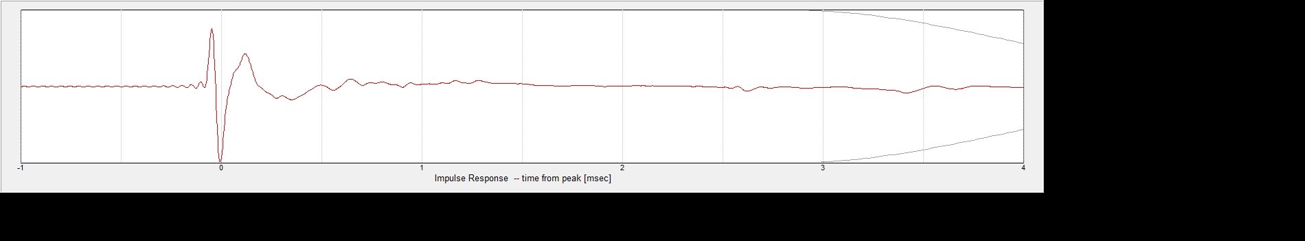

Ok so I think I found the culprit to the reflection as being the floor. I put a poofy pillow on the floor and the "bump changed in size and timing". Also I have been playing with driver polarity and here is a system impulse. looks cleaner, however how do i tell which driver is which? I suspect the tweeter first, then the woofer then mid? do I want to change any polarity of any drivers?

The blip timing only tells us how late the late wave was (or equivalently the extra path length taken), not necessarily where the reflecting surface is located.
