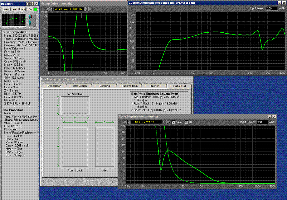

I would like to build a closed sub-woofer with the following.
1 Peerless XLS 830452 and 1 Peerless Passive Radiator 830481
I believe that the enclosure I would be looking to build would be a 1.24 cu. ft. I would like if I could get some more measurements to put this together.
I will be running 2 x 200W RMS (ADCOM 5500) throught a DBX Processor.
Would appreciate any help with this.
