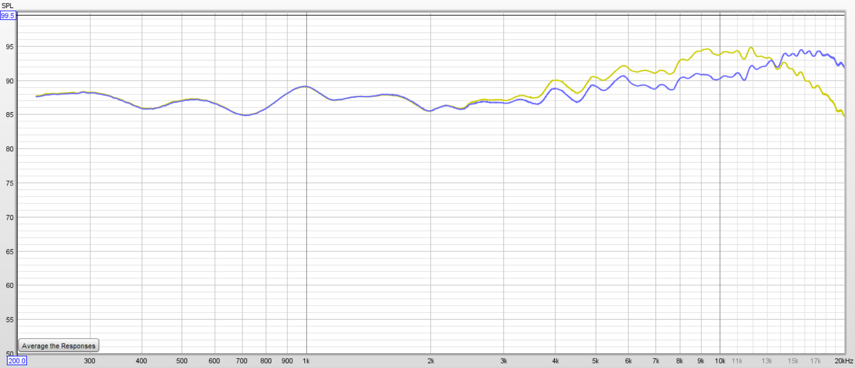

Today I repeated all measurements. This time I started by comparing the amp I used before, a cheap TDA7498E board I got fro aliexpress, with my Denon DRA700AE amp. This is the result of the finished speaker measurement:
(Because the measurement is gated, with a 4.5ms window, the response below 222Hz is removed.)
Quite a lot of difference. I didn't use the Denon amp before because it's much more bulky and harder to move around. I expect the TDA7498E amp is sensitive to varying impedance loads, which could explain the (rather puzzling) difference between modelled and the real-world crossover I saw before.

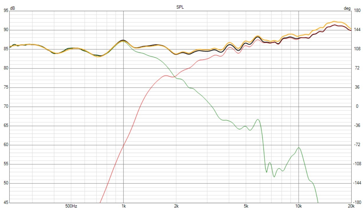

Next I imported all the new Z and FR measurements in VituixCAD for the original crossover, and loaded the measured response of the finished speaker (incl. crossover) as an overlay. To my satisfaction, they overlap pretty nicely:
The orange line represents the measured response, the black one is the modelled response. Up high the measured response is about 1dB off, but that's not much of a concern to me. In conclusion I learned two things. The first is that a decent amp is needed if you want to make trustworthy measurements. The second is that Z-offset correction is still needed, even if a loopback reference is used in REW.
If our measurement technique is perfect, in theory, the measurements will fully capture both the time-of-flight and the phase of the drivers. No further z-offset will be needed... However, in practice there is almost always some errors that are introduced. I almost always need to empirically fine-tune the delay (or z-offset) to get simulation to match measurements.
Nicely done... you had several measurement issues to resolve, and now it all looks good !
