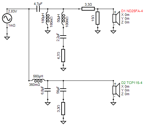

I just finished measuring a completed speaker, and am somewhat surprised to see that the measured response of the crossover is quite different from the modelled response. This is the crossover:

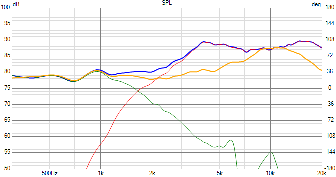

And here is the response:
(I know the response isn't pretty either way, but that's besides the point right now.)
The orange line represents the measured response of the complete speaker, the blue line is the modelled one using raw driver measurements (all gated farfield measurements with a 4.5ms window). Up to around 2.5kHz the lines are quite similar, but in the higher frequencies not so much. I am 100% positive I did not make a mistake in the crossover assembly. Measuring equipment was a Behringer UMC-22 audio interface (with loopback for reference in REW), a Dayton EMM-6 mic, and a cheap TDA7498E amp from aliexpress.
What am I doing wrong here?
I have attached the FRD and ZMA and VituixCad files.

Thanks. But thats exactly what I did. The blue line in de graph in post #1 shows the response of the modelled xover, using the measured response of the individual drivers without xover. The orange line shows the response of the complete speaker, including the real-world xover based on the modelled one (1-on-1).

I threw your crossover and files into XSim and matched your simulation results, so that's not where the problem lies, So I would look at these areas:
1. Double check your crossover wiring (especially the tweeter circuit) and verify all component values (especially the L-pad resistors) match the simulation values.
2. Double check how you do measurements. One thing I noticed was that your measured raw responses for the TCP115 and ND25FA show a difference of a little over 15 dB. Dayton's IB measurements show a difference of a little less than 10 dB. The mic distance and amp setting have to be identical when you do the raw and with crossover measurements. I assume the tweeter is your design axis.

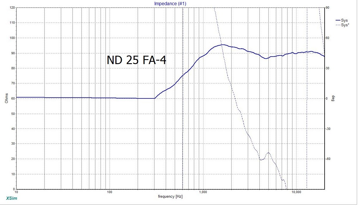

Your tweeter pretends to be a 90 ohm unit. Tweeter zma file is filled with spl data.
Thanks for spotting that! That was also the case for the TCP115 (midbass) Z measurement, which is why I updated the measurements in post #3. I'll come back with a new Z measurement for the tweeter as soon as I can.

Using an older tweeter Z measurement from a year ago the blue (modelled) line is way more linear (as intended). Still deviates a lot from the total system measurement though (orange line in post #1).
