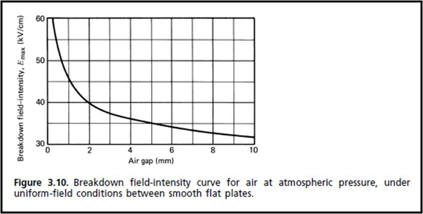

If you haven't read it already, Section 3.2.9 of Baxandall's chapter on ESLs derives values for Vbias and Vstator to maximize ESL output.
What limits the efficiency of ESLs is the the breakdown voltage for air. He uses a value of Emax=4kV/mm for dry air, although it varies with D/S spacing(see attachment).
For a given diaphragm spacing d, the optimum Vbias and V(stator-stator) are:
Vbias = Emax x d / 2
V(stator-stator) = Vbias x 2
The reasons this is so is because the force is proportional to the product of the two voltages, but the break down is based on the sum of the two voltages. For example, suppose the airgap can sustain 10kV, and Force(for illustrative purposes) is just the product of the Vbias and Vstator.
Vbias...Vstator…Force
0...........10...........0
1............9............9
2............8..........16
3............7..........21
4............6..........24
5............5..........25
6............4..........24
7............3..........21
8............2..........16
9............1............9
10..........0............0
You can see that if we are limited by 10kV across the airgap, we get maximum force(peak SPL) before breakdown in the airgap when we set Vbias= 5kV and apply 5kV of audio signal to each stator.(out of phase of course, so Vsig=10kV from stator to stator)
Note that if we increase Vbias about 30% above this “optimal” value, we pick up +3dB in sensitivity while losing only -1dB in maximum SPL output capability. I have found this to be a good trade off and generally operate my ESLs 20%-30% above the “optimal”. Increasing much above this and dynamic range starts to suffer. FWIW, Quad ESL57 and ESL63 are both operated at the “optimal” Vbias levels.

I guess my Question is that if the ionization of the air is what limits our Peak SPL, can the efficiency still increase as long as we can contain the bias voltage without arcing when it is raised?
Ionization/conduction of the air results from exceeding Emax(the critical field strength) for air at some point in the air-gap between stators. Adding insulation does nothing to change this property of air. Typically we think of the electric field between the stators as being uniform, but there are definitely hot spots around sharp edges in stators and this is where the ionization starts. Insulation added to perforated sheet metal stators will reduce the field strength around these sharp hole edges. This allows you to apply higher bias and stator voltage before exceeding Emax. However, adding PVC heat-shrink insulation to round rod stators does not significantly modify the field strength around the stators and as a result the air begins to conduct at essentially the same voltage with or without insulation. The only difference is what happens when the conduction starts(ie arcing/sparking for un-insulated, corona discharge for insulated)
Note that depending on the bulk resistivity of the insulation material, you may lose some of your applied bias voltage across the insulation.(see Attachment#2 of post #23 for more details)http://www.diyaudio.com/forums/planars-exotics/264972-measured-my-esl-attempt-3.html#post4140681
This can confuse things because you may be fooled in to thinking you are applying more bias voltage across the air-gap than you actually are.
The best way I have found to confirm what is going on is to build an un-insulated stator panel with the same stator dimensions to compare SPL output against your insulated panels. Lower SPL is a direct indication of how much voltage is being lost across the insulation. This would tell you how much to increase your applied bias voltage to achieve a desired voltage across the air-gap.
I have made it to 12kv with some leakage starting but it ran and it was even more efficient.
But can we take it to say 15Kv or even 20kv or so of bias and get away with only using like 100v to 400v of drive signal or less and still have an ample amount of SPL?
First, running the bias voltage high enough to ionize the air in the gap is not a desirable situation for your safety and the longevity of your panels. The ozone generated is unhealthy for you to breathe, and attacks most materials and coatings...resulting in eventual failures.
If you still decide to run your panels with air in the gap conducting, you will be losing the low distortion properties of constant charge ESLs as the conduction behaves like a soft limiter, producing odd order harmonics. This is often the reason that things sound like they are continuing to get louder, when in fact harmonic content is just being added. This is easy to measure with single frequency tone testing.
The other thing that happens when the air in the gap ionizes, is that its resistance falls as conduction increases. This changes the ratio of the air/insulation resistances and more bias voltage will be lost across the insulation as the resistance of the ionized air falls.(again, see Attachment#2 of post #23) So, once you have reached a point where you are ionizing the air in the gap, you will have progressively diminished returns with further increase in bias voltage.

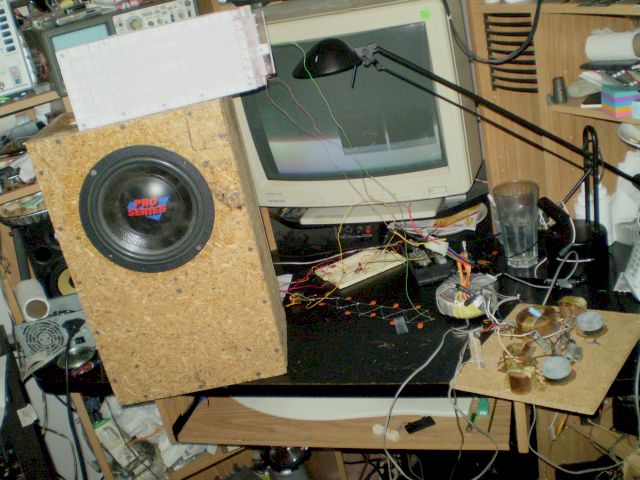

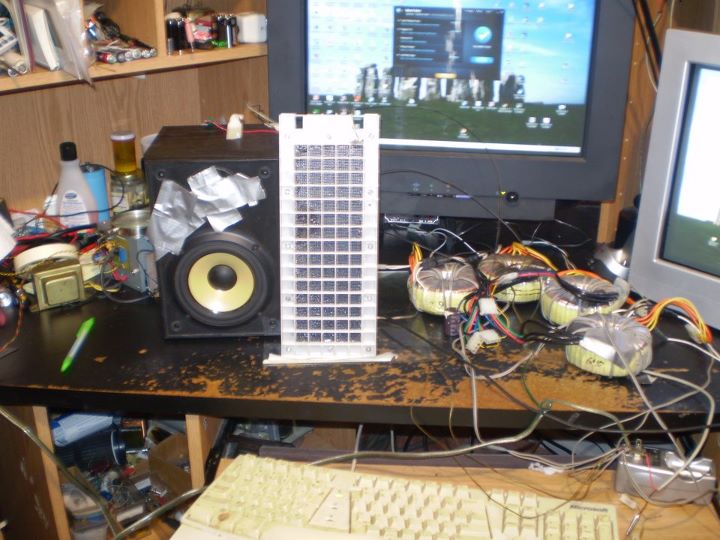

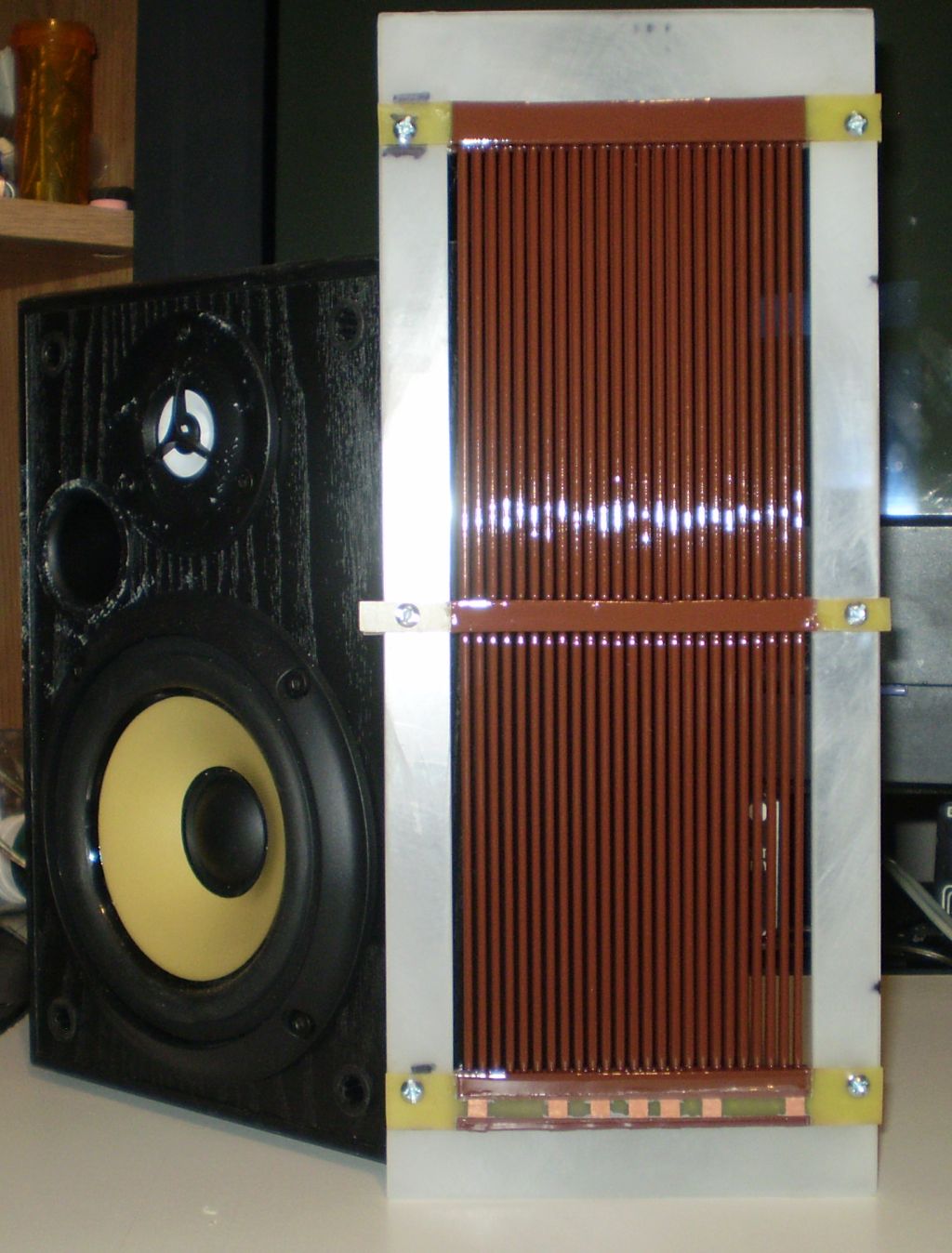

P.S. Here are pictures of the Two main setups I used throughout all of my tests and experimentation's and of course one of the latest build. :)
