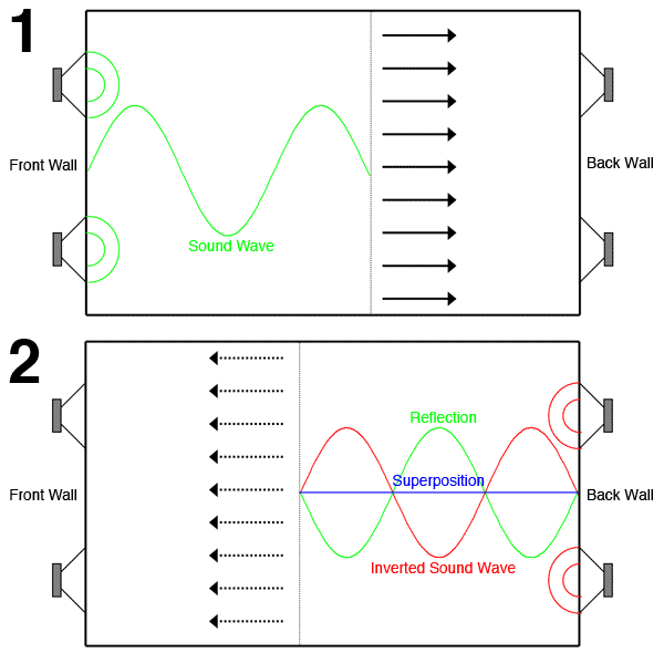

Im certainly not up to speed with the Drs in the house, but this thread got me thinking.
Perhaps i repeat others concepts BUT:
Why not turn the ENTIRE room into a bipole?
If you humour me for a minute, imagine front and rear in wall IB subs, wired push pull.
How would the room behave?
With DSP i imagine it would be simple to tune with delay and or phase rotation. Probably im hand waving frantically and its vague at best, but the thought just occurred to me.
I think John K has a similar suggestion (like the push-pull dipole idea) on his website: DP_woofer_room
A DBA is slightly different, since it has a time delay between the front and back array corresponding to the path length between the two arrays. The front array generates an approximation of a plane wave which is then actively dampened by the rear array when it arrives at the rear wall. Thus it creates a pure travelling wave.
It's expensive and relies very much upon room shape and acoustics in order to function properly, which are major drawbacks. It's not practical in most rooms (although it is very cool 😎).
This "Opposite Phase-Opposite Corner" configuration was tested in the Fazenda paper "Subjective Preference of Modal Control Methods in Listening Rooms" but it didn't work well in a real room while in theory it should. A DBA seems to be more robust even if the room is not ideal.
