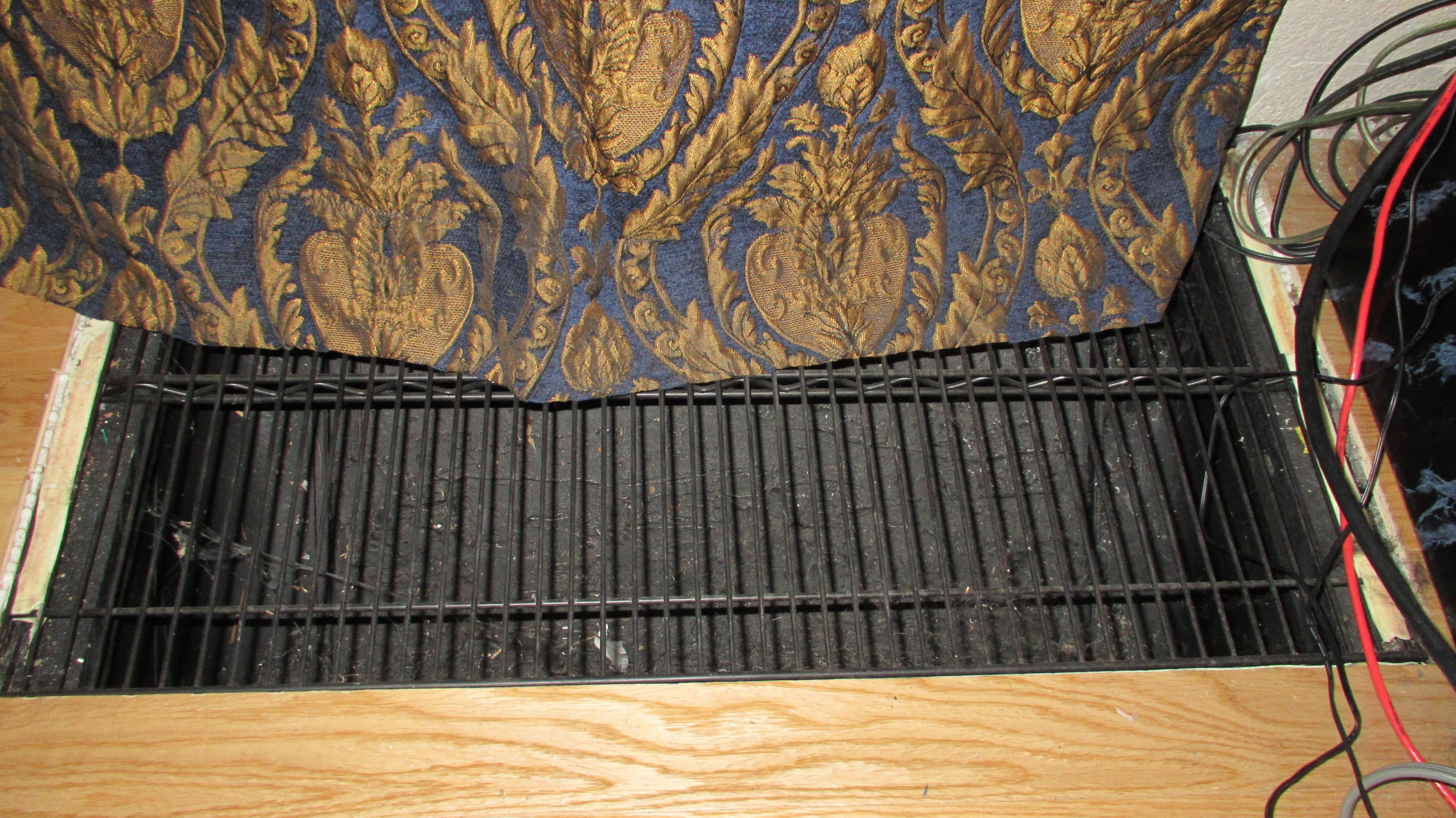

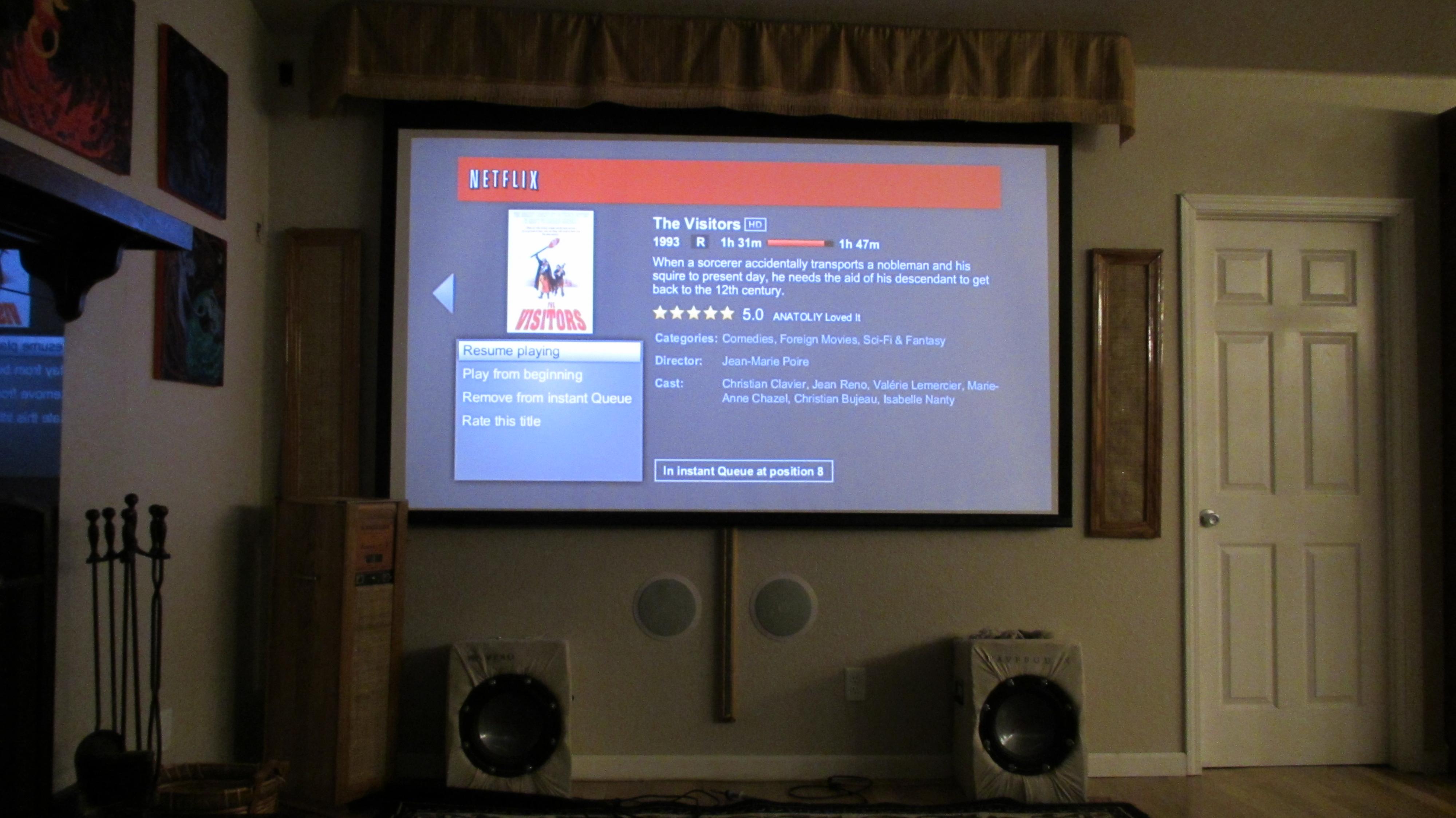

Your system sure sounds impressive :eek:...do you mind posting some pictures to inspire others :eek:
Not at all. But I'm afraid you can't hear pictures.

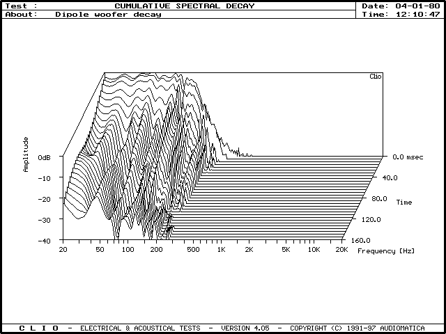

I have one from the dipole setup yes. Woofers only.
The first "ridge" is the speakers alone, and the later and lower in level is the room decay.
It does not look like this at all with monopoles, and there is only one decay "ridge".

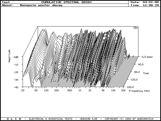

Thank you for posting that.
The response is much more even with the dipoles. Below 50 Hz a shorter decay too, but not much difference and this could change with moving the mic/position some. Above 50 Hz the decay is shorter with the monopoles. Are the subs crossed low?
But here's something that makes me wonder about the measurement with the monopole. You have a resonance at around 5kHz that's about as strong at the one at 50Hz. Considering you have a very dampened room, this shouldn't be so.
Disabled Account
Joined 2008
The difference is not what it seems, because the overall response from the monopole is uneven, and this affects the level of the decay as well. It may look like the decay is lower, but this is only because the speaker level is also lower. It would have been easier to compare the two if the monopole was EQ'ed to a flat response.
One other thing is that the dipole room decay starts at a level 15-20 dB below the speaker, while the monopole starts at the same level as the speaker.
