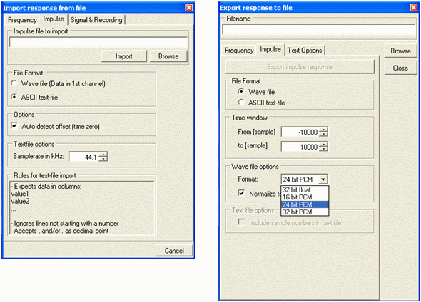

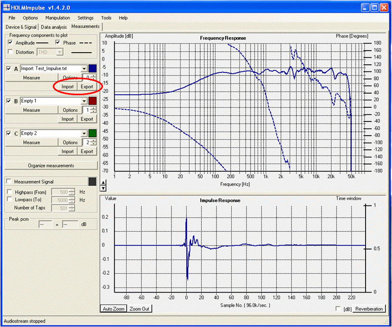

I am planing to do a comparison of monopole (sealed), dipole and cardioid in the same room assuming I can get my impulse files converted to the necessary wav format. I'll also have to learn how to run Elias' code and Octave.
Perhaps the better way to do this would be for me to just email my impulse files to Elias for processing? I still want to learn how to use Elias' code but I'm interested is seen the results. Still I have to set up the woofer systems which will take a little time. I'm a little busy at the moment.
...assuming I can get my impulse files converted to the necessary wav format.
HolmImpulse is very handy for creating *.wav files from tabular impulse files using the Import/Export functions.
One thing to watch out for is the Holm assumes "," or "." are decimal point.
The Holm recognized column separators are semicolon, space, or tab.
