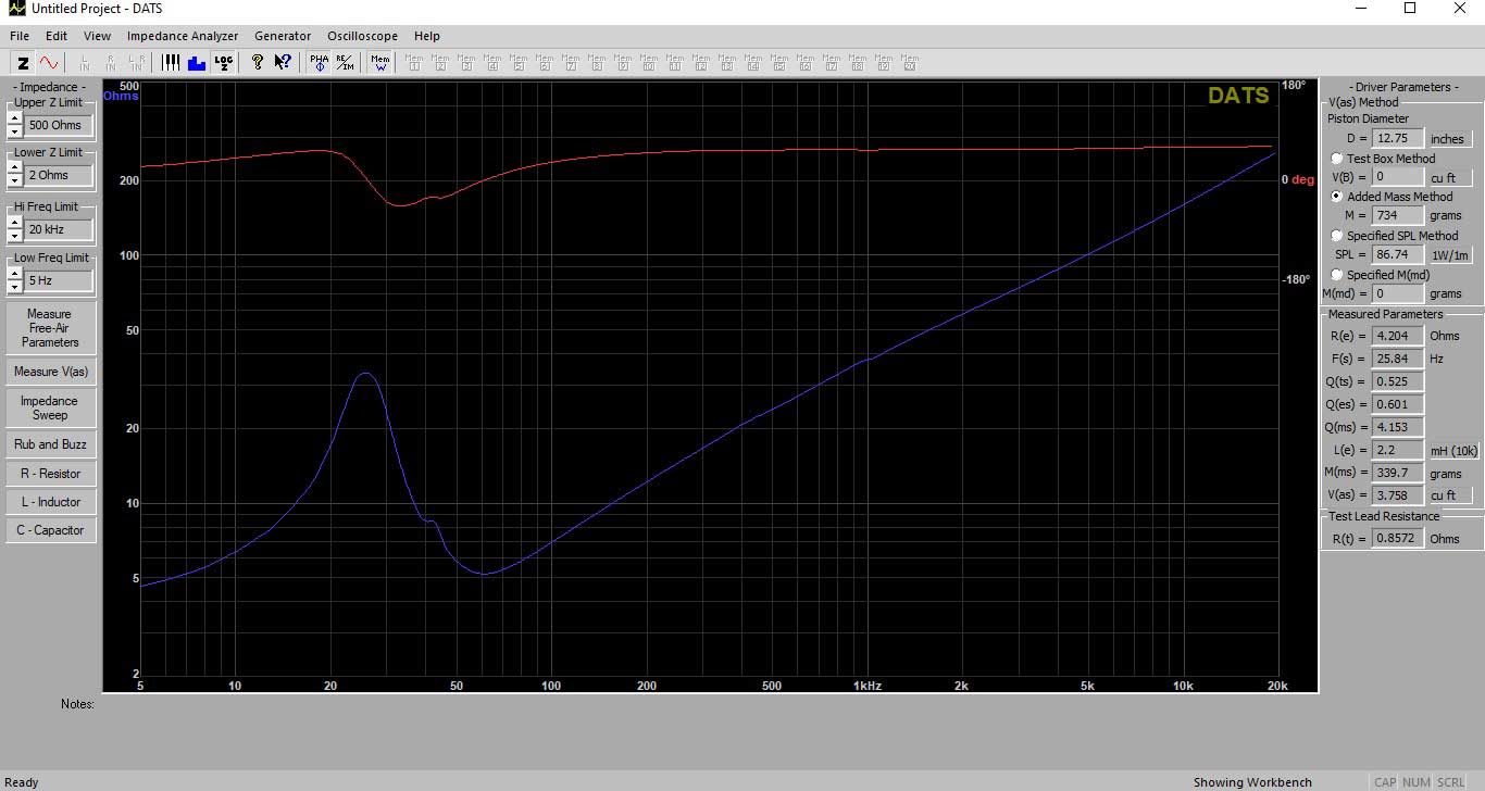

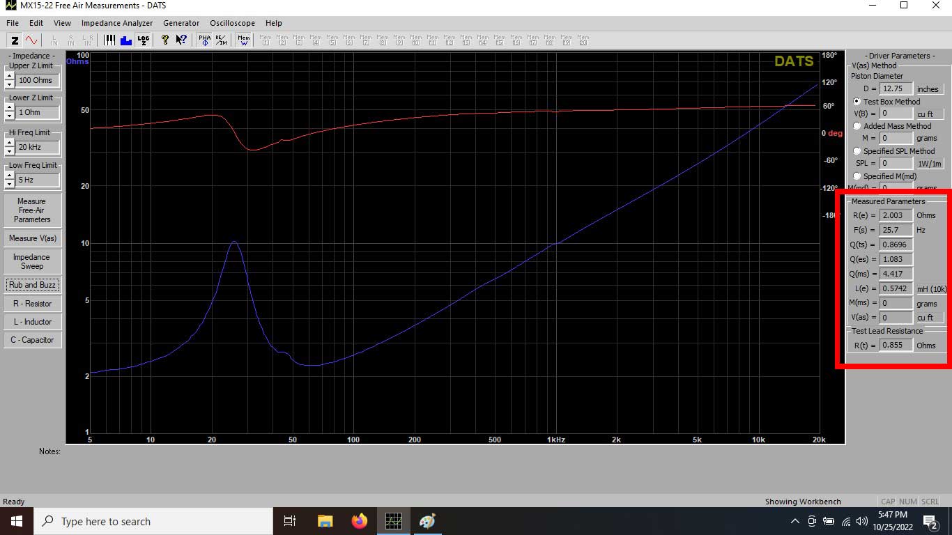

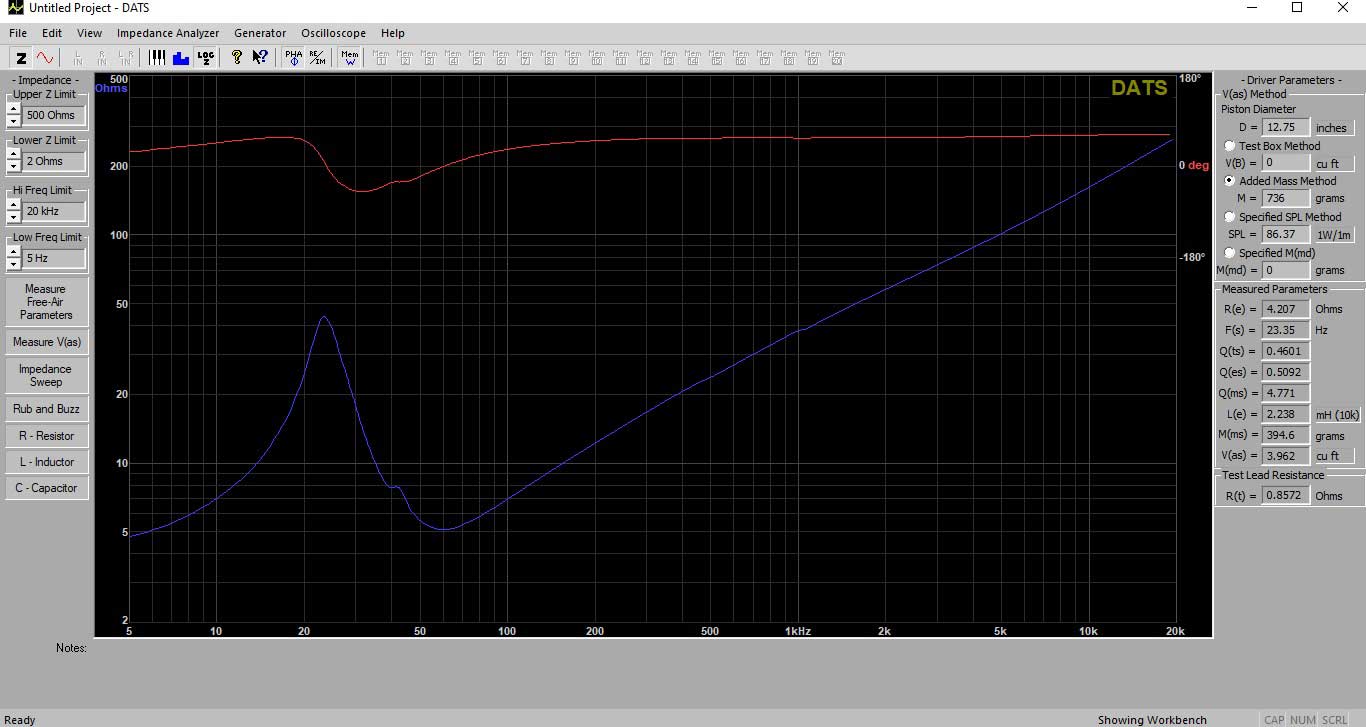

Simple discussion, we often model with the published specs but what if the specs are different? I was measuring a driver today that I was working with and for the S&G's I did the free air parameters measurements after calibrating and I did it both wired as a single voice coil and dual voice coil in series to see if it changes anything significantly. I didn't think much of it. But then I looked at the published TS parameters and they're different. Not wildly different. But maybe different enough that I should model an enclosure for this particular driver based on my measured value or is this too getting into minutia and published values are fine?

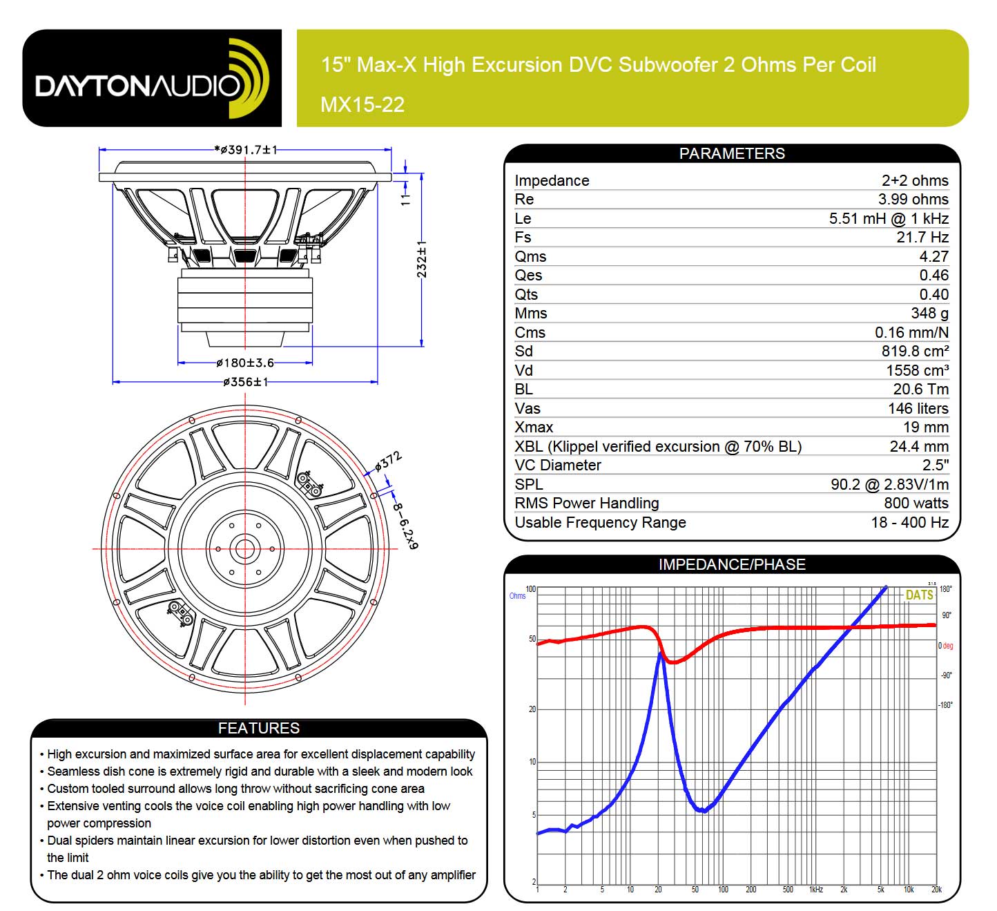

The driver is a Dayton MX15-22.
Here's their published TS parameters:

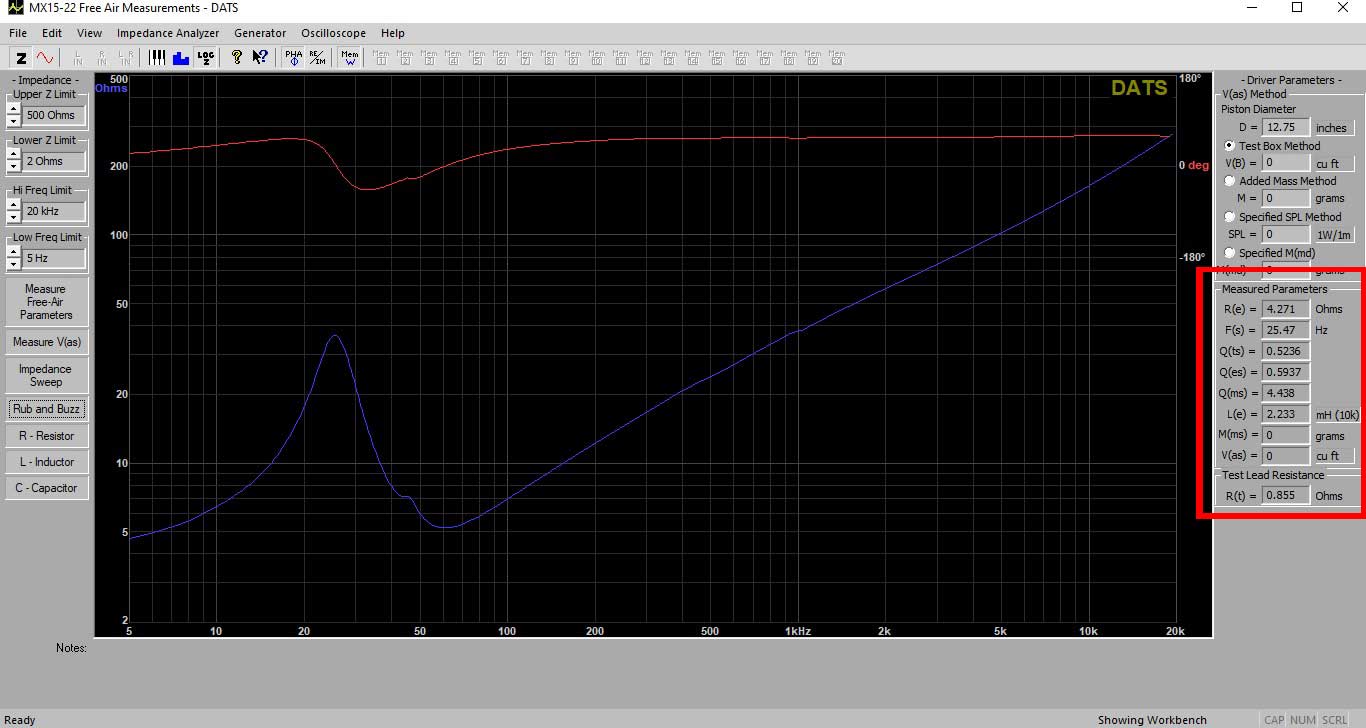

And here's the DATS information I got from my particular copy of this driver (single and dual voice coil in series measured):
I noticed right away the impedance curves are different from the published. Instead of peaking on 20hz, it's right-shifted to 25~26hz or so? The Fs measured at 25.47~25.7hz instead of 21.7hz per the publication. And of course some values are different depending on using one voice coil at 2ohm vs two voice coils in series at 4ohm. I assume I should model using the two voice coils in series' values?
Do I need to input the Vas and do the measured mass here, my understanding is that won't effect the TS parameters already listed with measured value.

Updated with Vas. Here's two different drivers of the same type with their differing specs:
Fs and Qts are fairly different, 16% & 7% difference from published spec on Fs, 26% and 13% difference from published spec on Qts.

Published specs are an average and production values are usually plus or minus 10%.
Sometimes with fast runs and cheap drivers like the Dayton might be +/- 20 or even 30%
Plug each set of paramters into a box program with the same box volume and tuning and see what the resulting graph might tell you. The end products may be similar id not exactly the same
Yet SPL w/m are ~identical, ergo so is eff.:
n0 = (9.7822 * 10-10 * Vas * Fs3) / Qes
SPL @ 1W/1m = 112.2 + 10 * log(n0)
driver #1 = 86.334 , #2 = 86.583, so a matched set and as Fs drops, these will go up closer to spec, so personally would just use the published specs unless shrinking box size was a priority, then recommend designing with either averaging each spec or whichever is the smaller of Fs*Vas*Qts.

Thanks; this is the practical type thing I needed to hear. I figured it was minutia but was curious. I only recently started measuring drivers for fun. I picked up the DATS as a longer term goal to measure drivers in enclosures to build crossovers eventually (not there yet by a country mile).
