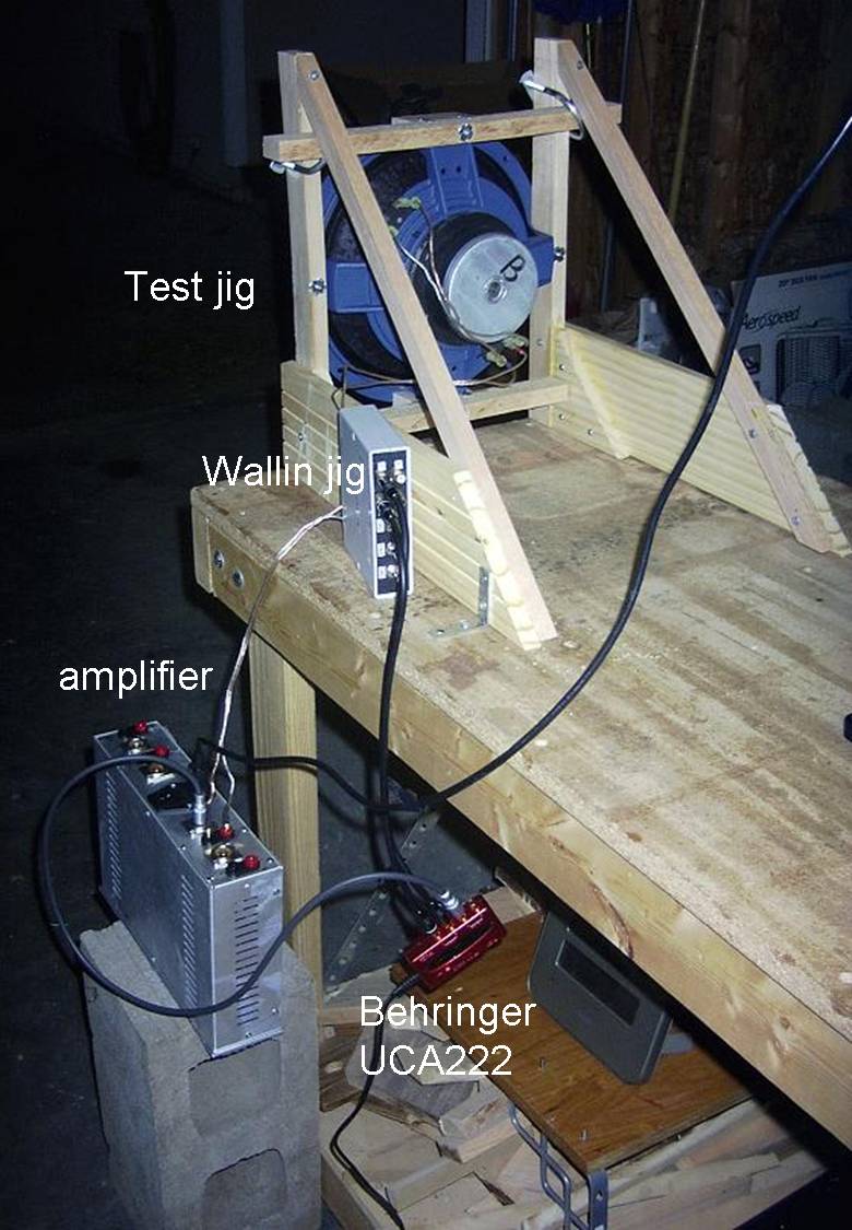

I've been tweaking/troubleshooting my setup for a few months now. Here is what I've settled on and what didn't work.
-Byron
- A PC running Speakerworkshop, available for free here: Speaker Workshop I'm sticking with SW because I invested so much pain & suffering into learning it, I'm afraid to switch to something else. If I were to do it all over again, I don't know that I would use SW.
- A Behringer UCA222, which is essentially an external sound card which connects to the comp's USB port. I settled on this after failing to get SW to work with my on-board sound card, and with a Rocketfish card. SW requires 2 channel recording to use all of it's capabilities. Your comp's soundcard may be good enough to get started with SW or whatever software you choose. The Behringer is also nice because it uses RCA jacks for input and output which lets me use good quality cables. And the long USB cable lets me keep the signal-carrying wires short, yet position the computer further from the driver under test. If I were to do it again I would save a little money with the Behringer UCA202. BEHRINGER: UCA202
- A power amp stable into at least 4 ohms. Theoretically, you only need 1 watt for frequency-response measurements, and a fraction of a watt (I use ~0.3VAC for 8 ohm drivers) for impedance curves. It's good to have a few extra watts.
- A Wallin Jig, which is not available for purchase. Instructions for building one are here: Eric Wallin's Internet Homepage It's not necessary, but is convenient, especially if you want to calibrate your sound card in SW.
- A little jig to hold drivers steady is nice, but not necessary.
- If you want to do frequency-response measurements, add to this a microphone like the Behringer ECM8000, or the Dayton EMM-6. At least 2 people on this forum are using the ART Phantom I phantom microphone power supply.
- Some way to add mass to the driver being tested, and a scale accurate to about 0.1g to measure said mass. Most people use some kind of reusable adhesive putty like this: Elmer's Tacky Adhesive can be Removed and Re-Used | Sticky Tack I've found at putty does not stick well to paper cones, and loses its stickiness after a few uses, so I've moved to small (~15g) magnets. Put them on opposite sides of the driver's cone, symmetrically around the dust cap. Also, I just weighed the magnets once and wrote their mass on them - very convenient.
- Be aware that Parts Express is selling this little gadget: Dayton Audio WT3P WT3 Bundled with Precision Scale but I don't know anyone who's used it.
-Byron
this is great, it also is just a hobby for me, will look into all this, any particular powered mic?So this is my setup.
thanks for a detailed information, I will have to digest this in detail...I've been tweaking/troubleshooting my setup for a few months now. Here is what I've settled on and what didn't work.
