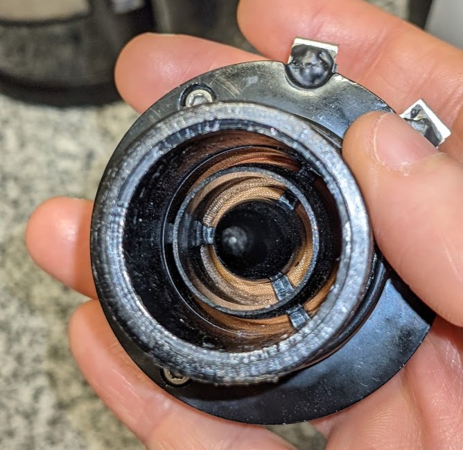

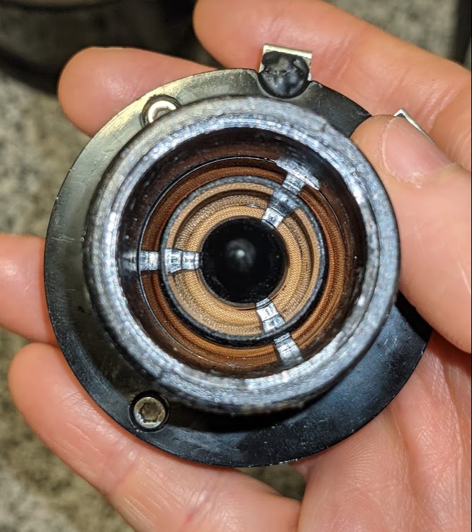

How do you measure a compression driver's exit angle?
I want it to matched to my horn, but I can't find it in my CD's specs.
It's a Denovo Audio DN-250 compression driver, the one that came with many DIYSOUNGROUP kits. It's a threaded 1-3/8 18TPI, neodymiun tiny CD.
No problem if I have to take it apart.
Thanks!

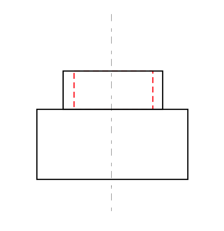

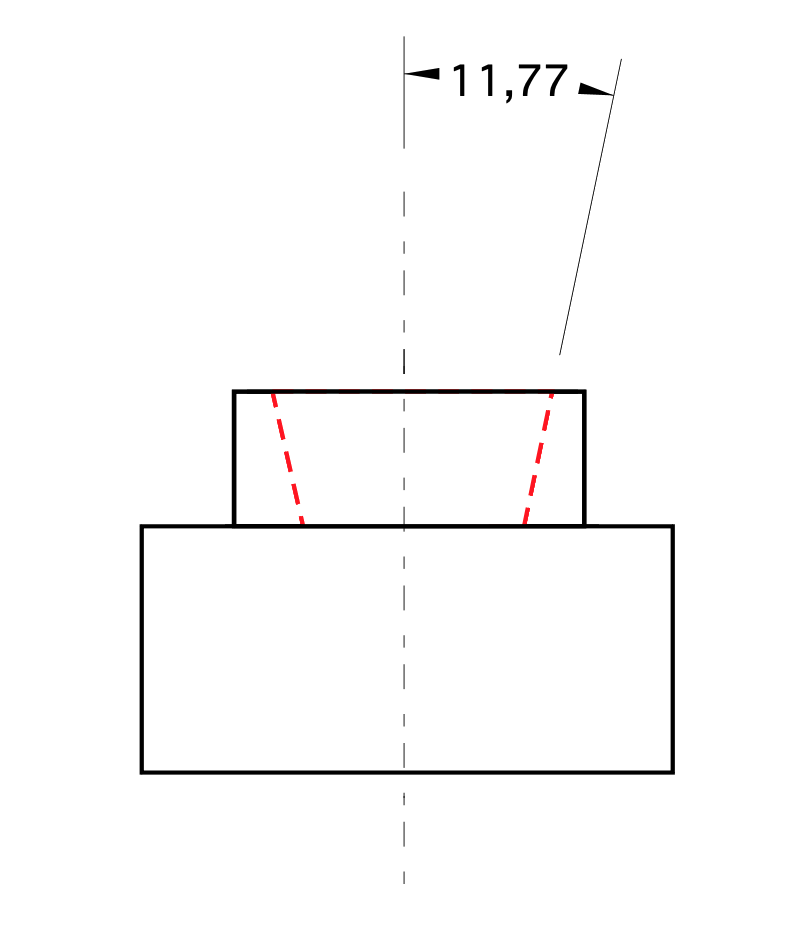

It seems the CD has like a tube as exit so comparing the red marked side walls of that tube and the centerline, they are parallel and therefore your exit angle i zero degrees!? If it had an angle it would look like e.g. pic 2 and it had been 11,8 degrees.
Thanks for the help! At least now I know what to measure.
I am inclined to think this compression driver is just a "tube like" exit... which sucks...
