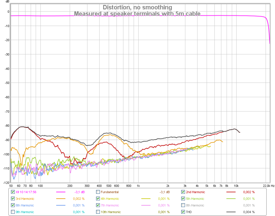

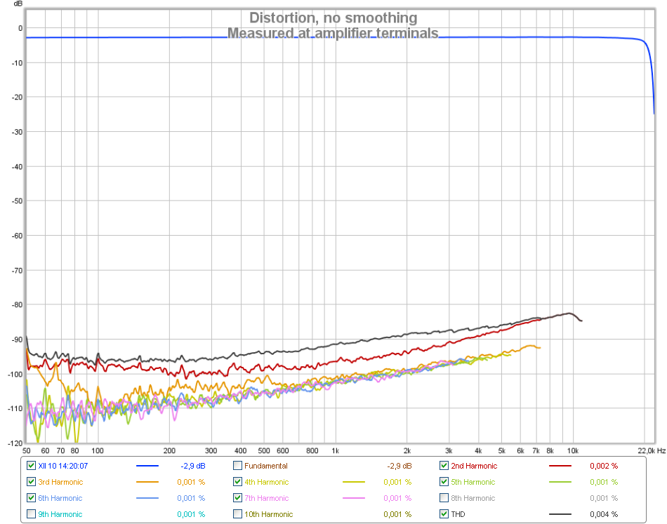

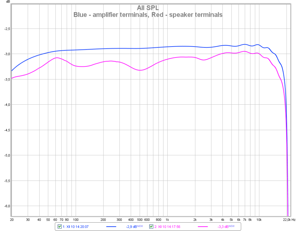

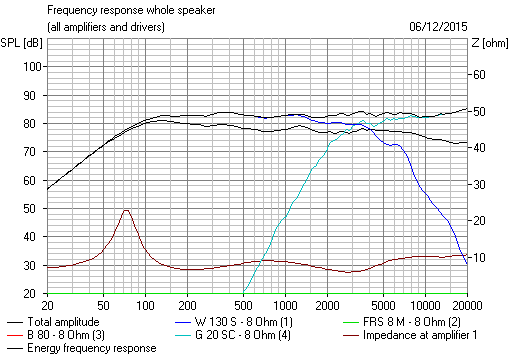

I am attaching measurements that show measurable influence of speaker cable to both frequency response and distortion. The speaker cable is a zip cord with 1.5mm2 cross section area and is 5m long. Frequency response and distortion are measured directly at amplifier terminals (blue) and also at speaker terminals behind the speaker cable (red). We can see that both frequency response and distortion plots are modulated by speaker impedance for the measurements behind the cable. 3-way speaker is used.
The amplifier itself has very very low output impedance. Its frequency response and distortion in fact copy those of the measuring card.

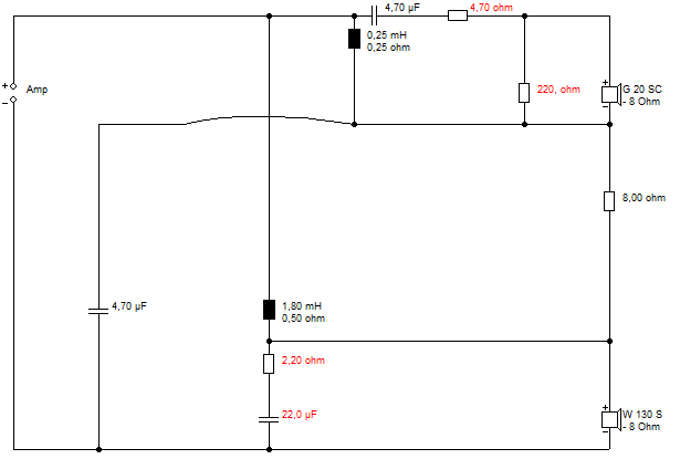

These results are very much inline with the amplifier testing done by Stereophile using simulated speaker loads so it's not that new. What you could do to examine this in more detail is to copy Stereophile's simulated load in XSim, but maybe replace the last inductor with an ideal speaker. Then add a resistance in series with the amplifier.
Not sure if it can measure this low, but you could attempt to measure cable capacitance and inductance with DATS. I'm sure there are better tools for this, or you can find the published specs or measurements online. Some reviewers include this data for cables they measure, especially some Wireworld reviews.

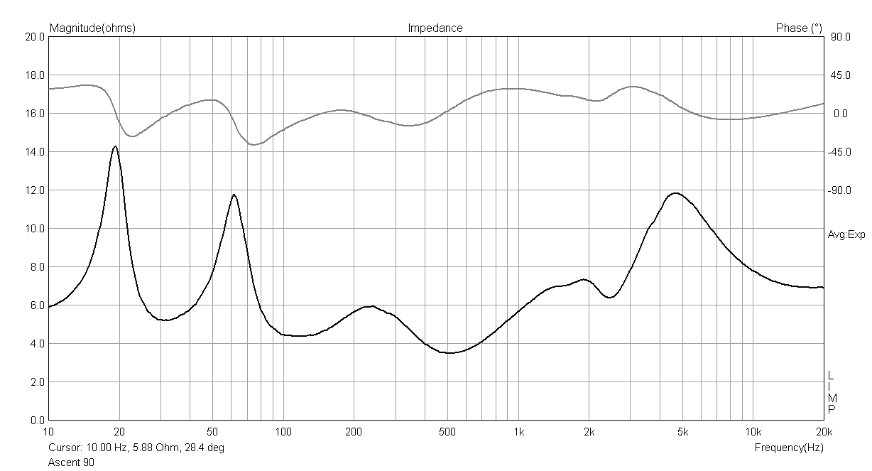

I posted the impedance plot,...
Apparently after I started typing a reply, see it now. Better than nominal of course since deviation scales with impedance.
Any thought on the LF distortion mechanism? The 60 and 120 Hz bumps originally suggested differential chassis potentials but measurements made with a high impedance balanced input arguably handle that. Plus that curious distortion reduction above 200 Hz...
Hi Erik,
though I have not mentioned it, I have used a simulated speaker RLC load for about 12 years, however, I have found quite big differences between real speakers and simulated loads.
Though measuring/simulating of frequency response is in a good conformance between the two approaches, for non-linear distortion is RLC dummy load useless. R, L and C are linear, unless you use L with iron core. BUT, impedance of the real speaker is nonlinear. It is a function of both frequency and amplitude. Z = Z(f,V). The circuit elements of real speaker are non-linear with cone excursion and frequency. Thus, you get distortion of speaker current even if drive voltage has no distortion. This will never happen with linear RLC dummy load. So, RLC dummy load made from discrete elements is a kind of approximation, but it does not describe the reality well. You need a real speaker to make an investigation.
Pavel

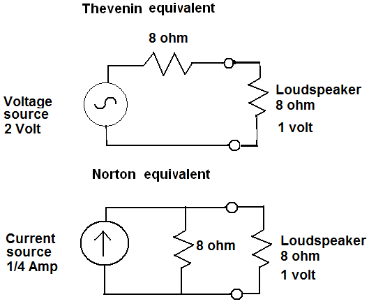

Nonlinear speaker impedance, like explained here
Current drive of speakers and speaker distortion
Lumped elements of speaker model are nonlinear with amplitude (excursion) and frequency (voice coil inductance, e.g.).
Thus speaker current is nonlinear with linear voltage drive. Nonlinear current * cable resistance results in the distortion shown, measured at the end of the cable loaded with the speaker.

Nonlinear behaviour scales with excursion, LF has higher excursion? Sounds like one good argument for active speakers.
Definitely, with active speakers there is much better defined speaker control.
When you say active you do not only mean separate amplifiers per driver but that there is virtually zero length wire between amp and speaker. This is what would make a difference.
Yes, the amplifier very close to speaker terminals would eliminate cable resistance and inductance influence, but also with active speakers (active crossover) it is easier to define operating conditions of individual drivers, regardless if we have SW crossover or link level crossover with opamps.
