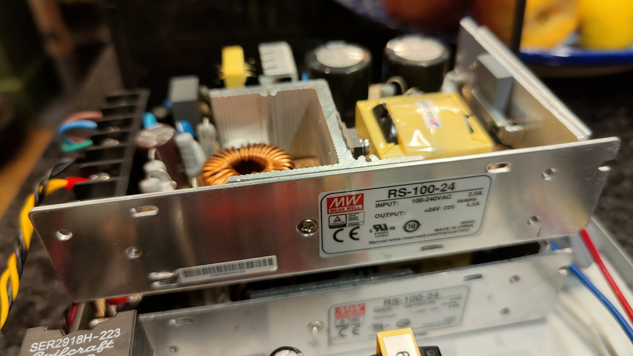

I have 2 of these PSUs in a chassis , each powering a channel of Abraxalito' s class D amp.
Stacked on top for packaging. I initially removed the cover from the lower one for air flow and cooling reasons. Not that they get particularly hot.

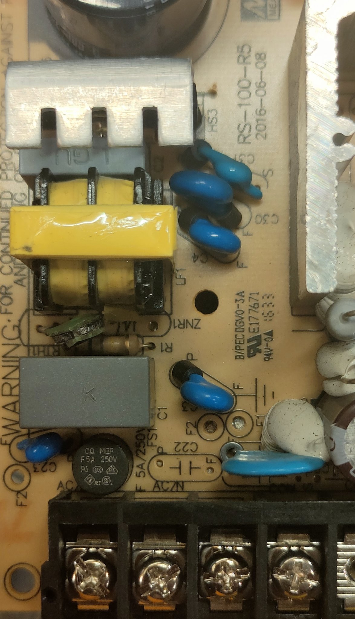

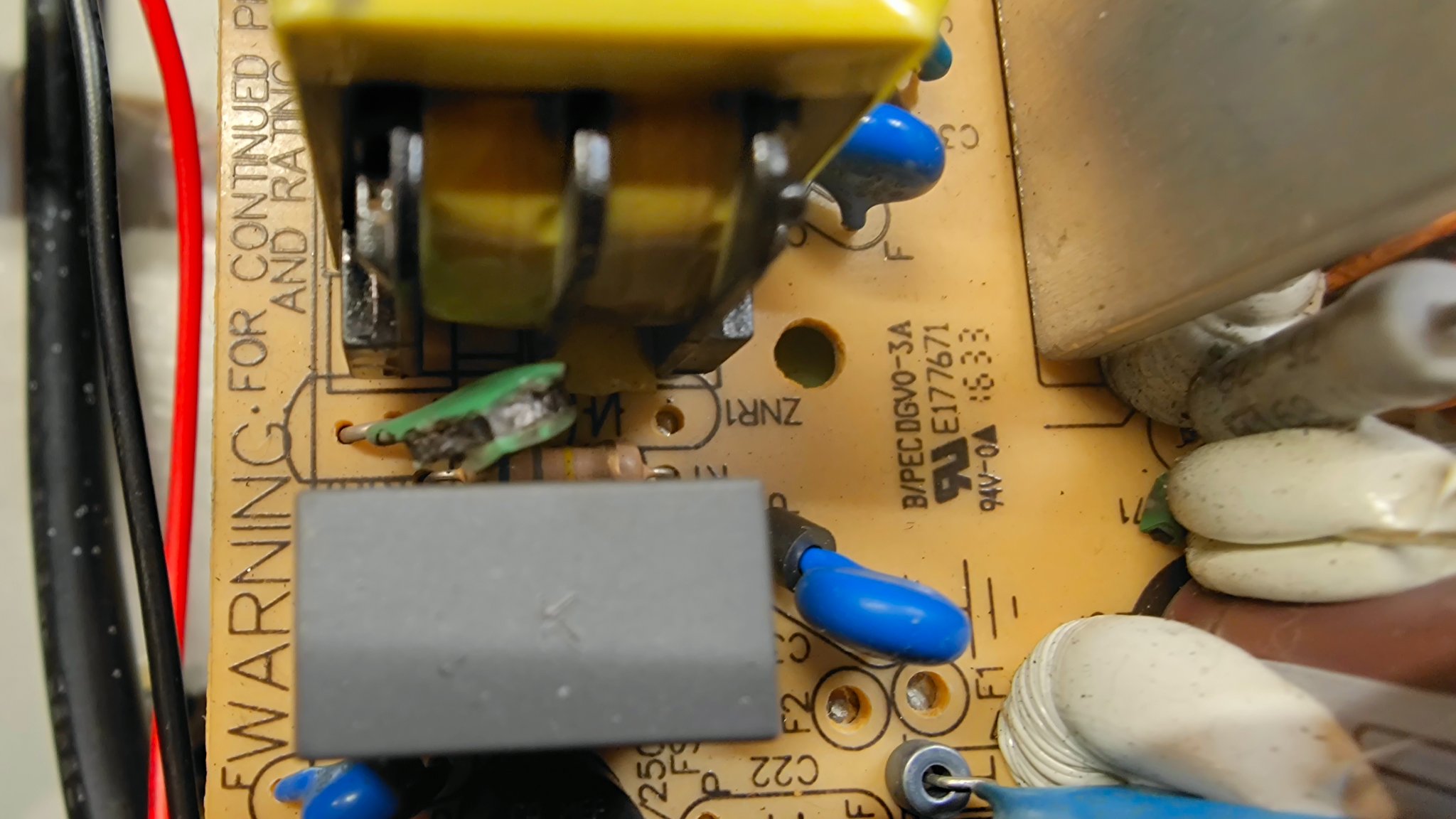

Thought I better had look into this and have just taken the lid off, and off the offending PSU. It would seem to have eaten up the ICL on what I assume is the main 240v in. Not exactly a big load from this class D amp. And the switch seems to have 'recovered'!
Any thoughts on this?. Shall I just replace it? What sort of value and do I uprate it.? It all still works but a shower of sparks on start up isn't so family friendly! The PSU states 100 to 240vac and I'm pretty sure I'm around 245 a lot of the time, but I doubt this is the cause.

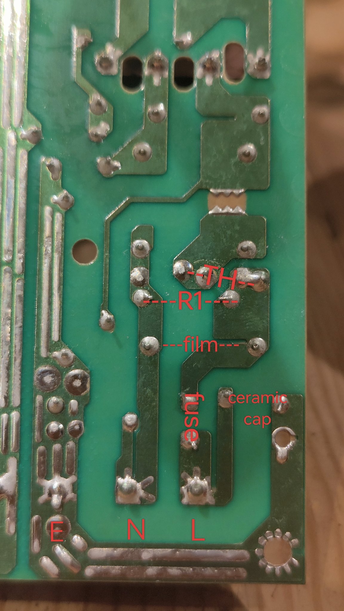

I can't tell from the pictures but is that part definitely a thermistor and in series with the incoming supply? or is it across the supply in which case it would be a VDR.

* Please replace the ICL's in both PSUs for a known good brand/type.

So I think it is in series with the line in heading into the inductor.

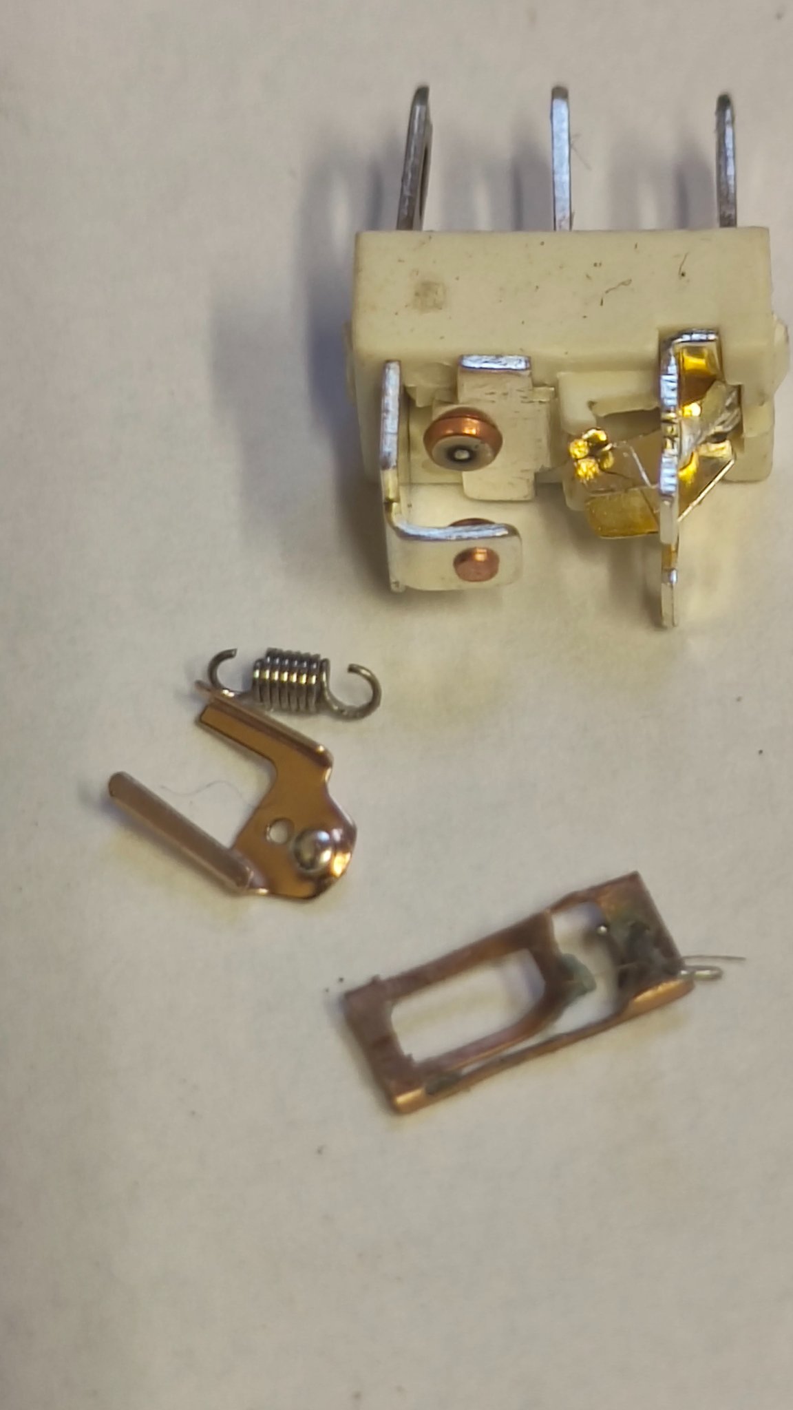

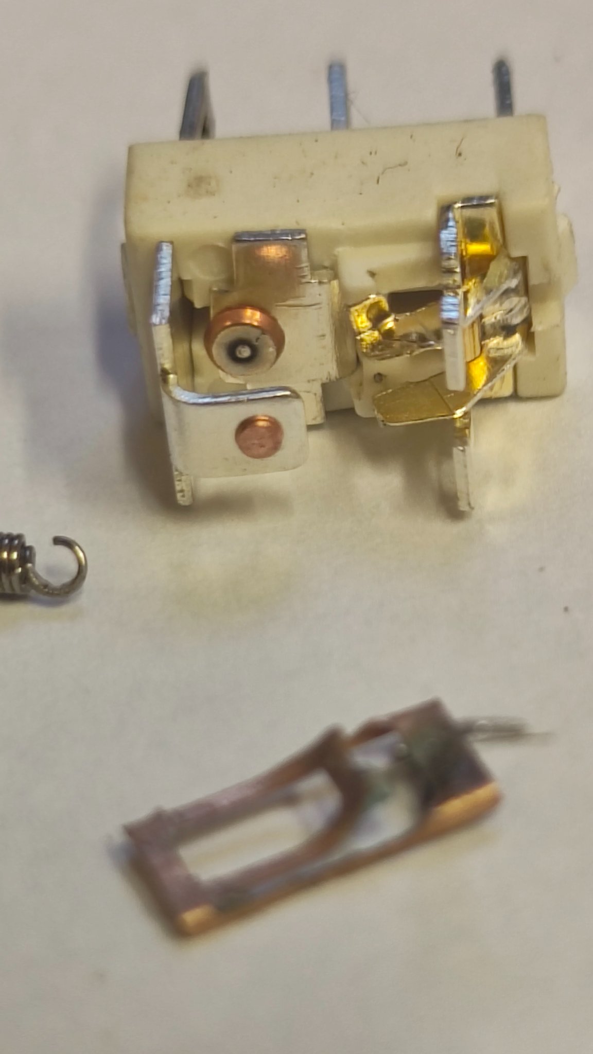

Actually looks quite nicely made but those small contacts probably aren't up to much current. No signs of arcing as far as I can see. It's pretty small in there!

Seem copper colored (!) contacts so that is a plus 🙂 Not the required alloy probably (well, for sure) and too tiny because of the ball like other contact causing pitting. Are the other conducting parts all plated steel I guess? Apparently they use various materials in the same models/series of switches so stuff becomes batch dependent. What is the current rating of this one? 220V 5A like usual? The real rotten ones have no contact ratings except for the power on LED. Why? The customer will return the switch when the LED fails directly because of user error.

The only ferrous material was the spring and the little linkage.
Potentially 3A rating if I'm looking at a like for like item listing. Maybe here is my issue seeing as the SMPS are 2.5A each. But I assume this is worst case at max output .
Switches arc at opening not closing. That is why you place a capacitor over the opening contacts so it will extinguish (quench) an arc as it absorbs the energy.
EDIT: The arc point is clearly visible on the contact. It will arc if unprotected even if rated at 1000A
