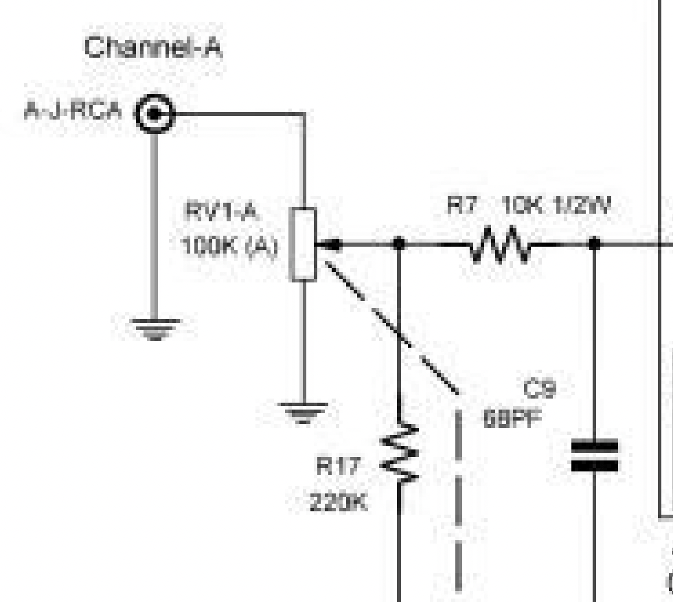

Can someone please inform me what the meaning of RV on schematic is? It is specified at 100kΩ and is directly grounded. Google is of no help.

I would guess a variable resistor. If the symbol only has two terminals, then the wiper of the pot would normally be tied to the non-ground end so that if the wiper stops working you get 100k resistance instead of an open circuit. Without seeing the schematic it's hard to tell if a variable resistor makes sense in your circuit.

Here is part of the schematic. Highest resolution available.
Yes definitely a potentiometer. It is controlling the volume. The dashed line probably goes to a similar symbol on Channel B which would be labelled RV1-B. This means they are two potentiometers controlled with a single knob - known as a "double gang" potentiometer. The "A" in brackets mean this is an "audio log" (also known as type A) potentiometer - this is explained here. So you need a double gang 100k type A potentiometer.
Yes definitely a potentiometer. It is controlling the volume. The dashed line probably goes to a similar symbol on Channel B. This means they are two potentiometers controlled with a single knob - known as a "double gang" potentiometer. The "A" in brackets mean this is an "audio log" (also known as type A) potentiometer - this is explained here. So you need a double gang 100k type A potentiometer.
Of course!
Interesting there is a capacitor between the two, is it built into the volume control?

No capacitor inside the pot, it should be external.
Possibly for reducing cross talk.
On the schematic it is on the dotted line connecting the two, not shown where connects. 🤔
Zoom out, post a highest resolution copy or photo of the schematic.
It could be optional.
I was being dumb and forgetting what a capacitor symbol is leading to misreading...
