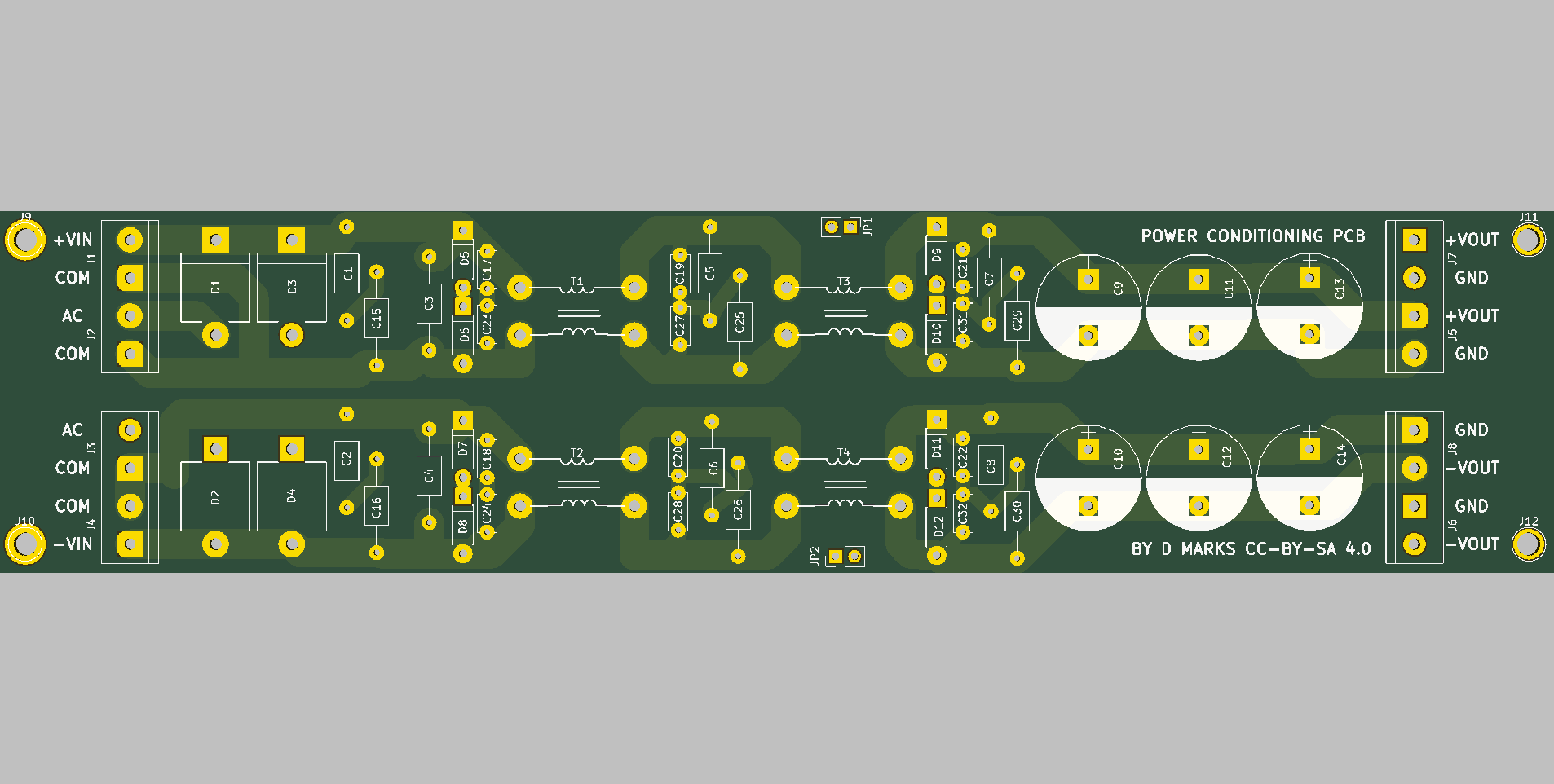

CMC power supply filter board

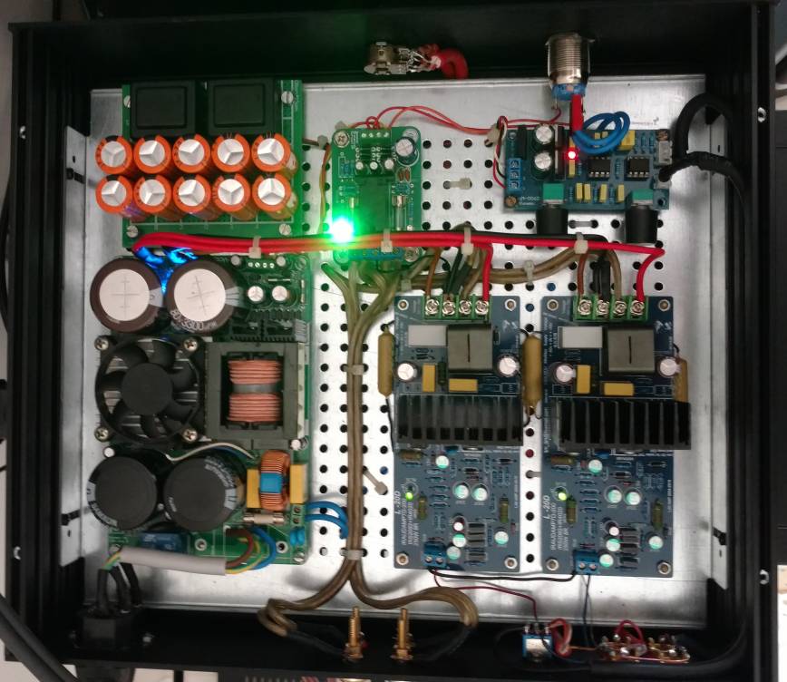

I am working on an audio amp and I designed a PCB for it because I originally planned on using two LRS-350-48 Meanwell supplies for it.
PowerAmpAudio/PowerCond at master * profdc9/PowerAmpAudio * GitHub
However, to use it, a metal chassis should be use so that the RF from the switching noise and other noise sources is separated from the supply rails.
  • PowerCond-schematic.pdf

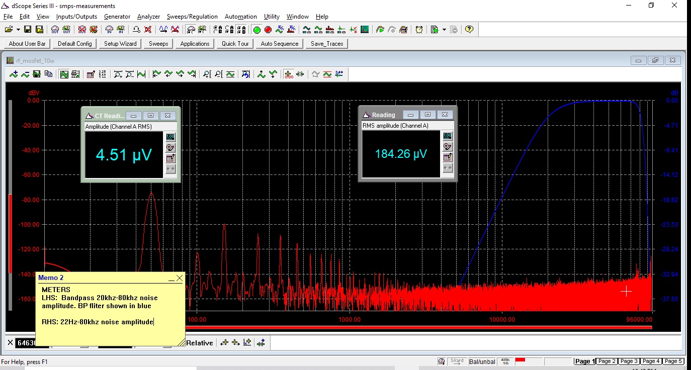

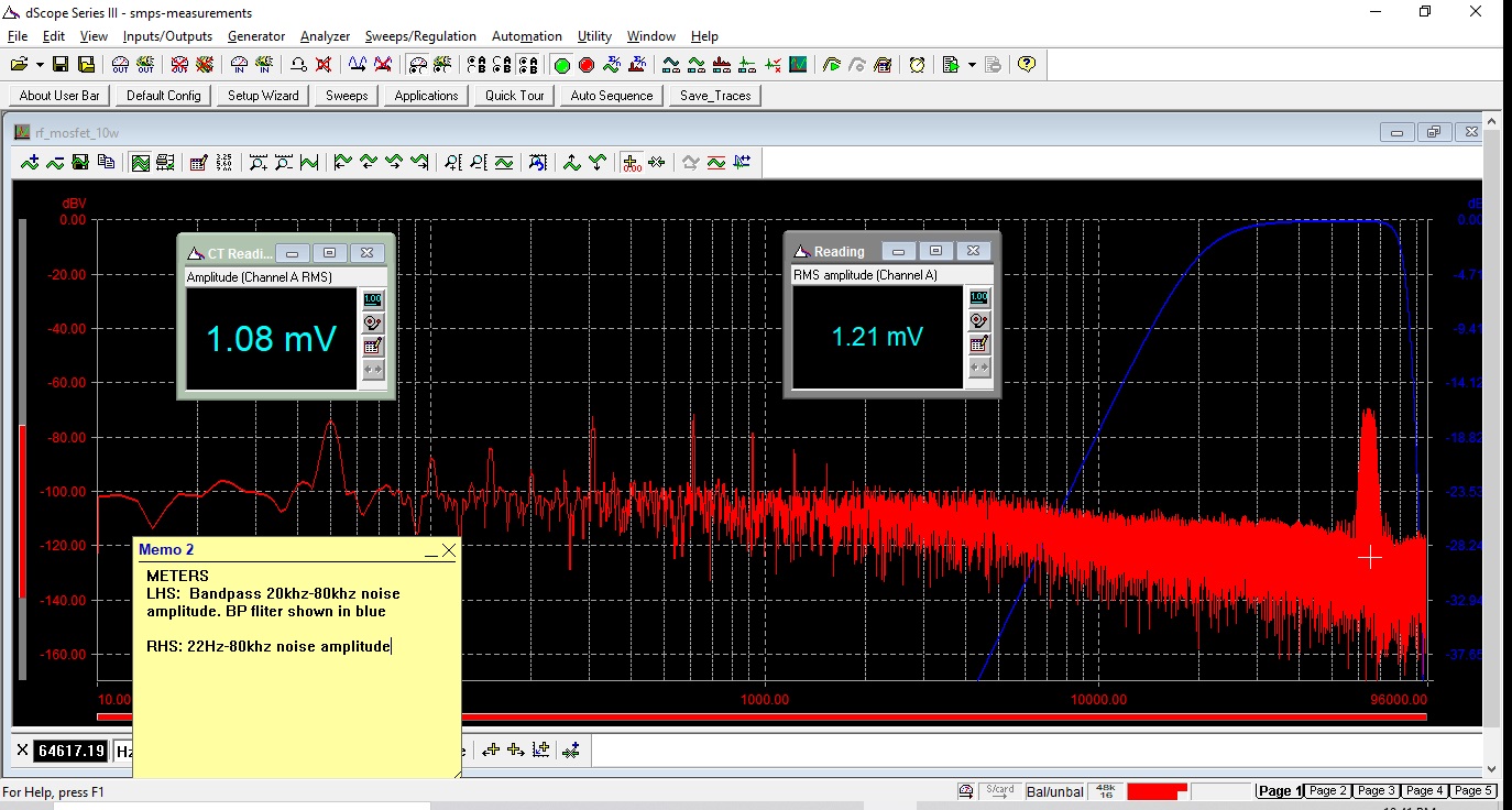

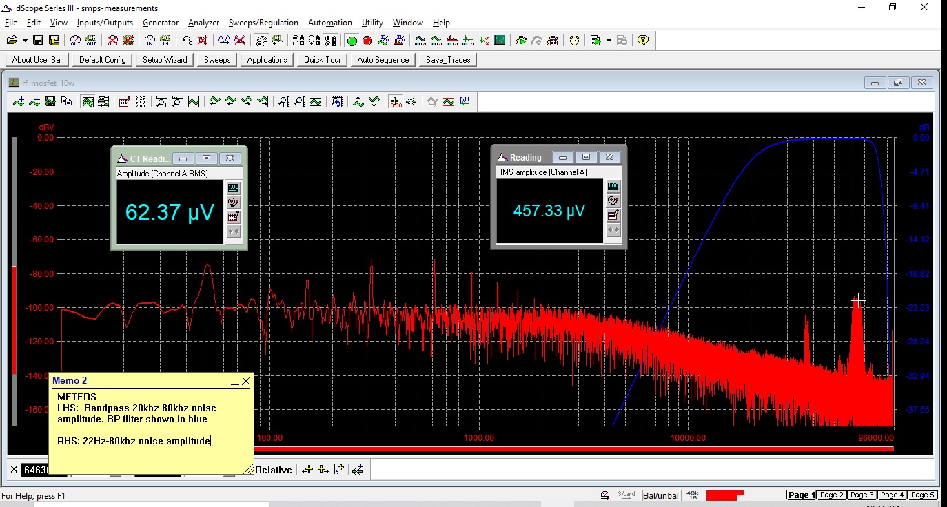

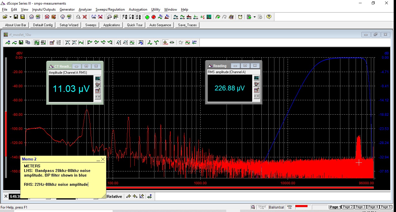

I did some measurements today for a Meanwell LRS350-48... loaded at 1A
- with L only - 8uH common mode inductor, and
- then L+C with 33kuF of capacitance (just to be absurd).
22hz-80khz bandwidth (and then in brackets Hi freq noise 20k-80k)
SMPS w/o filtering: 1.2mV (1.08mV)
L only filter : 457uV (62uV) ; wow that cm inductor really works !!
LC filter: 226 uV (11uV)
as above but with mains switch off: 184uV (4.5uV)
So not bad - adding some simple passive filtering makes these large & economical PSUs quite useful indeed.
ps the large cap triggers hiccup mode so beware ...

At how much dbV does it get audible? Or thre isent a general rule? There is a large spike at 80khz how so? Do the transistors switch at such high speeds? You brought that curve down nicely, but should we even care about what happens after 20k? most speakers cant even reproduce those frequencies let alone the fact that class d output filters should turn them down, moreover who can hear after 20khz
The switching frequency is 160kHz, looks like. The spike at 80 would be the half-cycle switching spike.
I'm concerned about the load being too low to properly test ripple. I could expect the ripple to hit about 30mV at 50-60% load, which while high would still be acceptable and that is when you see the greatest contribution of LC filtering post the supply.
While the 50Hz spike looks bad, even the worst designs will have about 40dB of ripple rejection at low frequencies and this is not a problem. Would be very happy to see some results at higher load, as Meanwell's own datasheets show much higher ripple measurements when fully loaded.
At how much dbV does it get audible? Or thre isent a general rule? There is a large spike at 80khz how so? Do the transistors switch at such high speeds? You brought that curve down nicely, but should we even care about what happens after 20k? most speakers can't even reproduce those frequencies let alone the fact that class d output filters should turn them down, moreover who can hear after 20khz
True - nothing much beyond 20khz will eventually get amplified (or even reproduced !) Much of the ripple and noise is actually at lower frequencies tho so it makes the effort worthwhile...

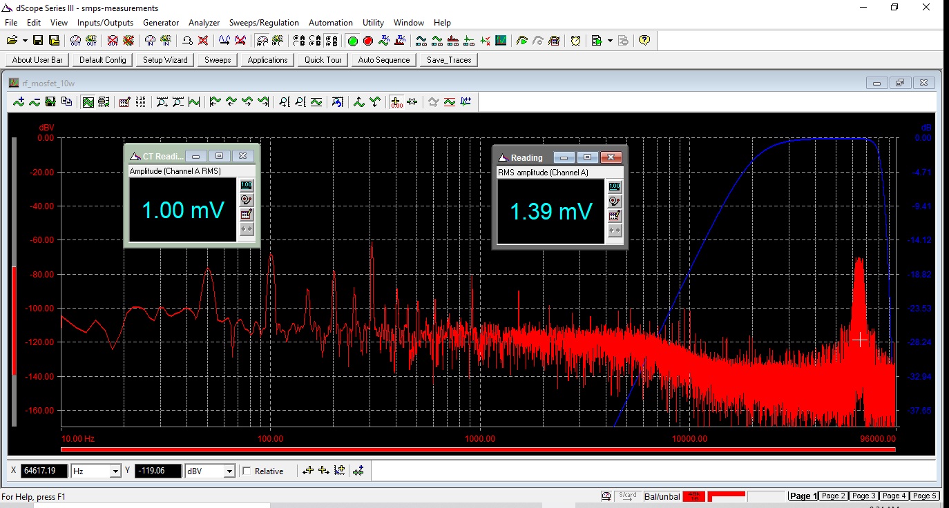

Here is the spectrum with a 4.5A load and as you pointed out - seeing more ripple. A second stage LC or a cap multiplier would clean this up nicely if required 😀

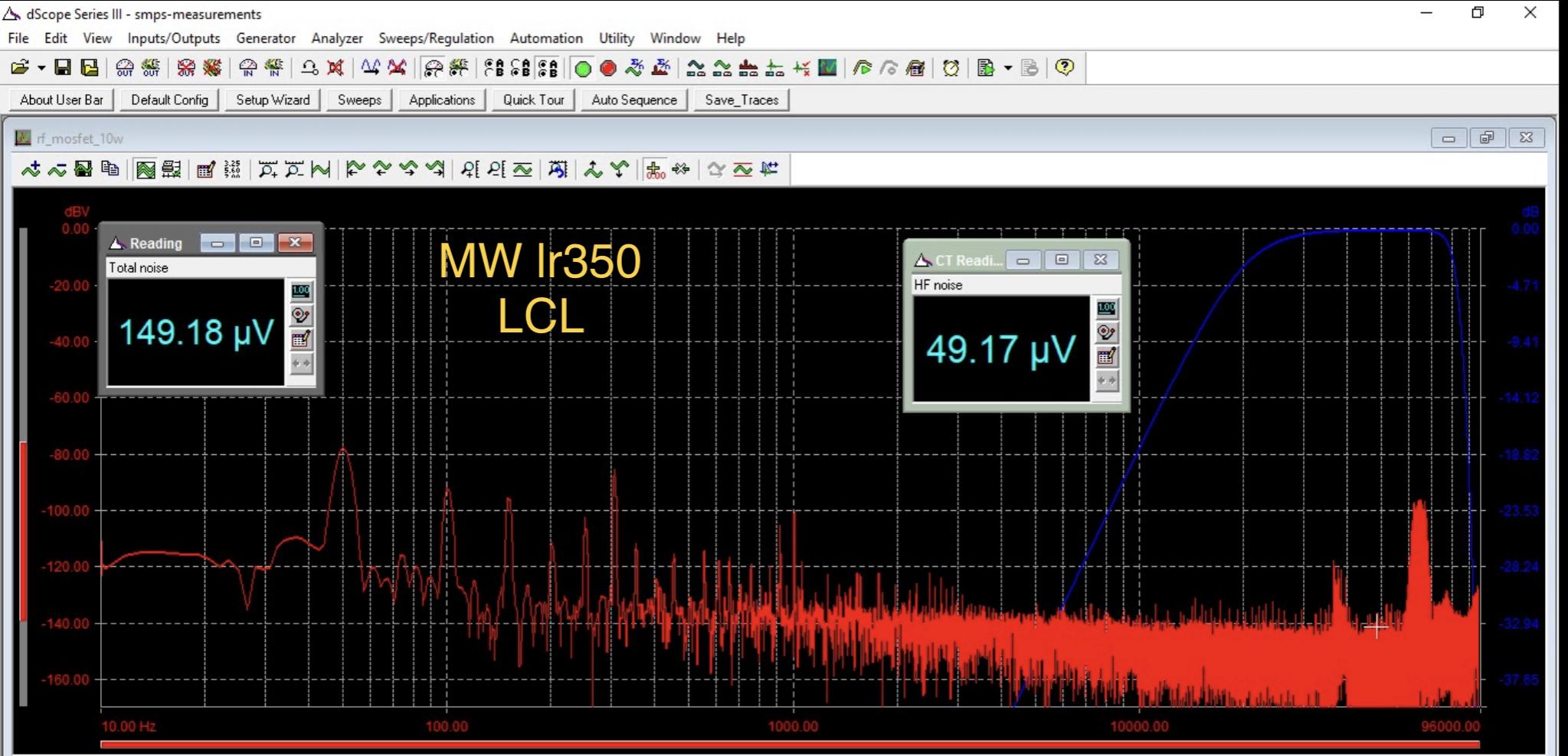

48v Meanwell with 2 stage LC filter

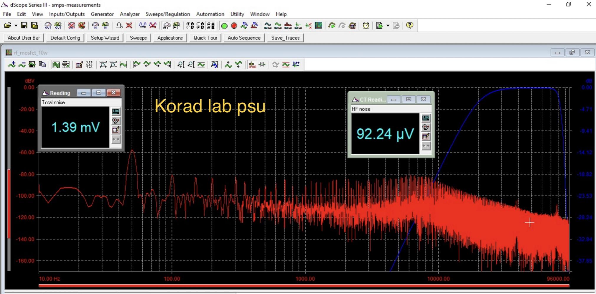

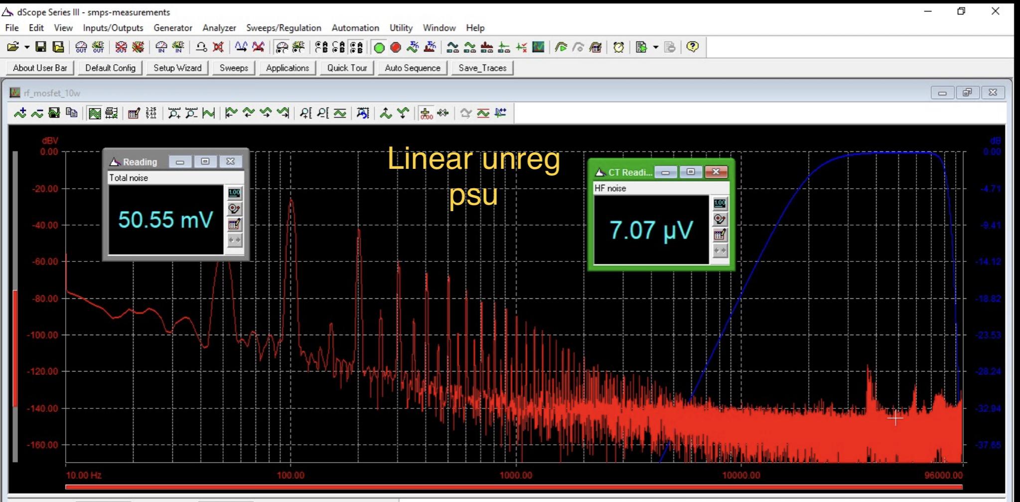

After a lovely weekend with the fam, I spent a few hours in the shop this evening playing with this.
I added another L stage and MLCC cap at the output and compared the ripple and noise results against a few other usual suspects.
Here are the results when loaded at 4.5A (48v)
1. Linear unreg psu 20,000uf+0.47R+20,000uf: 50mV
2. Korad lab psu: 1.4mV
3. Mw lr350-48: 8uH+20,0000uF+8uH+20uf MLCC: 150uV
Pictures attached 😀 .. This gives good performance for a simple high current/voltage supply I think.
Sounds good enough but there’s a downside though... the otherwise good load regulation of the mw amps deteriorates because of the resistive losses in the inductors..😱
Next week I’ll try a cap multiplier instead of (one of?) the inductors to see how well it works....

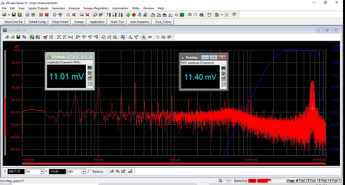

Sure... from a few posts earlier, here is the Lr350-48 alone with no filtering. The load is 4.5A.
