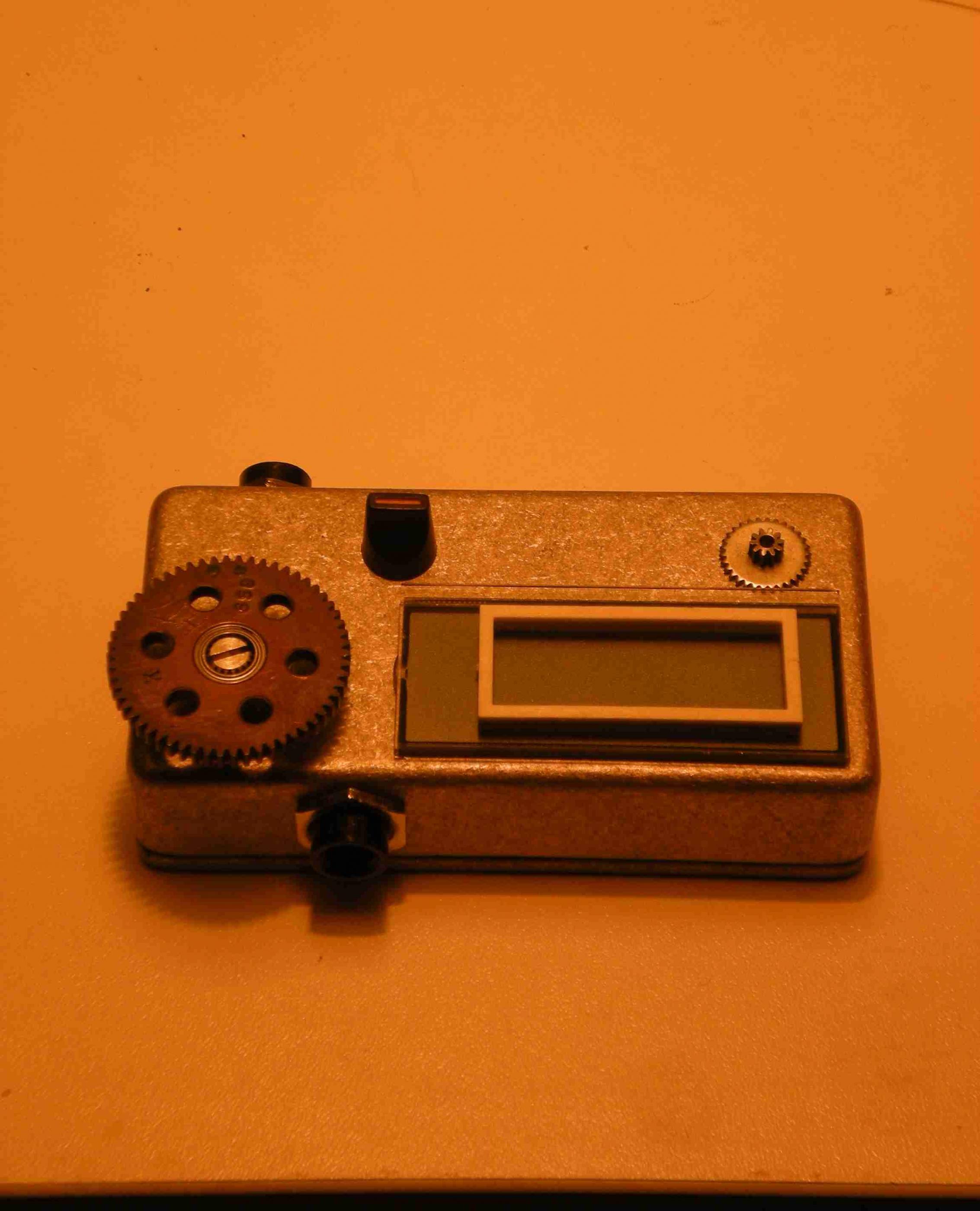

I measured the box, next I measured my right foot, next I thought: something's wrong here. My foot can't be three times the size of a stompbox. Ridiculous. So no stompbox.

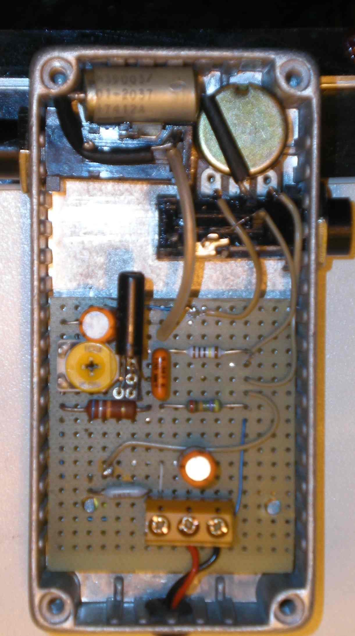

And no bypass switch, yeah, **** the switch. There isn't much space for a switch anyways. The box is less than an inch tall. Next I will post a photo of her insides.
Mclaren2 - There's a LED so it would be less. Anyway now I want to put the battery at the back - like an astronaut. BTW, forza Ferrari.

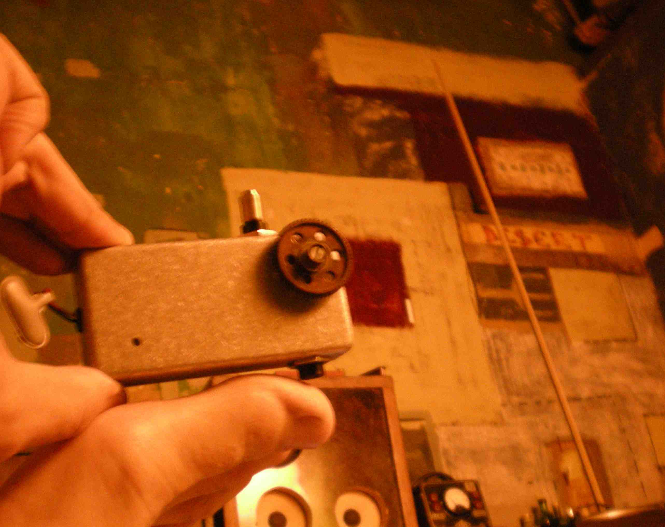

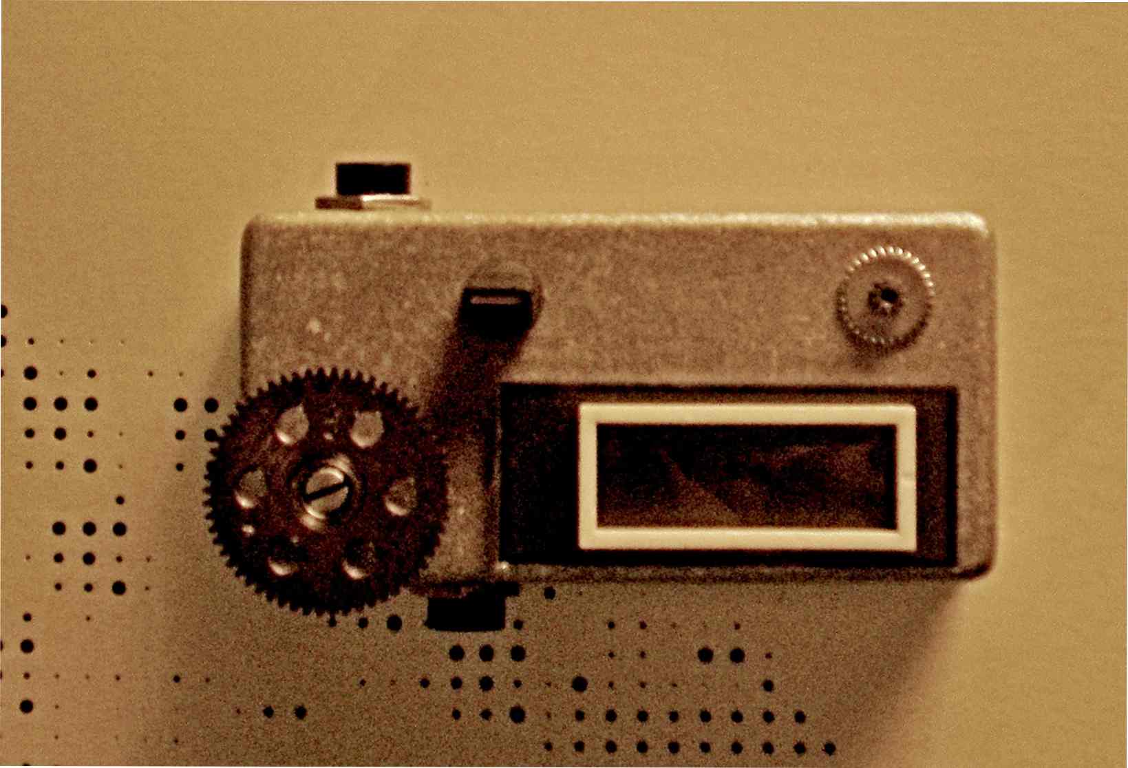

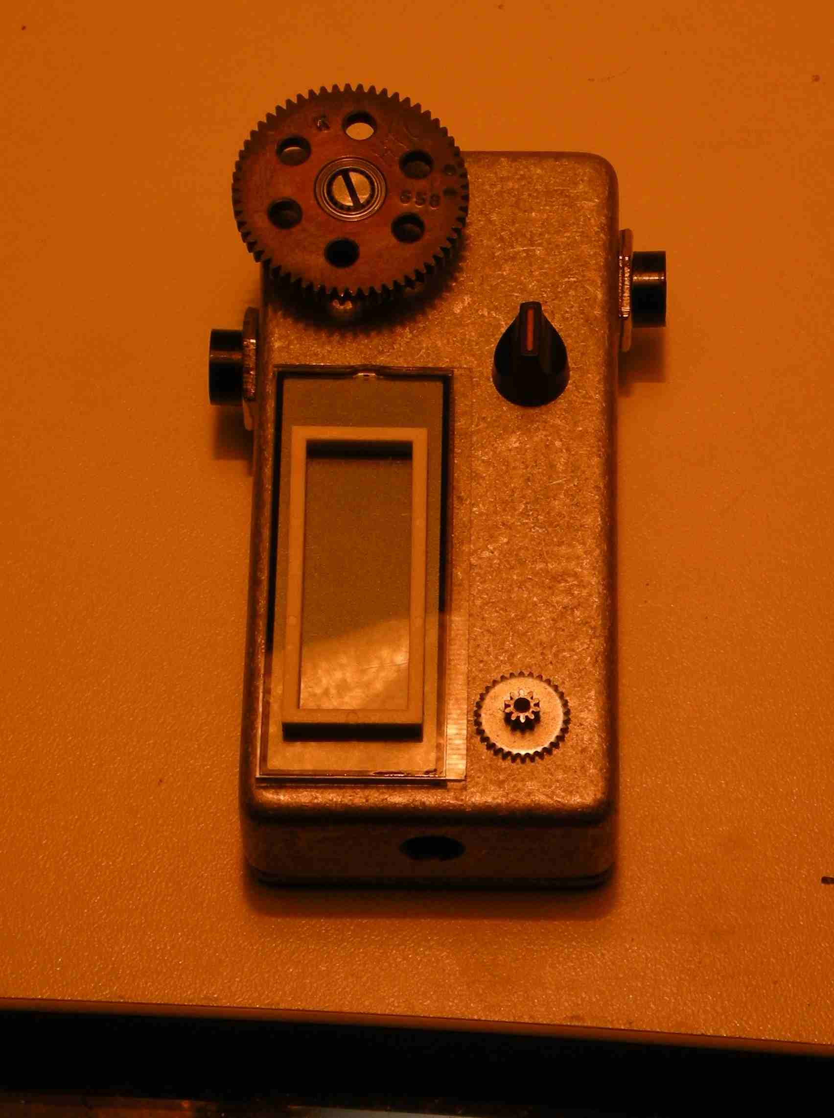

Well, project completed. It's been a nightmare. Never, never again. It takes me less time to build a tube amp. Thanks to iaxxaxxai for the help.
I'm going to try out a variety of germanium transistors so I will report back to tell you which one sounds the best. It will take me some time thought. Maybe even some sound clips. Just maybe..... I don't enjoy recording.

The value of the input cap is 47nF. The voltage at the base is 4.6 volts.
