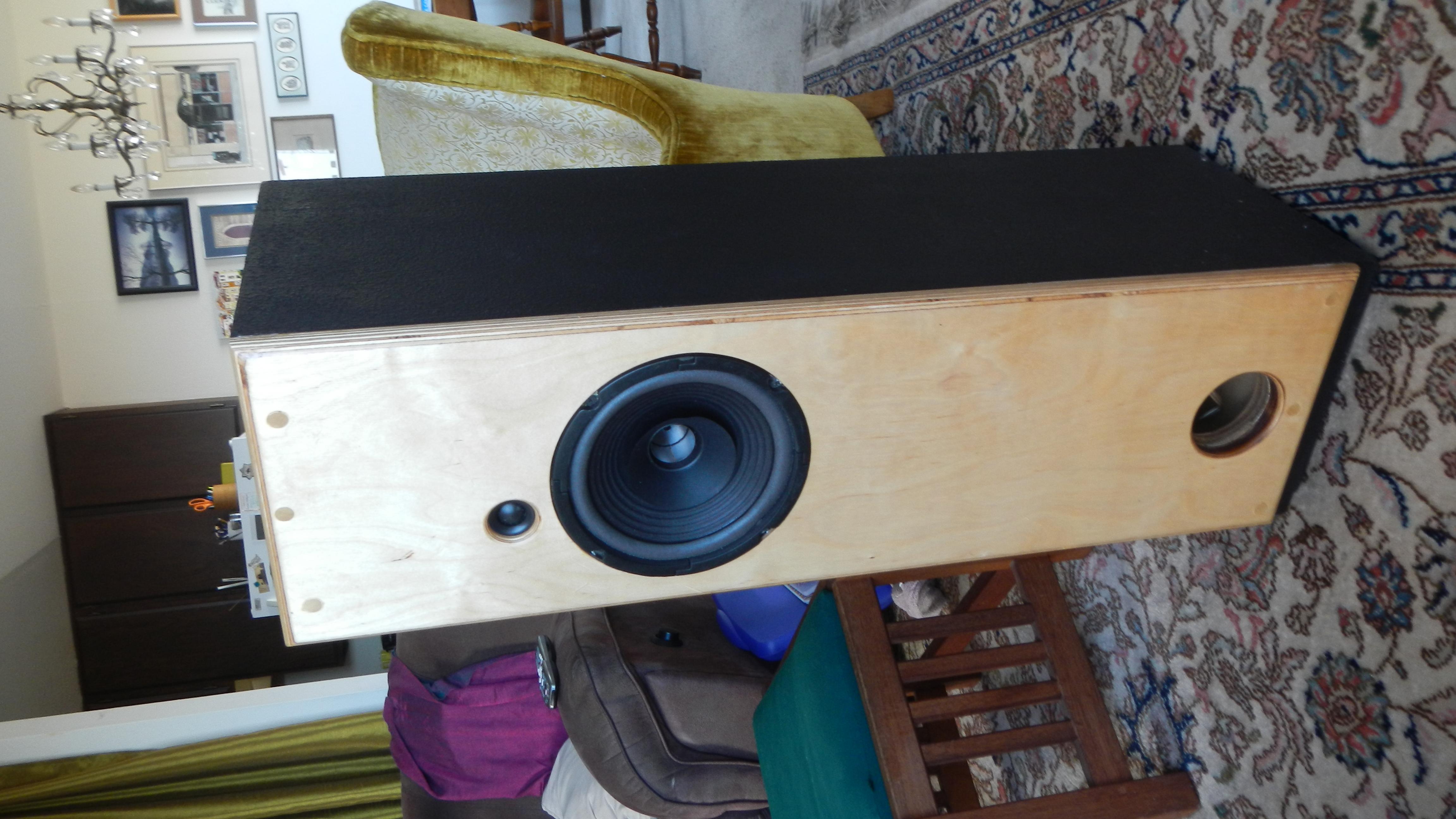

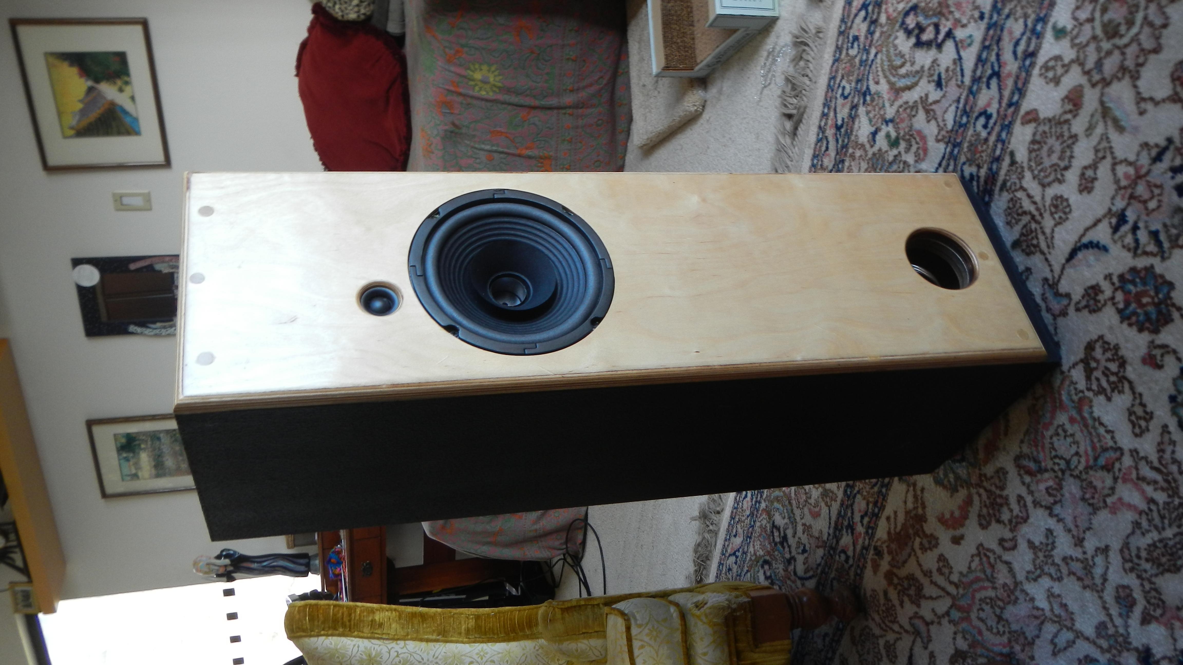

I have used truck bed liner rolled on speakers and it gives a hard finish that will not telegraph joints. Doesn't look much like wood. 😉 The last speakers that I built used truck bed liner on five sides and varnished wood for the front panel. Came out quite nice. There are versions of it that you can tint if you don't want black or white.
It is Duratex. I have used Duratex and stuff marketed as truck bed liner and haven't noticed a difference. Do not buy water based truck bed liner. It is definitely inferior. Roll 2 coats on and get down to listening. I have no patience when it comes to finishing, so the combination of Duratex on 5 sides and wood finish (varnish/shellac/oil/wax/whatever) on the front baffle works for me. 😉

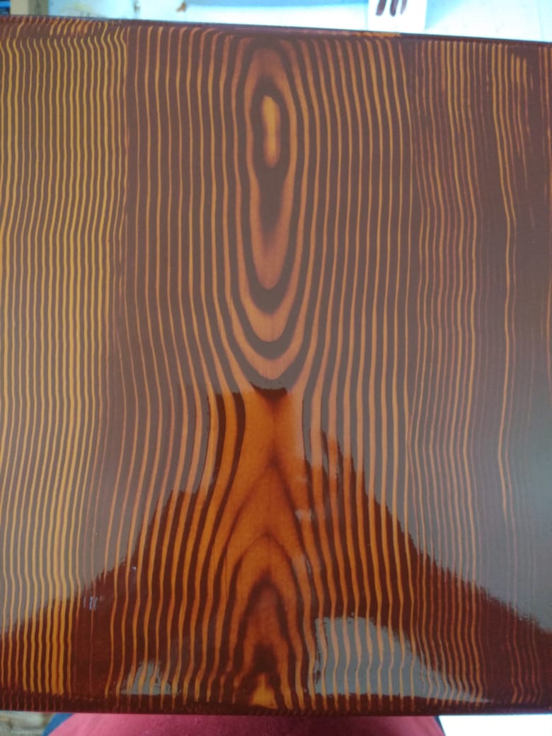

Finally, after almost 2 months of struggle, I am able to get the desired wood finish on the speakers. Here is a WIP pics. Looks good isnt it? Its with enamel paint.
It took many many trials with various paints, tools, methods.
I had lots of trouble with orange peal, and then dust.
For the orange peal, sanding of primed surface plays very important role. Atleast 3-4 layers of primer sanded till you get a very smooth surface without the peal.
For dust, a method i am successful at is as follows.
After the top coat, till the paint dries, many many dust particles will settle down on the surface.
Use 2000 grit sand paper with wet sanding, to get rid of those, to the extent possible without affecting the finish.
Then prepare a very very thinned paint of your top coat and put a thin layer of it with a rag. This will dry pretty quick, before the dust has a chance to settle. Voila, you get a very smooth surface, without loosing the texture.
