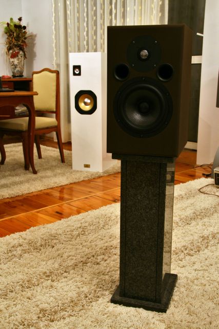

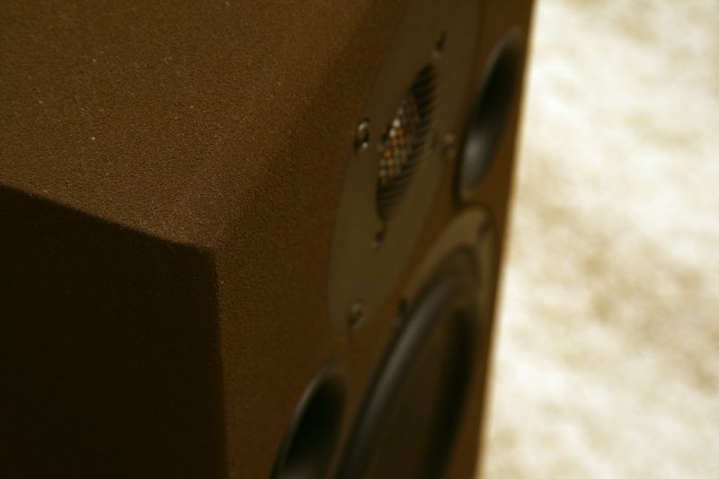

Another option, depending on the finish you want, would be the DIY pickup truck bed liner that is now available at automotive parts centers. I have never tried it myself, but it should be durable.
I've used it from spray cans and it's pretty good, and although I used it on my tool box, I know several that have used it on speaker canbinets and were very happy with the results.
Best Regards,
TerryO
Doesn't even have to be truck bed liner. This stuff comes in a spray can from your local hardware store and costs about $20 CAD to do two medium sized cabinets.
Hmmm... maybe that's what Terry was talking about Cal.
Cal,
The brand I used was Duplicolor which is pretty easy to find, at least down here.
Best Regards,
TerryO
