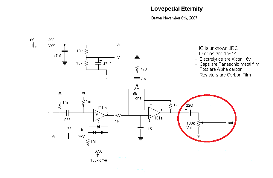

Hi, I just started incorporating digipots into my guitar pedal circuits. I've successfully built one type of circuit whose digipot controls volume and gain, but on my second guitar pedal circuit, I'm running into the following issue:
When the digipot (MCP41100) is set to a lower volume (physical pot is on a Arduino Nano's analog input and dictates the digipot), I get all kinds of nasty buzzy, almost gated or "spitting" fuzz type of distortion. Only when I crank the volume mostly up does it go away, but then I'm left with a huge, overpowering volume.
I've attached the schematic of the circuit and circled where the digipot is in the circuit. Nothing too complicated, just shunting the audio signal to ground. There's already a coupling cap to block DC before the pot input.

> I'm not sure why
On the MCP41100, and digipots generally, the analog pins must stay *between* the supply rails or they distort horribly.
In your LovePedal, Drive and Tone have +4.5V at all ends. But Vol has ZERO VDC on all legs. Any signal swing below zero will distort.
