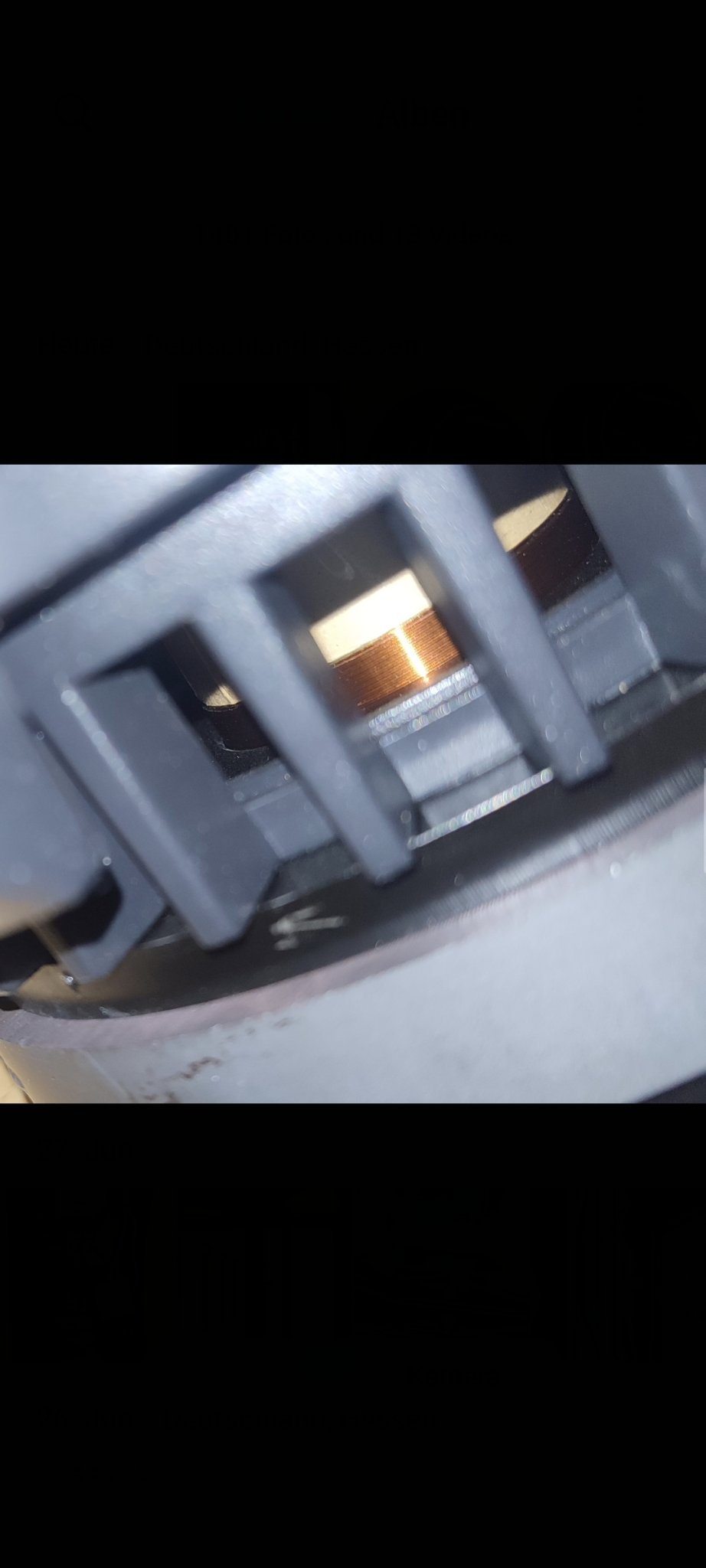

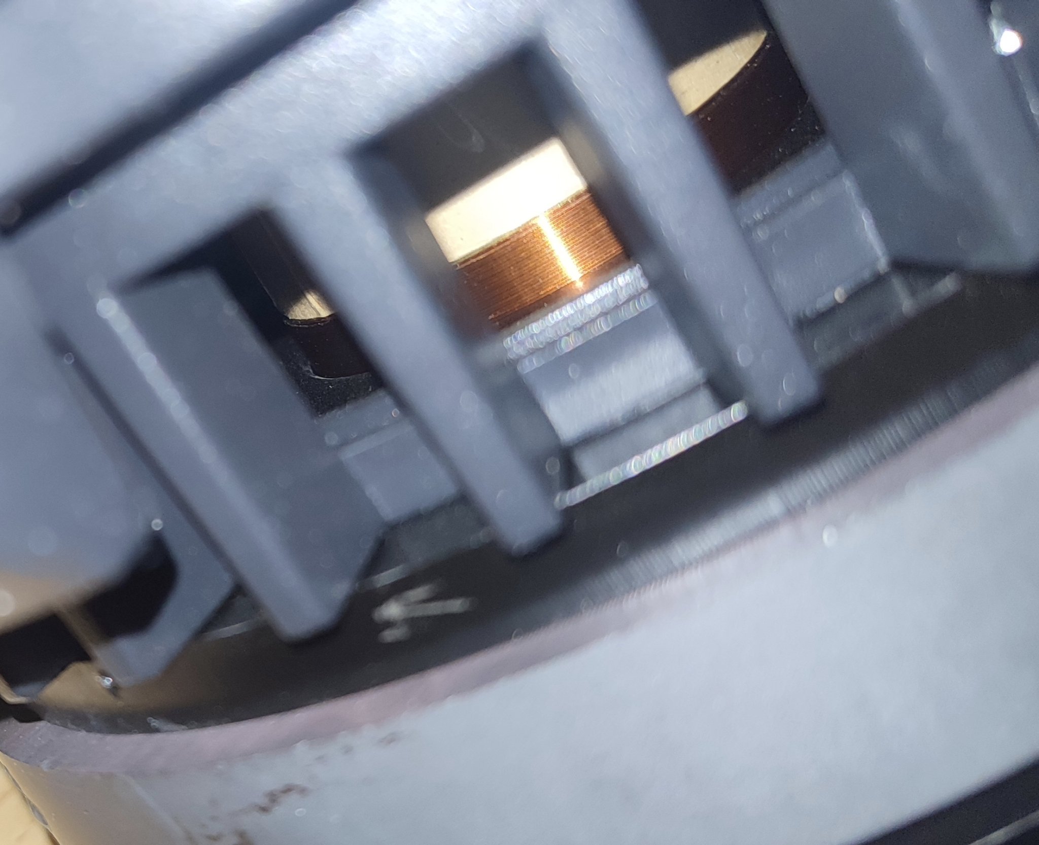

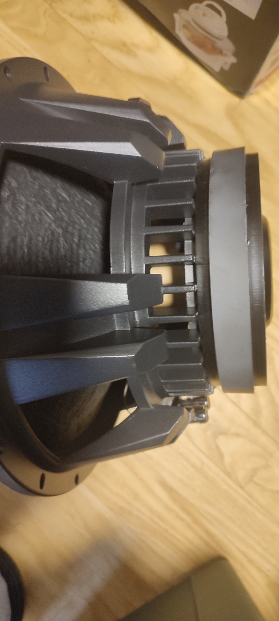

As Michael Chua of Amps-Lab has testet this inexpensive 12" Woofer and found it fared very well I had to order 4 to test them in Ripoles.
To my surprise it has a way different design now. I did not have a chance to test it yet, but what I saw was encouraging.
A few times in different forums the question came up if the rated xmax of 7mm was actually plus 3.5mm and minus 3.5mm but I can confirm that it has real +-7mm.
It is now very well vented under the spider and the voice coil windings can clearly be seen sticking out 7mm above the pole plate.
Thought I share this as some people may look for an inexpensive Bass unit that is well made.

If you look at the actual measurements online you will find the published and measured parameters are vastly different. The 55-2982 will work open baffle due to the high Q. But a Q of 0.7 is a bit high for a Ripole. You will need to allow for more chamber volume. The measured Fs is also way higher than published (45Hz), but the loading using a Ripole will bring it down a few Hz. It will be a boombox in a sealed or vented alignment.

Yes my woofers came in and I can assure you that the 7mm Xmax is genuine.
Voice coil overhang is clearly visible.
