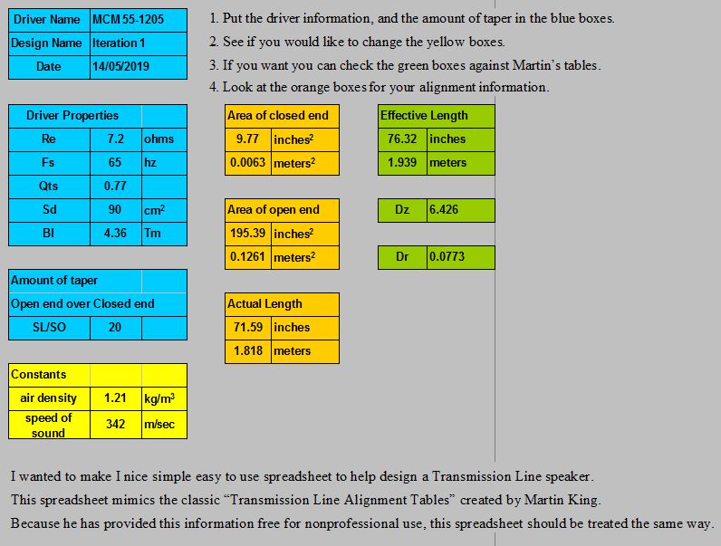

I have a few MCM 55-1205's* kicking around and want to experiment a bit. Some are currently in .3 cu ft sealed boxes which actually sound better than they should. I want to see if they are candidates for TL duty. The first kicker is I want to use a 2.5 TMM configuration in leiu of BSC, rolling the second one off around 600~ Hz instead of burning 3-6 dB up in a resistor.
Second is I want to see if it is practical to use a tall/ slim straight / folded TL to get what low end there is.
I also found out I'm a few days late to get Martin King's mathcad files, so I am trying to bend my non-calculus brain around the still available charts. I also found a couple of calculators to try modeling some configurations instead of trial & error. Paper is cheaper than sawdust.
What I have been exploring are iterations on the Weems Pipe, but with updated math for the TLL with the SL>SO. One spreadsheet wants something like a BIB line, the other looks more reasonable but I'll have to translate some German terms... Looking for some more (non-calculus) solutions, or a line on the currently unavailable MJK mathcad files.

Since those are no longer an option, is there a good copy of the Leonard Audio TL program available? I'm reading up on HornResp which looks to have a bit of a learning curve to become proficient.

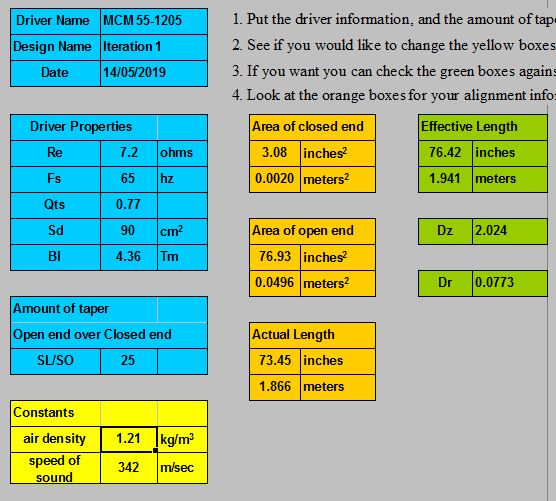

I did try using Keith Webb's spreadsheet from MJK's Quarter-wave site, and the size is a bit big for 5.25" drivers. It does appear that Bl & Qt do have more of an affect than I would have supposed.
What effect does reducing (or porting the open end of the line (I see it is now called "mass-loading")? Seems like it would diminish the loading & efficiency.

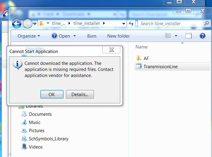

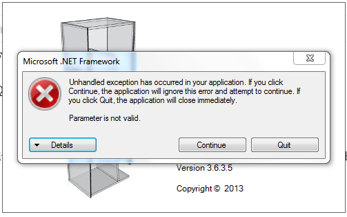

My LATL was working fine when it went down, but recently it crashed, so tried the workaround written up on the official thread to reload it and when I opened it I still get a .NET error that I've no clue how to deal with, leaving me with HR since I don't have MathCad loaded. It all started here: Transmission Line Modelling Software
