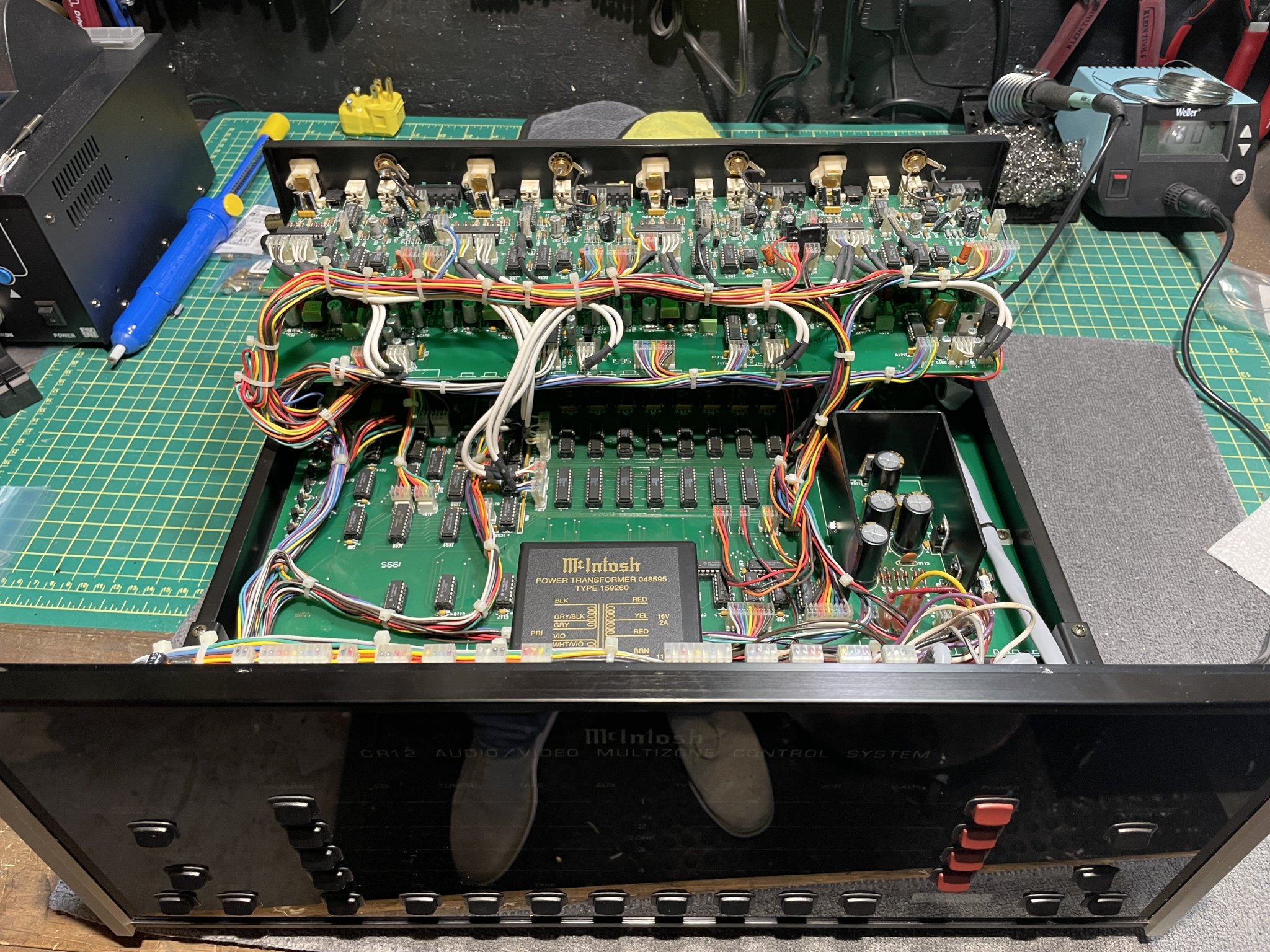

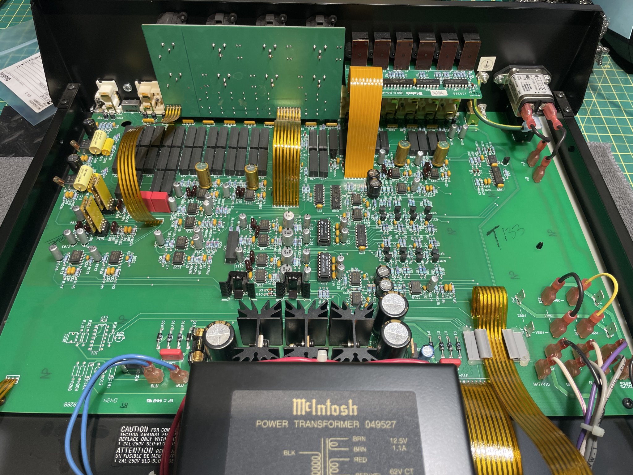

I have a couple of vintage McIntosh preamps, a beautiful C46 (a real gem and favorite of mine) along with an interesting CR12 I picked up from a fellow who claimed it fell victim of a power surge. I've recapped both; the C46 I was surprised how many of the caps have drifted, some significantly - now, I know this wonderful preamp is gaining in years, but I wasn't expecting the kind of electrolytic drift I was measuring across the old caps. Needless to say, great improvement, and I redid it using Vishay audio electrolytics, which I find absolutely excellent. It is a big improvement now having it operating as it should.

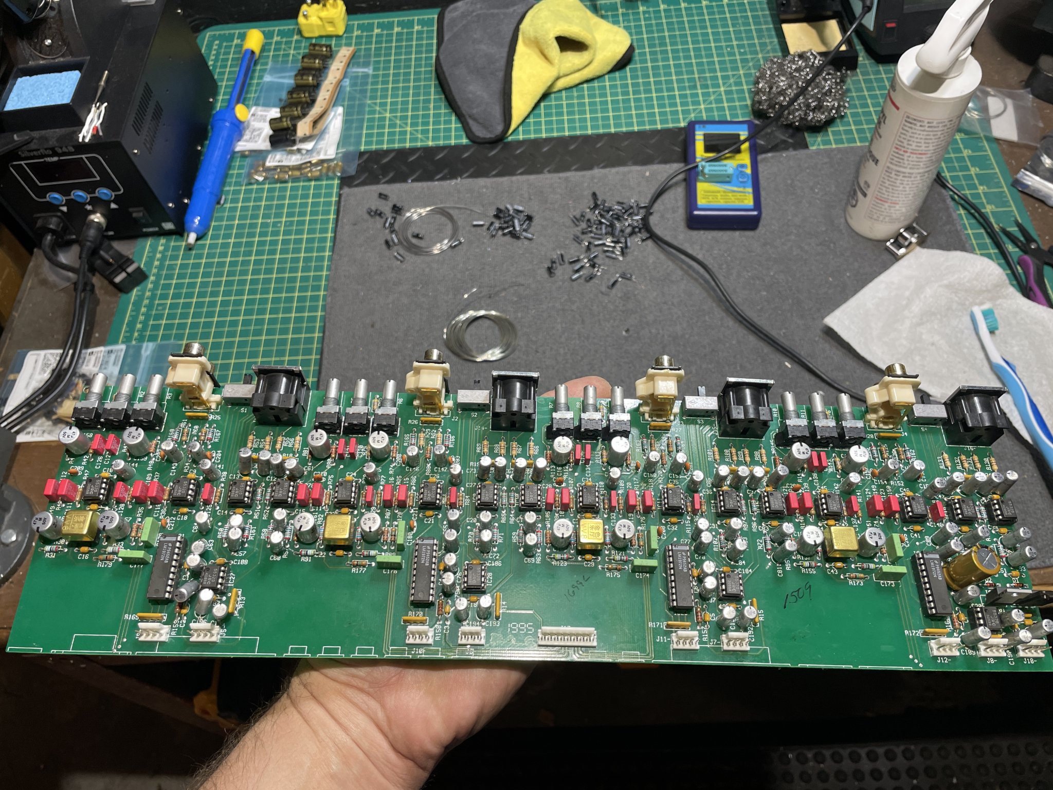

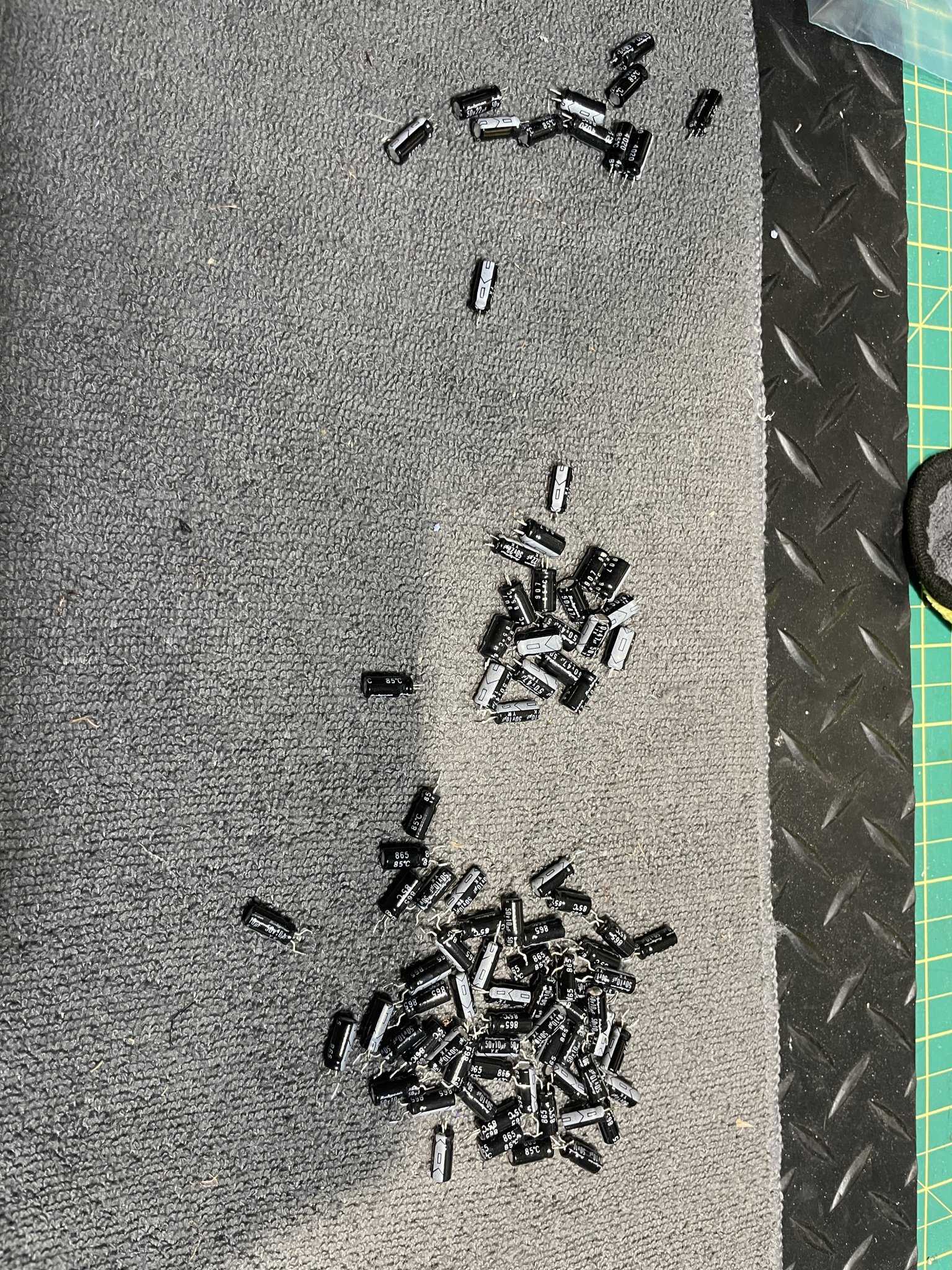

The CR12 on the other hand, unique piece. When I received it, it barely turned on, caps in the power section were bulging and hot to the touch! I thought voltage regulators, but just replaced everything and it brought it back to life. Added new lamps (old were blown) and score. Now, recently I took it a bit further and removed the output board, basically 4 output stages on one large board and shocked to see the state of the caps on that. Some of them were measuring in at pF range - totally shot, baffled at how the thing even produced a listenable sound.. I just completed the entire board, 60+ caps, many 10uF, and what an experience - I have it feeding a couple of stacks of equipment all running in my workshop. Despite being basic from an audio standpoint, it produces a great sound now.
Now, the question/topic. All caps Rubycon. I always thought of Rubycon as in a similar range as Nichicon, but are these caps suspect? Did McIntosh take a bit of a wrong turn with Rubycon? Working on Mc gear is just a pleasure.. Maybe akin to working on a mercedes.
