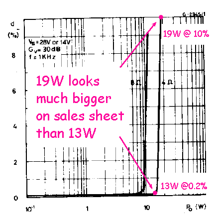

Does your car sound system sound distorted to you?
Most of them run 10% or more....
That's to get the Power Output spec way up. It is into clipping. (Altho this seems to be the normal operating mode for many drivers.)
All the current car-sound chips will be below 1% at 70% of over-rated power, and most will be <0.2% at moderate sound levels.
I would argue that your speaker numbers are also taken at high level. However speaker distortion does not fall-off as fast as NFB amplifiers and they sure do have higher THD than most amplifiers at normal working level. (However speakers mostly distort "bass" (or bottom of midrange driver) and may be cleaner over much of their range.)
