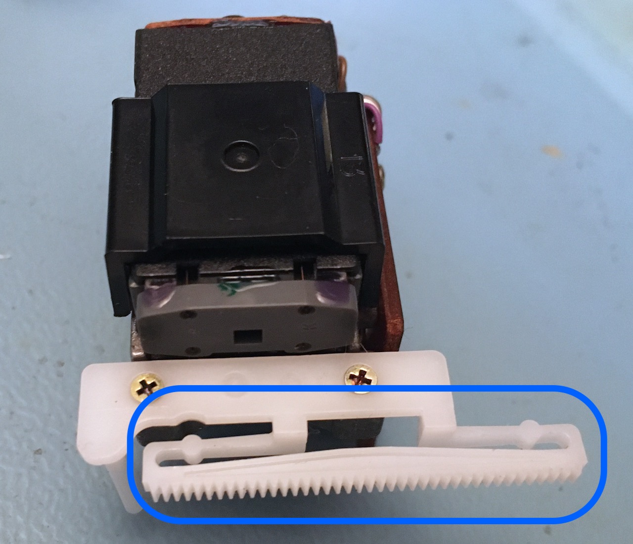

I have this cd player with issue like this:
IT starts up normally when loading it with cd. Then it reads TOC but when pressing play it spins up and laser moves step by step without playing anything. I assume laser is ok since it can read TOC very fast. I have opened it and found a loose part, see picture.
Could it be my cause to fault?
It sits in the lifting mechanism in front.
Thanks for any help in this matter.

Check my website, its look like Linn Ikemi\

Thank You for picture, it is exactly same. I have changed Laser and mecanism for laserunit. It reads TOC fast but do not read any tracks. Can not locate them.Check my website, its look like Linn Ikemi\

In my drive there is a loose round part with some black/White fields on it wich i think is some counter for lift up/down function. Do You know if i should glue it or fasten it with a double sided tape so it want move. It can not be accurate when it is loose?
You are right the black/white ring should be mounted on spindle.
On the underside of the PCB is a IR led and receiver that is used for counting / or checking is it's is still rotating.
you problem could also be a warn out tooth on laws pickup
I had to change it.

I have changed the complete pickup included laser. Now it lifts cd pickup correct ly up/down and release cd normally. It reads TOC fast an correct ly but when i press play it can not track correctly. Did you experience this before?
