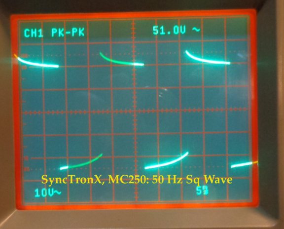

First Test w/New Electrolytics Input Board
After Max Output before clipping, square wave testing at -2dB:
Here is the sine wave at -2dB, Vp-p:
Here, Selecting Square Wave from the Leader LFG-1300s:
10kHz, Square Wave:
20kHz Square Wave:
Finally, the 50 Hz Square Wave:
Note: I do the 50 Hz square wave last as it seems to really drive the amp hard,
you can hear the whole amp start vibrating and getting hot quickly.

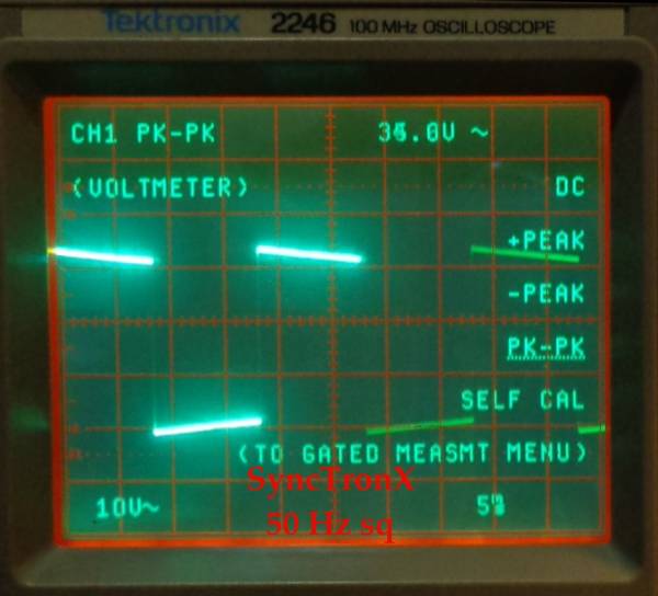

Here is the next batch of pics after changing the input boards transistors.
Capt Grog had an interesting suggestion to not use the Toshiba 2sc2240BL,
about 110 voltage rating.
because while the voltage rating on these transistors is high using a
lower voltage 50 Volt, hi gain transistor like the Fairchild SS9014 might
be a better choice. This McIntosh MC250 has a 40 volt inputs on the
B+ and -40 volt on the B-.
These are the pics and basic testing using these transistors.
I'll Start with the test gear then go through the square wave testing.
The Test Gear:
Here are the level measurements:
Then the Square waves:
Much improved 50 Hz response compared to that in post 7. Linked
below for your convenience:
Most recent is just above this 50Hz Sq Wave.
Trying to put some thumbnail images that can be expanded.
And of course adding the text below deleted the pictures. : )
Left: Before transistor change
Right: After transistor change
