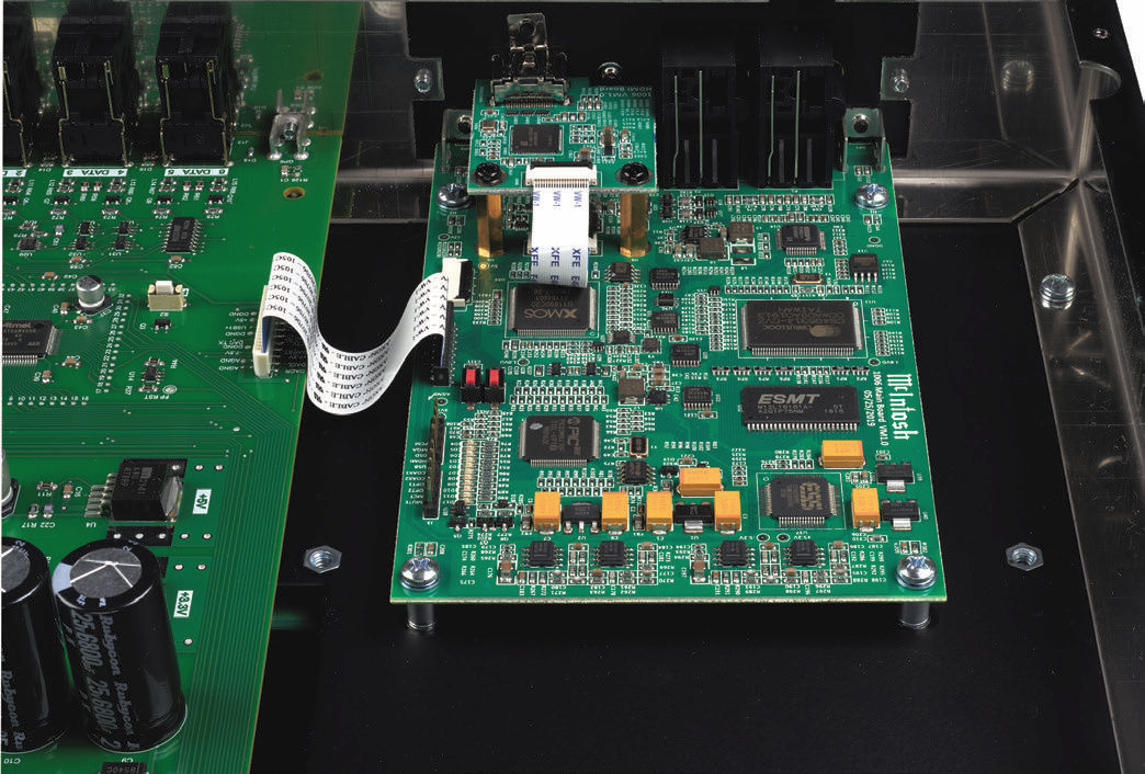

I own a McIntosh C53 Preamp, which is the one with the 'new' DA2 Digital Audio Module.
Recently, the USB port stopped working.
When I plug-in the USB cable to my computer, it is not recognized, essentially, nothing happens.

From what I can see, this module is kept in place by 4 screws on the PCB and 2 external ones, plus the connector to the main board.
In theory, replacing it should not take more than 30 mins. and it is not a difficult work to do.
It is like a plug & play, but I may be missing something, which is why I came on this forum to ask.
I did all possible tests:
- Uninstalled/re-installed the McIntosh driver
- Tried a different laptop (W10 on both) - issue persists
- Tried another USB cable, no joy
- Sound settings in W10 does not show up the McIntosh driver at all.
- Tested both Coax and Toslink ports, all working good.
- Factory reset on the C53
