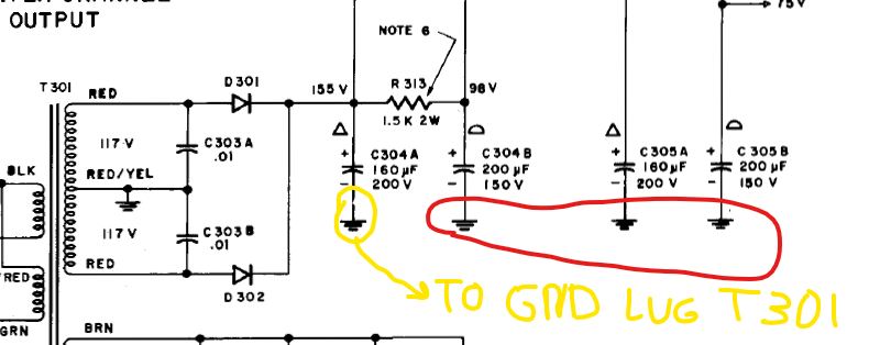

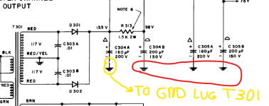

Do not place ground leads on the first stage electrolytic or star ground off that first stage ( there other ground paths elsewhere which create a loop and get you into trouble! ). Respect the same grounding scheme as the original can electrolytics as per on the schematic. First stage cap ground is attached to ground lug of center tap of power transformer. And you're all set !
